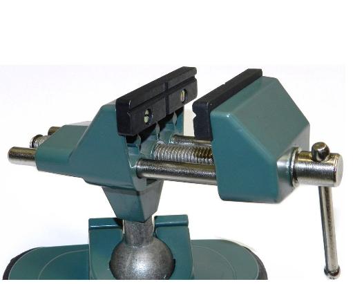

I have used a vice very similar to this one. (flat faced jaws though)
More than enough power for aluminum.
Just make sure the hole is a tight fit.

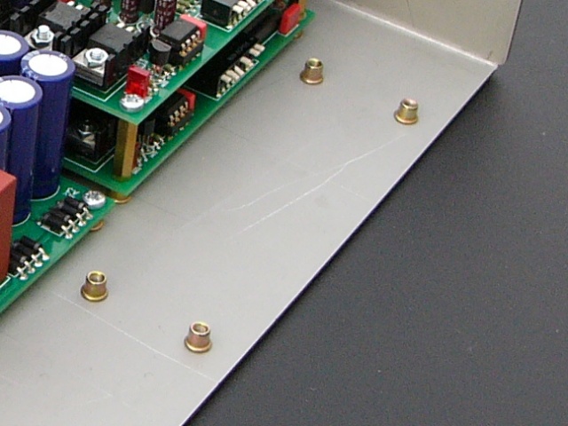

In the first pic it almost seems like the material is 1/8" thick and you could tap it, but I don't know the scale so maybe it's only 1/32" thick and we are looking at a #4 screw!

Another type of thing that does this job is a nutsert (aka rivnut). They're rived in with a tool similar to a pop-riveter.

I use this type, in aluminum because it's enough for my needs, but they are available in steel and even stainless steel for special purposes.
More than I want to pay though 😉
And yes, they are applied in a similar way to Pop rivets, although the steel one need a stronger machine.
There's even a pneumatic and an hydraulic version for Industrial use .
But for everyday use the pop hand riveter type is fine (and inexpensive).
