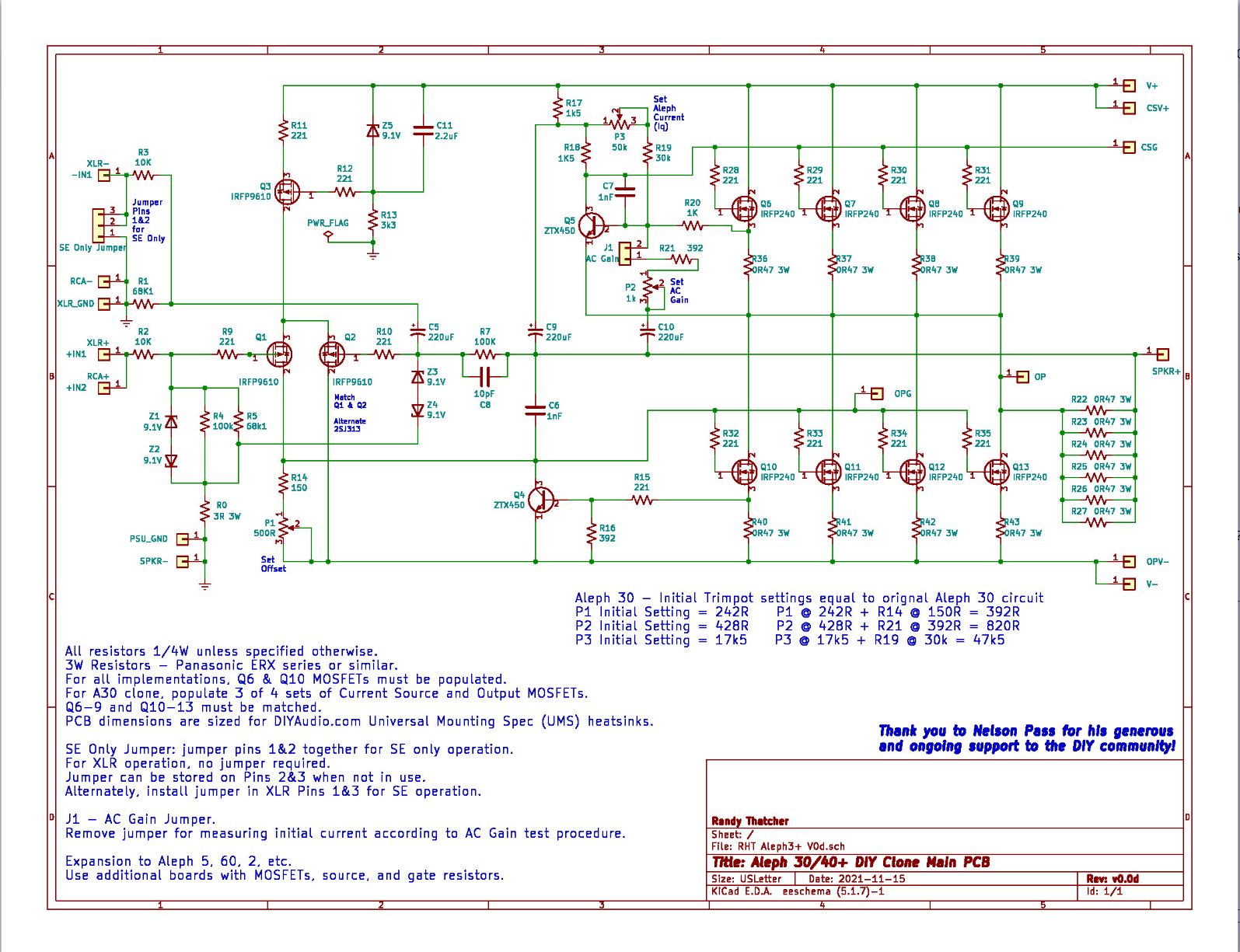

There's high power Aleph J... see attached.
Or, (the antichrist in me saying...) a class D amplifier... maybe...?
Or, one of the Pass Labs amplifiers (make sure your private health fund covers hernia surgery)
