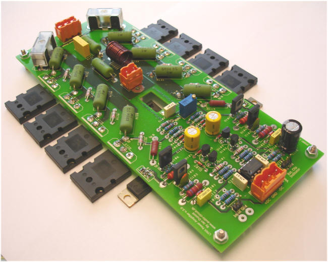

I had bulid your LYNX 3 amp...
If I use 8 transistor output 5200/1943..with rail voltages +/-65 V 15 Amp traffo..at bias 300mv...
The sound are quite good and so powerfull..but I hear liltle hum at the ouput..no loud but its can be heard at night...
What should I do to remove the hum..? I isolated the main ground form the input with 10/1W R...but still ican hear the hum..
If I Put 8 Tr for the ouput..how many watts output for thats ?.. How I can measure for that..
Thanks...Dodi

Lets take the main issue first: Hum
It would a be a big help, if you can make a drawing of the way you have connected the wires (Supply and Ground) to the PCB.
Hum can be caused by the Power Supply, the Ground wiring and by bad shielding..... Lots of possibillities......
Is your layout the same as the original, or have you made a different layout ?
Edit: Added photo of the original layout

Dear Mr. Jan.
Thanks to repply my email..
I had put away all the wires on the input..and only on min capasitor ground conected to ground via R10Ohm to chasis..
I conected the ground input on the PCB to power supply ground for the opamp and driver near them...because if I dont conenct them the DC Voltages are raise at the output stages...
According on your PCB layout, that ground input are not connected to anywhere..accept the feedback capasitor....
There's mistake on the layout..? I just download form the website in Grebers files...
Thank for your attention...
Dodi

It works now.... have you noticed my remark on Jens' pcb layout about the feedback? Your feedback point is a bit unsymmetrial, are you aware of that? You have also a couple of disturbing elements on the way to R120. A microscopic(?) improvement would be to "sniff" the feedback signal just before the inductor and have a clean trace directly to R120 with nothing else connected.
