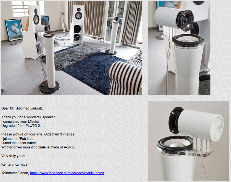

Maybe here is the best one from SL's LX gallery?
Some builders have simply used a larger diameter bass pipe and adjusted the bass EQ to suit, avoiding the coupler. Seems to work fine, but the pipes will cost more and you need to know what you're up to with the DSP.
There's no doubt that the acoustically functional aspects of all of Siegfried's designs might be a hard sell for some "domestic managers" 😀, but a review of the LXmini's builders' gallery demonstrates some creativity.
LXmini_Gallery
emphasis mine
I rather like the smooth lines on this take by a Chinese builder
LXmini_Gallery
Siegfried,
This is my second set of LX Minis, unfortunately the originals (see the 5th pix up from the bottom of the gallery as “Ray”) were not accepted very well by the domestic manager. The new ones retain the original design within a 7 inch square housing finished in Tasmanian Blackwood to match other furniture . No measurable difference in response was found between the circular and square construction, the box edges and corners do not seem to have any effect.
Thanks again Siegfried for a great design !
Regards, Ray Australia
emphasis mine
I think the "look" of Siegfried's design is one of its strong points!! Your friends won't have anything like it!
I like the chinese model.
