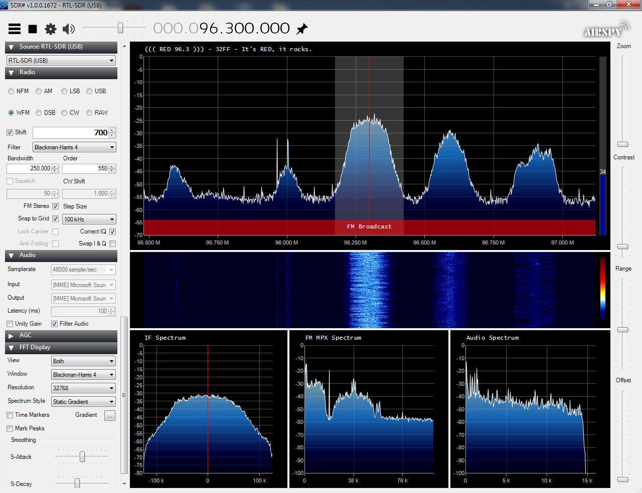

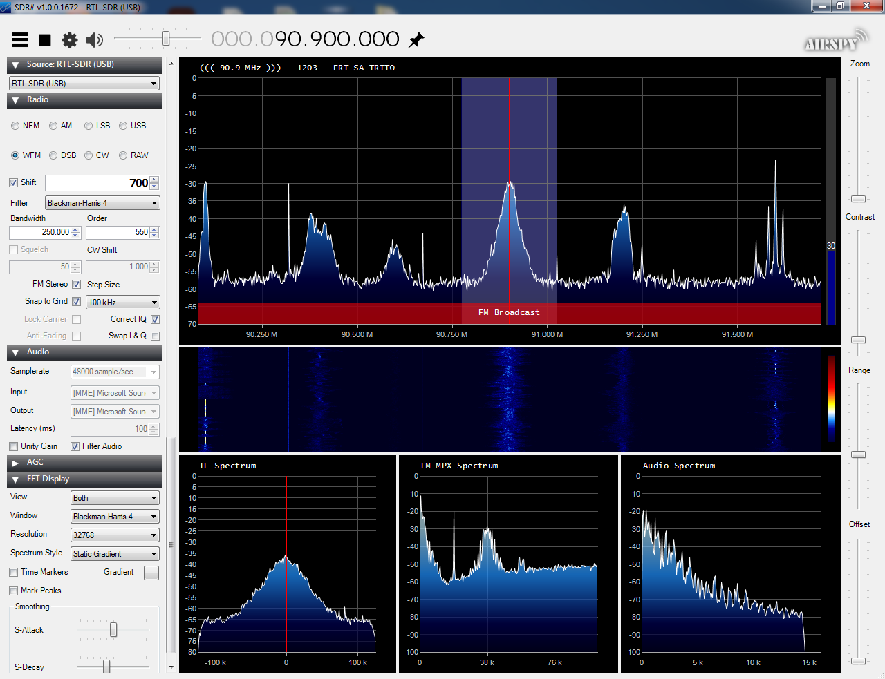

If you want to verify the root of the problem, you may get a 20-30 $ SDR dongle, set up the free software on your PC and watch the RF and I.F. spectrum and the spillage due to overmodulation of the offending commercial station.
PS. The dongle may finally perform better than your T-1 in your place as an FM (not only) tuner due to it's SW fully adjustable RF and IF bandwidth
