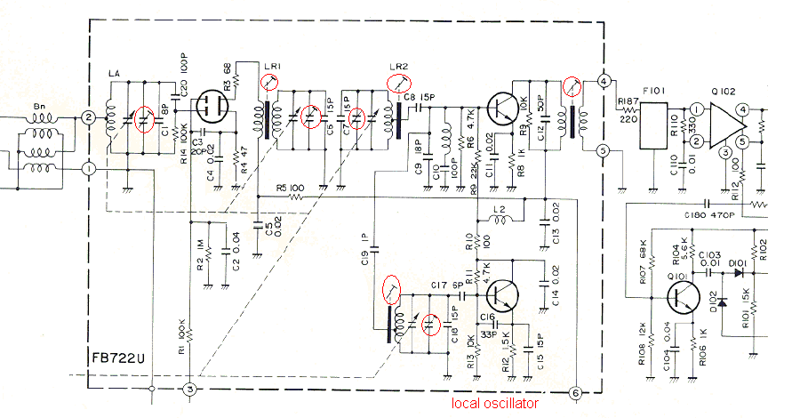

The information you provided was very helpful. I do have access to an oscilloscope and an RF sweep generator. However, my oscilloscope only has a bandwidth of 20MHz. Is this sufficient to undertake the alignment procedure for the FM stages? (alignment of the AM stages is not very important for me as there are no AM broadcasts anymore in Malaysia). Thank you.

With a 20MHz scope it can see the Intermediate Frequency
but not the local oscillator that work from 98 to 118 MHz
Luxman have a multi stage front-end, really excellent but more
difficult to align.
The Intermediate Frequency don't need any alignment because
the filters are ceramics.
Also check the trimmer on IC LA1230 LA3350
This tuner needs to Align for centering the frequency.
bye

The front end is the easy part. Getting the discriminator and distortion adjustments right are key. Do those first, then you go after pointer registration and tracking, IF and then finally touch up the sensitivity.
The front end is the easy part unless you mess with the LO. It's rarely out by much, if at all.
-Chris
