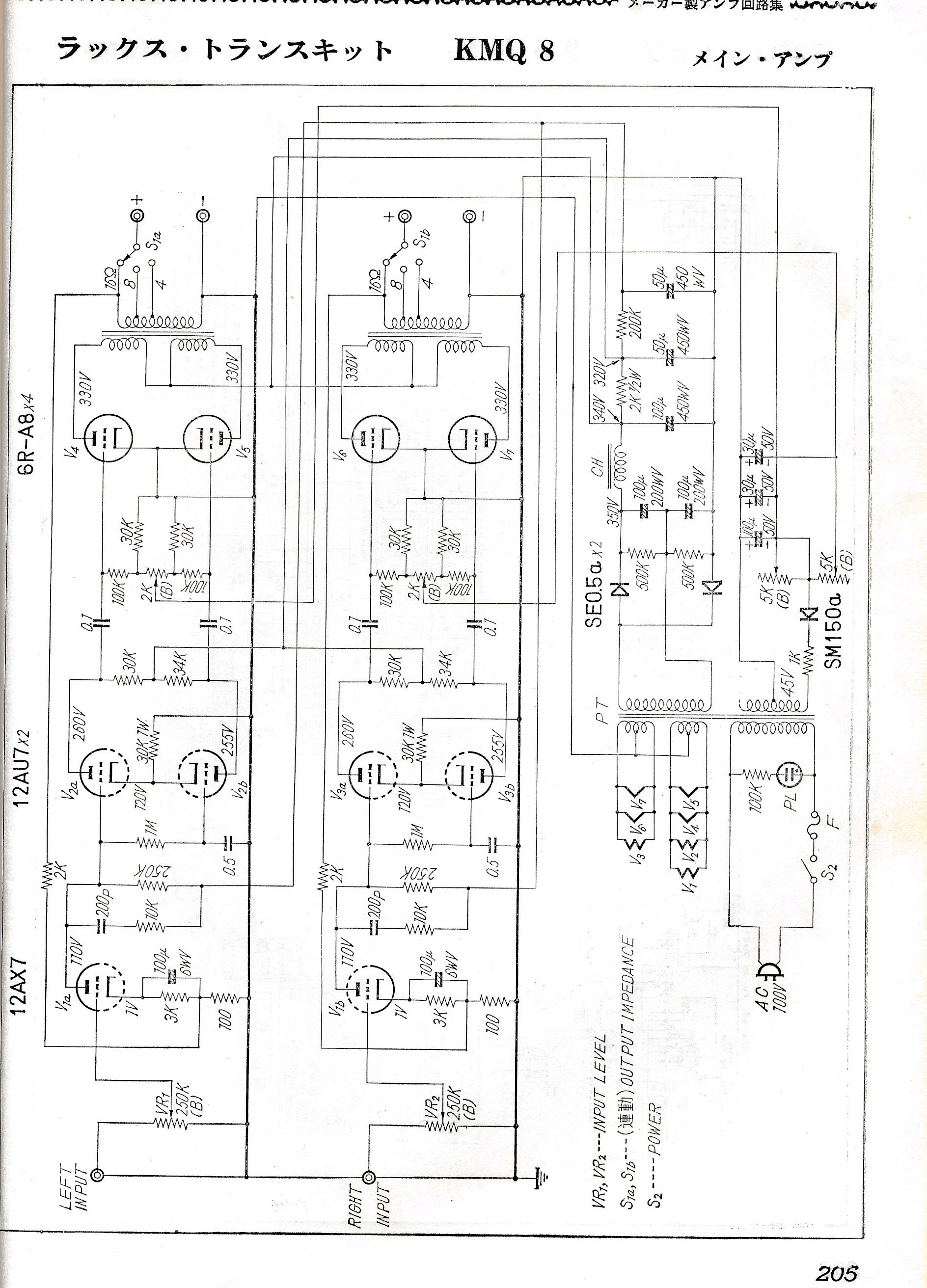

According to the Lux catalog, the recommeded tubes are 6CA7, KT88, 2A3 and 300B, but unless you want to punch holes in the chassis and add a suitable filament transformer for them, you are probably better off sticking with the original Lux A2500 design, and change the output tubes to EL84/6BQ5 so you can still use the novel sockets.
I have two of these OY-15-5k in a 1967~ homebuilt stereo amp. I'm considering my options. What build would work with them?
As I see it, the schematic of the home built amp should be Lux Transformer kit KMQ 8.
If you can get 4 of 6R-A8, you can use also the power transformer and the choke too.
