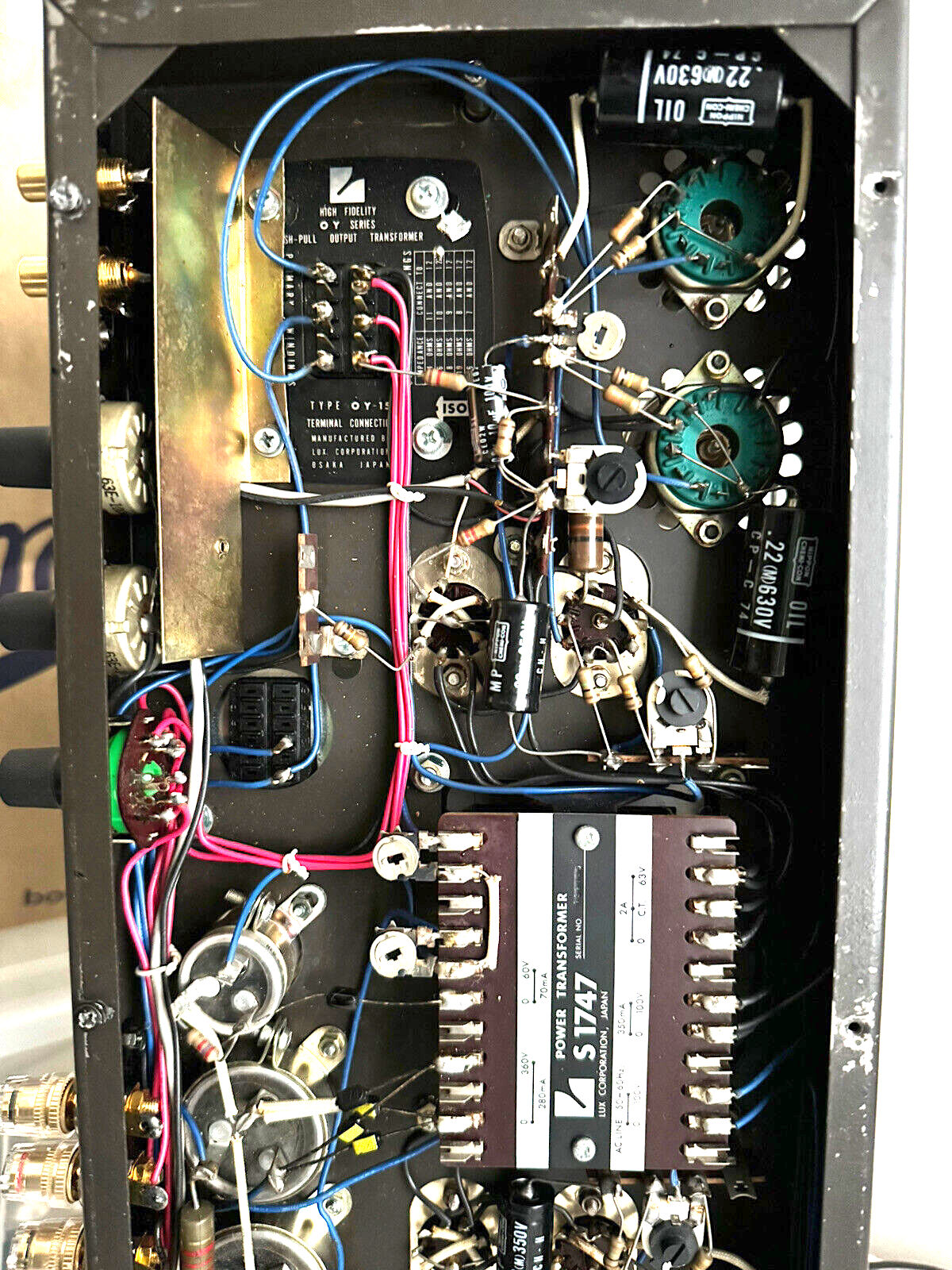

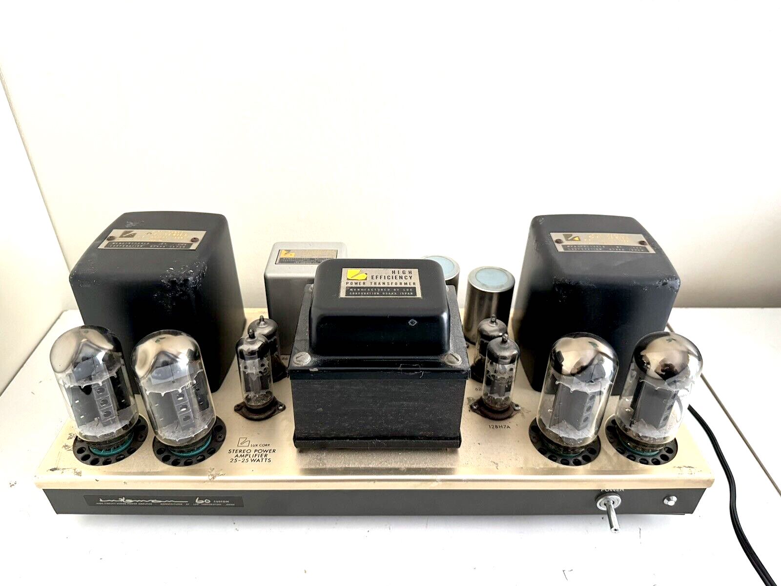

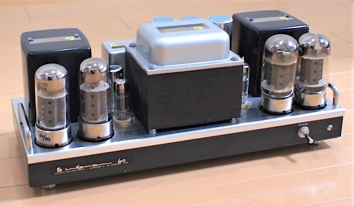

There are currently at least 24 of these Luxman MQ-60 PP amps on ebay, the reason being that they use uber rare and expensive 50v heater Matsushita output tubes which are no longer a practical proposition. The transformers are excellent and this amp is crying out for a swap of the output tubes. There is already one modified for 6550 tubes and the EL34 would be another choice since the OPTs are 5K. The 6550 modded amp uses a bigger A3700 mains transformer which doesn't really fit, and my choice would be an outboard power supply with one 115/230V step-down transformer for the 100V Japanese voltage and one 6.3V transformer for the output tubes. This would use a 4 pin umbilical e.g. a Speakon connector or something like that. A fairly simple modification, and in my view worth it for the quality of the original transformers.

I was looking at these a couple of years ago but I wasn't into push pull amps at that time. Do the opt tubes test strong in these? Are the driver tubes easily available? Can one enjoy the original using a step down/isolation transformer before hacking it away? I was looking at some schematics it shows 80mA/channel on the output triodes but I am not sure if these have a OPT with ultralinear tap or not. The schematics are a mishmash of redrawn schematics. Would you keep the triode configuration or going for pentode? These have grounded cathode and -50V for the bias, any mods needed there?There are currently at least 24 of these Luxman MQ-60 PP amps on ebay, the reason being that they use uber rare and expensive 50v heater Matsushita output tubes which are no longer a practical proposition. The transformers are excellent and this amp is crying out for a swap of the output tubes. There is already one modified for 6550 tubes and the EL34 would be another choice since the OPTs are 5K. The 6550 modded amp uses a bigger A3700 mains transformer which doesn't really fit, and my choice would be an outboard power supply with one 115/230V step-down transformer for the 100V Japanese voltage and one 6.3V transformer for the output tubes. This would use a 4 pin umbilical e.g. a Speakon connector or something like that. A fairly simple modification, and in my view worth it for the quality of the original transformers.

There would be no reason to have a UL tap. I found a small schem. in an old AK thread, post #1.: https://audiokarma.org/forums/index...or-schematic-service-manual-etc.688474/page-2 The OY15-5 OPT doesn't show a UL connection.I was looking at some schematics it shows 80mA/channel on the output triodes but I am not sure if these have a OPT with ultralinear tap or not.
