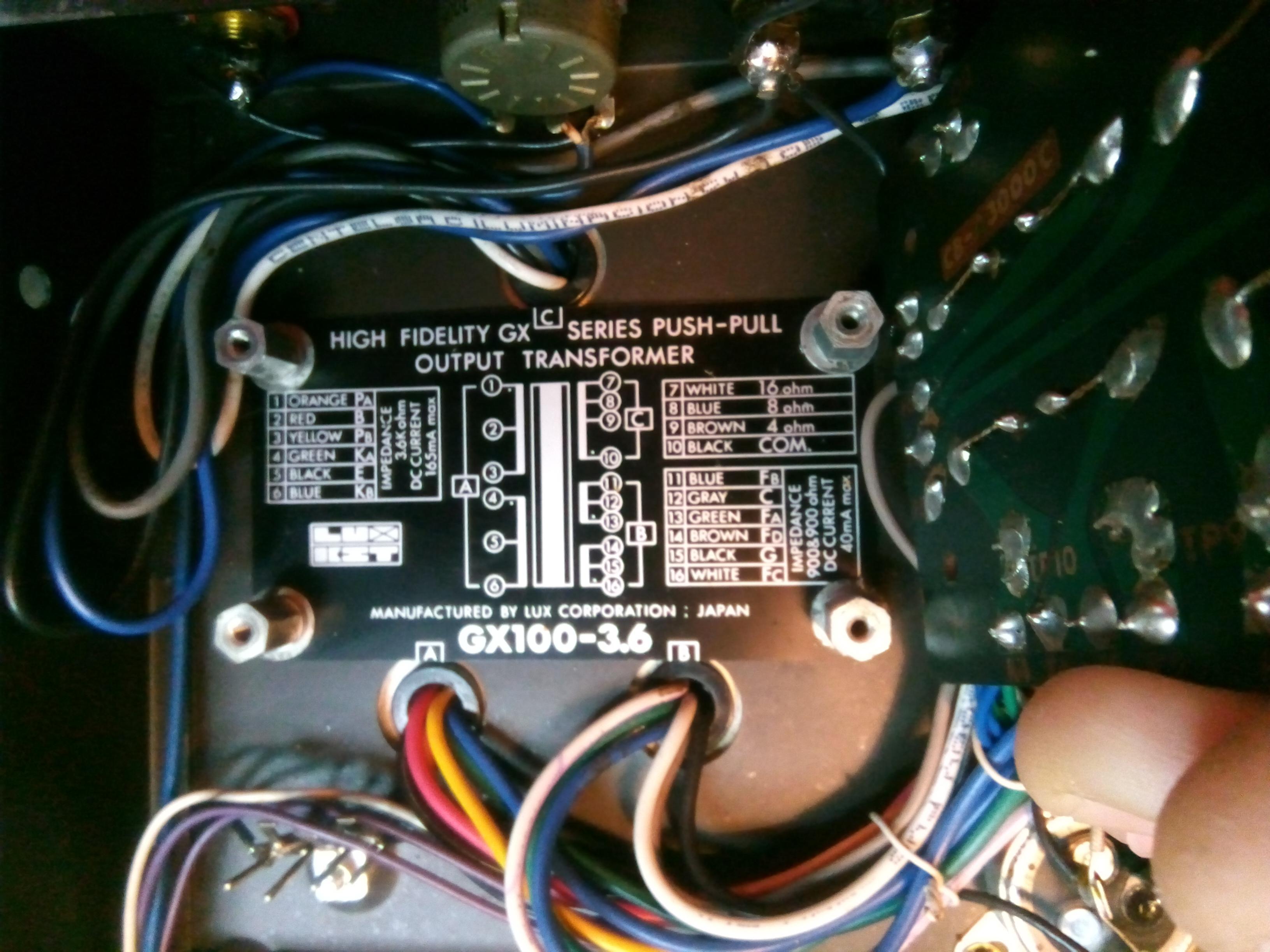

I have problem with measuring the wires.
Since I have the working amp for comparison that is exactly the same model, it seems that the OTs have slightly different pinouts. On the picture you can see the pinout which checks out for the working amp, but the transformer on the "not working" amp has one wire in section "B" that is white with a pink stripe, and another one that is ether grey or brown (color fainted due to age or temperature, so it's hard to determine). I guess I have to pull every wire on this section on both amps to measure them correctly. Connected in the circuit they give different values, while all components measure the same.
