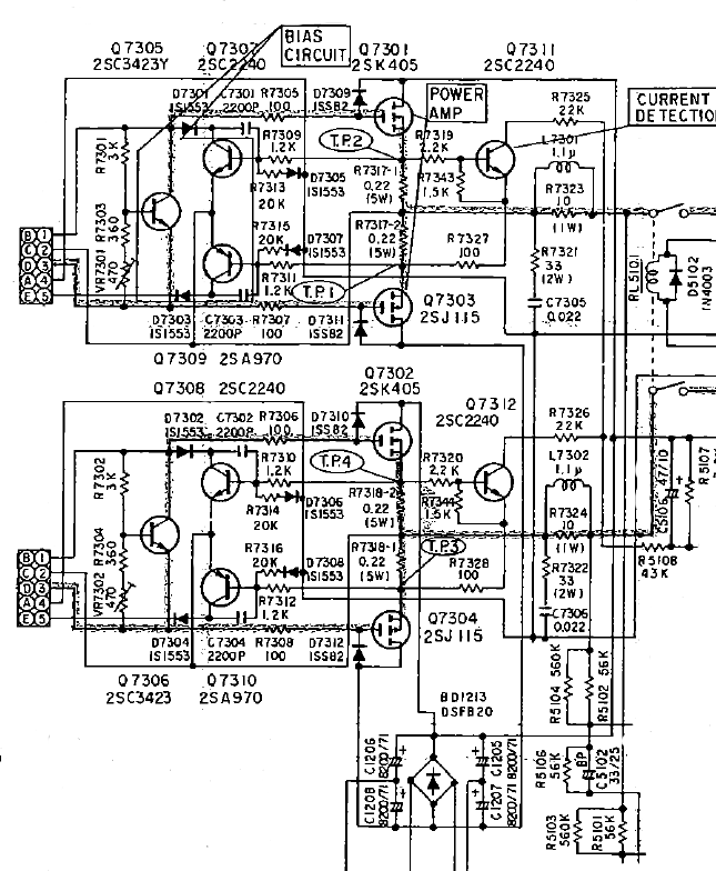

1) I have bought an LV-105u recently, left output stage is burned out. I haven't had much time to look into it and repair the damage.
2) The Luxman LV-105u is a great amp, however the output stage MOSFET transistors are known to burn quite easily if driven too hard. IMHO they are operated too near their SOA.
3) Original transistors are 2SK405/2SJ115, which can be found but you really have to look hard on the net.
4) AFAIK nearest replacements are 2SK1529/2SJ200, and 2SK1530/2SJ201.
5) I have read about people using 2SK1058/2SJ162.
6) AFAIK IRFP9240 and IRFP240 are not really recommended.
Here is an extract from the schematics showing the output stage.
I am preparing a small quantity order for 2SK1529/2SJ200 devices, if you need two pairs or more just PM me.

IRFP swap.
Hi guys !
I've given a few thoughts on this matter, these are my suggestions:
- the original output devices are similar to standard hexfets.
- the most important difference is the amount of gate voltage needed
to "open" the device, also called as Vgs(th) or Vgs(off).
- 2sk405/2sj115 Vgs(th)= 0.8V to 2.8V
- IRFP240/9240 Vgs(th)= 2V to 4V
- pinout is the same.
- just drop in the IRFP's and try to adjust the quiescent current to nominal value (100 mA ?)
- if you cannot set the needed amount, try to replace R7301/7302 with
4.7kOhm resistor, this will extend the range of Vgs setting.
I hope you dont fry anything !
Good luck !

K1529 and J200 can be used as replacements with no further modification. K1530 and J201 will also work fine and offer even better robustness. Although the input capacitance of these parts is somewhat higher, the higher gm makes them about the same to drive as the originals. I have tried both these options and given the higher Idmax of the K1530/J201, would use them as the preferred option.
From the IRF cam, the ideal pair to use would be an IRFP340 and IRFP9240, but an IRFP240 will work as well. The bias generator will have to be modified due to (much) higher treshold voltages. Unlike the K/J parts, with a treshold between 1 and 1.5V, the IRFP parts will be closer to 4V each for the 100mA standing current. The original trimmer will not have enough range. R7301/7302 have to be replaced by higher values, try 5.6k.
I have not tried the K1058/J162 combo, and would not do it based on the lower maximum ID of these parts. This might work in the smaller LV103, though. The problem here is that the pinout is different, the source resistors have to be removed and the bias arrangement modified to a single series pot (all other parts must be removed/shorted as necessary).

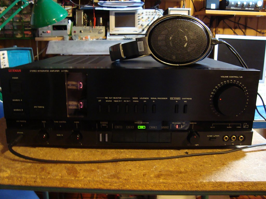

First hand repair results
OK
I have taken action on this one. Late last night or early morning this day I had success 🙂
I choosed Ilimzn suggestions on Fet's. IRFP340/IRFP9240. They are easy to get, and fairly cheap from my normal supplyers. The mentioned SK and SJ parts are harder to come by. It looks You have to buy them from E-bay.
I changed the R7302 resistor in the bias circuit on the right channel, where I did this job. Lord Winter's suggestion, 4.7k ohm, was right on spot.
My Fet's opened between 3.4V and -3.05V respectively.
There was some burned resitors around the old Fet's Current sensor circuit and also the 0.22 ohm R7318 resistor was broken. Checked power on the Driver board and also checked the driver boards last tranny, the buffer after the tube Q7110, and then I tried.... Easy on the variac, lowest Bias ..... poff, both Fet's shorted on all legs 🙄 I didn't had a chance to measure or understand what happend. After another round, measuring resistors, unsolder and measuring transistors around the endstage I found one broken gate resistor. The 100 ohm R7308. Next time around I had my success 🙂 Those gate resistors are very important.
I will listen some more today and maybe measure eventual difference between the two different endstages. I will probably change the old stage as well, so that they become the same. But for the moment I will relax and just listen to this fine amplifier. It's silent when it should and the sound is very good.😛
I have a very low hiss on left channel which sound as a thermionic tube phenomenon. It comes and goes. I may have to buy new tubes later on.
Anyhow this comment is for you all wondering if it's possible to use something else then the original Fet's. I have done it and it works very well so far
And also, you do not need to change every transistor on the driver board or anywhere else. You just need to change the faulty parts. 😉
And another thing. Change the large electrolyth after the filament rectifier for the tubes. It's probably dry and has no uF value at all, as in the state my cap was.

After cleaning behind the upper faceplate and where the Tube glows.
After two days of running and checking contacts and tubes this baby now works perfekt. No hiss and hum, just music. The tubes measures excellent and even on the tubetester AVO MKIII.
