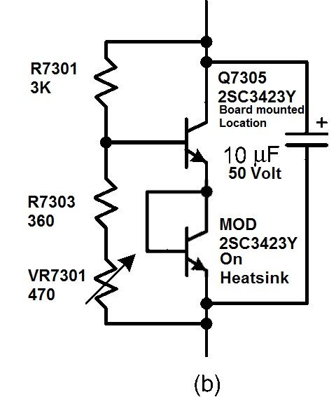

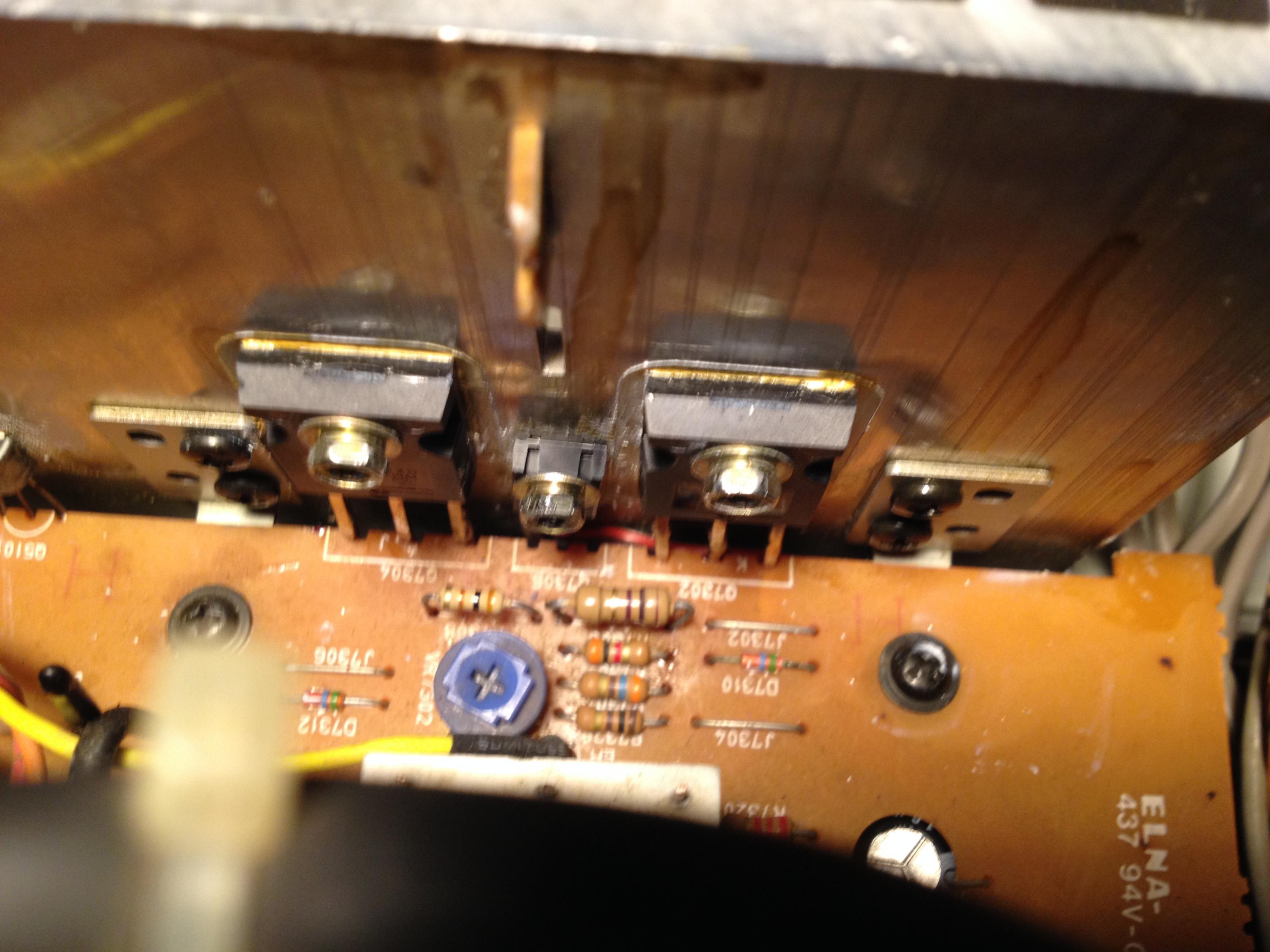

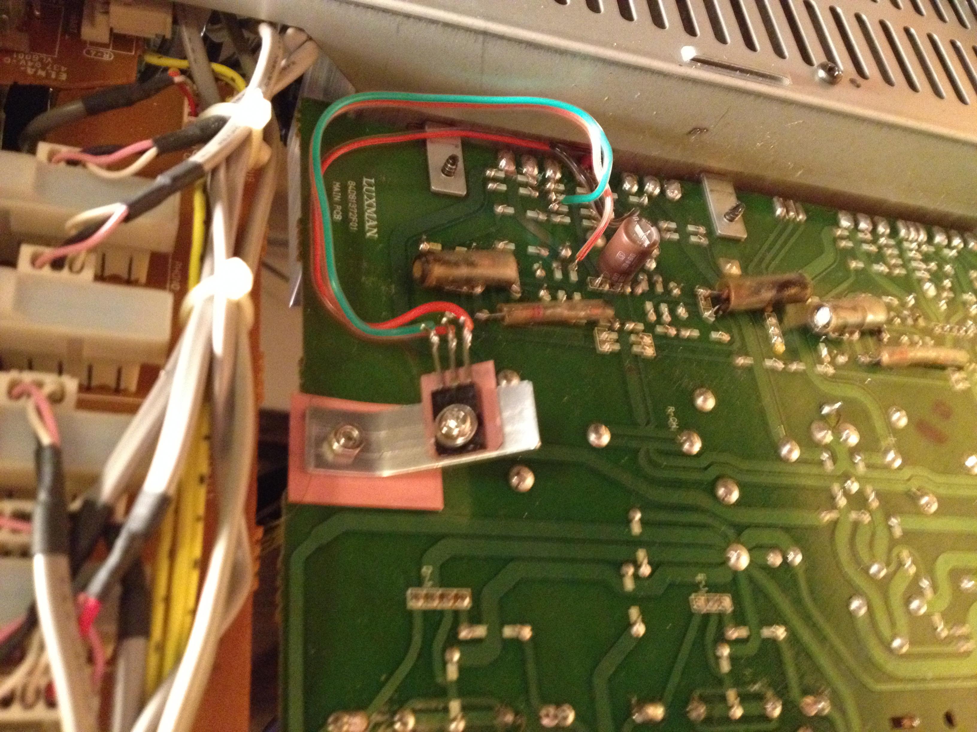

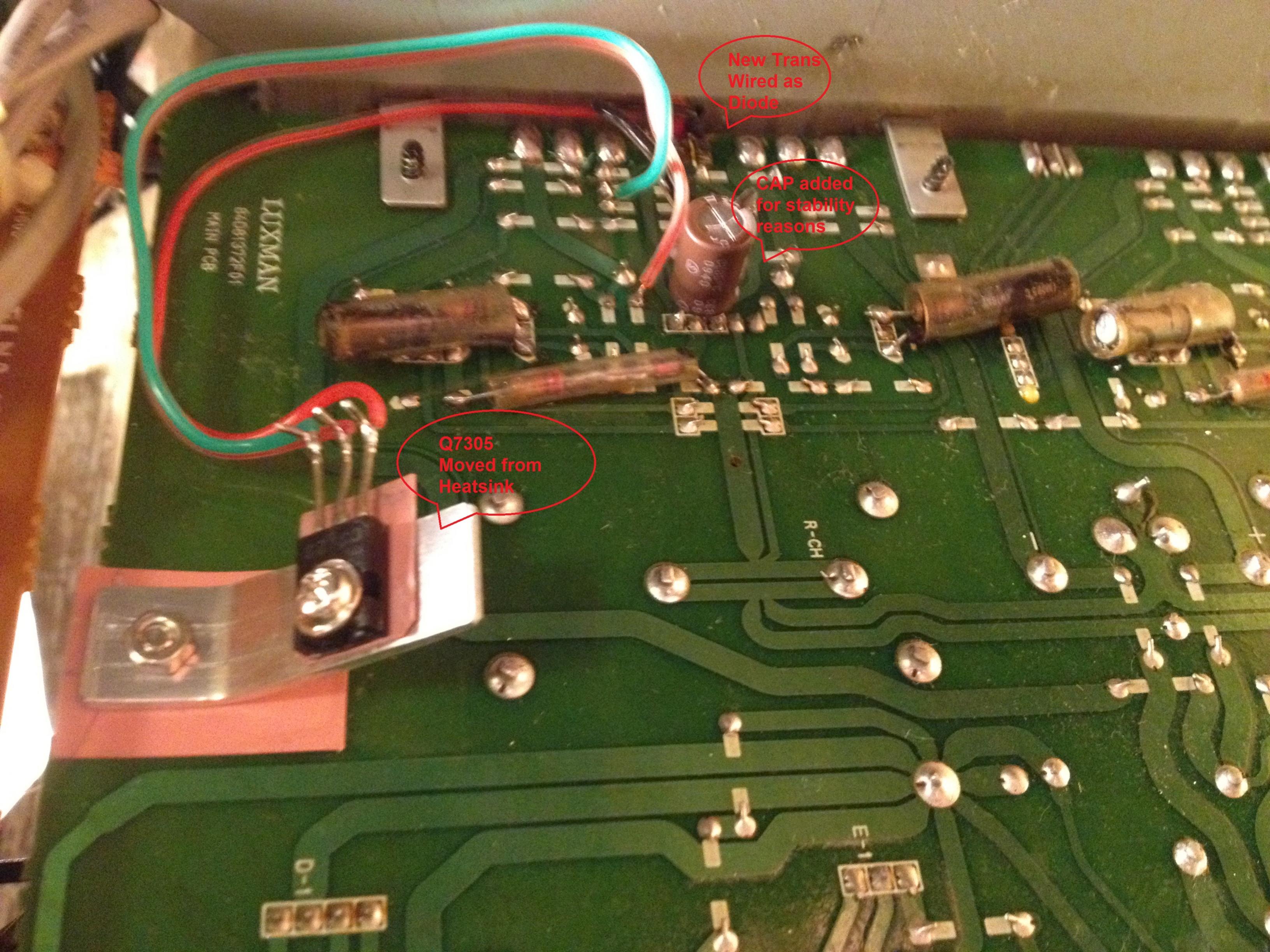

Hi everyone, I just wanted to chime in with my two cents worth and tell ya about the excellent results that I have had replacing the outputs in this fine amp. For anyone having trouble sourcing parts it is possible to replace the outputs with IRFP340PBF and IRFP9240PBF these MOSFET's are inexpensive, readily available from Newark Element 14 and have higher general ratings than the originals and will be more robust. There is an issue with the "bias spreader circuit" that makes it overcompensate with these devices. There is a solution. Some modifications are required but not hard if you have some patience and electronics ability you can perform these mods with great success and the bias circuit will track much better and will be more stable.
You must add a second transistor wired as a thermal diode that gets attached to the heatsink in the stock location. It is wired in series with the original trans and effectively cuts the bias compensation by 50%. The existing trans is relocated to a bracket under the Main PCB which now only compensates for ambient temperature. The modified circuit now tracks almost identical with the original circuit.
You also must add a 10 mfd 50 volt cap across the spreader for stability purposes. I feel that this cap should have always been there as it reduces circuit distortion just below clipping. I have had the amp running wide open on 8ohm dummy load for more than a day and it is completely stable. Sounds pretty good on music also when hooked up to my McLarrens. I have been tracking the two channels closely as the left channel is still all original.
Please See the images below.....
I hope that someone will find this helpful. I feel the effort to keep this great amp running was worth it.
All my best to all of you......🙂

Hi Stevieg123,
I would like to point out a couple of safety items so that you don't suffer disaster like I did the first time around when I let the smoke out.
If you are using the exact parts that I did, make sure that R7301 is 3K. I also replaced all the resistors with Dale's at 1watt they were exactly the same size as the originals and shouldn't drift as they age. The other thing I did was use a 150 watt light bulb in series with the ac line when I first bring it up. This will give you safety as you will know as soon as the amp starts to pull excessive amounts of current and switch the bulb full on (Normally it will glow gently until you start to raise the volume or get the bias current too high). I would also start with the bias pot all the way to the counter clockwise position.
Do you have a service manual? If you don't, the correct way to measure the bias is across the two outer pins on the top of the three pin emitter resistors. The factory setting is 65mv.
Sorry that this is so long winded but, the final thing that I would like to mention is that before you start the mod, hook up your meter to the emitter resistor and get accustomed to how the bias comes on. It doesn't come on instantly like a traditional transistor amp and is effected by the dc offset of the driver tubes. You will see the bias voltage swing negative first and the climb to the positive and normal state. If your bias is set too high in the beginning to something like 200mv it will smoke the gates. This is also why the the 3K resistor is important. Also check the other resistors in the bias circuit to make sure someone hasn't subbed them wrong during a previous repair.
Ok, enough talk....
Good luck with the project and I hope that you enjoy the end result as much as I have. My best friend liked it so much that he bought one and wants it upgraded like mine.
Kelly
Ok, enough talk....
Kelly
Hi Kelly,
Sorry it's taken me so long to get back in here to update my progress, one thing after another, you know Murphys' Law...anyway, got all my semis in and got after it, changed out fets and added series 'diode' to bias circuit as well as 10 uf caps, made some brackets to hold original C3423's in the new position, under board like you did, pop riveted them to board and started to do ch to ch tests with 'curve tracer' device. I mainly use it to check semis but works nice locating a problem by comparing two points in one channel, then looking at the same two points in the other channel can quickly check for a bridged solder joint, or a missed soldering point. If the traces aren't exactly the same channel to channel, I know something isn't right. She looked all good so pluged her into VARIAC and switched both on, slowly raised a.c. input to Lux, current meter only twitching slightly as I increased juice, slowly, slowly, then...click, the wonderful sound of the speaker relay snapping on. Yeah!!! Did quick bias check to make sure that was good, and hooked up loads and sinewave to inputs and bingo, two great perfect looking 1kHz sinewaves on scope. Warmed up and slowly adjusted bias to get her to a place I felt it safe to unhook one leg of one of the 10ufs I added to see if I could see what you were seeing near clipping. Damn! That was really some ugly garbage/distortion just prior to clip, just like you'd seen I'd bet, before putting the caps in. Other channel still fine but one without cap...ugly ugly ugly stuff.
Put a few pix in to show work. WILL TRY TO FIGURE OUT HOW TO UPLOAD PIX SOON
Both channels biased up just fine, took a lot of small adjustments over a good 45 minutes to get it stable as heatsink takes quite awhile to reach operating temp. It (bias) does seem to track the heat better than with the original fet's now. This morning it came up with 65 and 66 mv across bias test points cold, so I could not be any happier with the way she's acting so far. I'm giving her a slow warm up now to take all the full power measurements in a bit so will get back with them and try to figure out uploading pix and talk soon. Thanks for all your advise and help,
Steve
Steve
