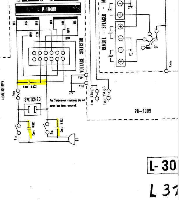

Hello,
Maybe the problem is caused by the capacitors I selected for the AC section. I replaced this 3 capacitors. I chose 22nF poliester caps 250v AC. Maybe I chose a wrong type for this duty.

any body looked at teh schematic before placing an answer ?

Did you allready (just for testing) bridge the two sections of the mains power switch?
If the switch is sparking internally before closing properly, you will have that noise.
there is some AKAI and Sanyo Plus 55 with this issue that also appears in a specific type of switch ...From statistics point of view L31 is NOT one of them ...After all though you never know ...
