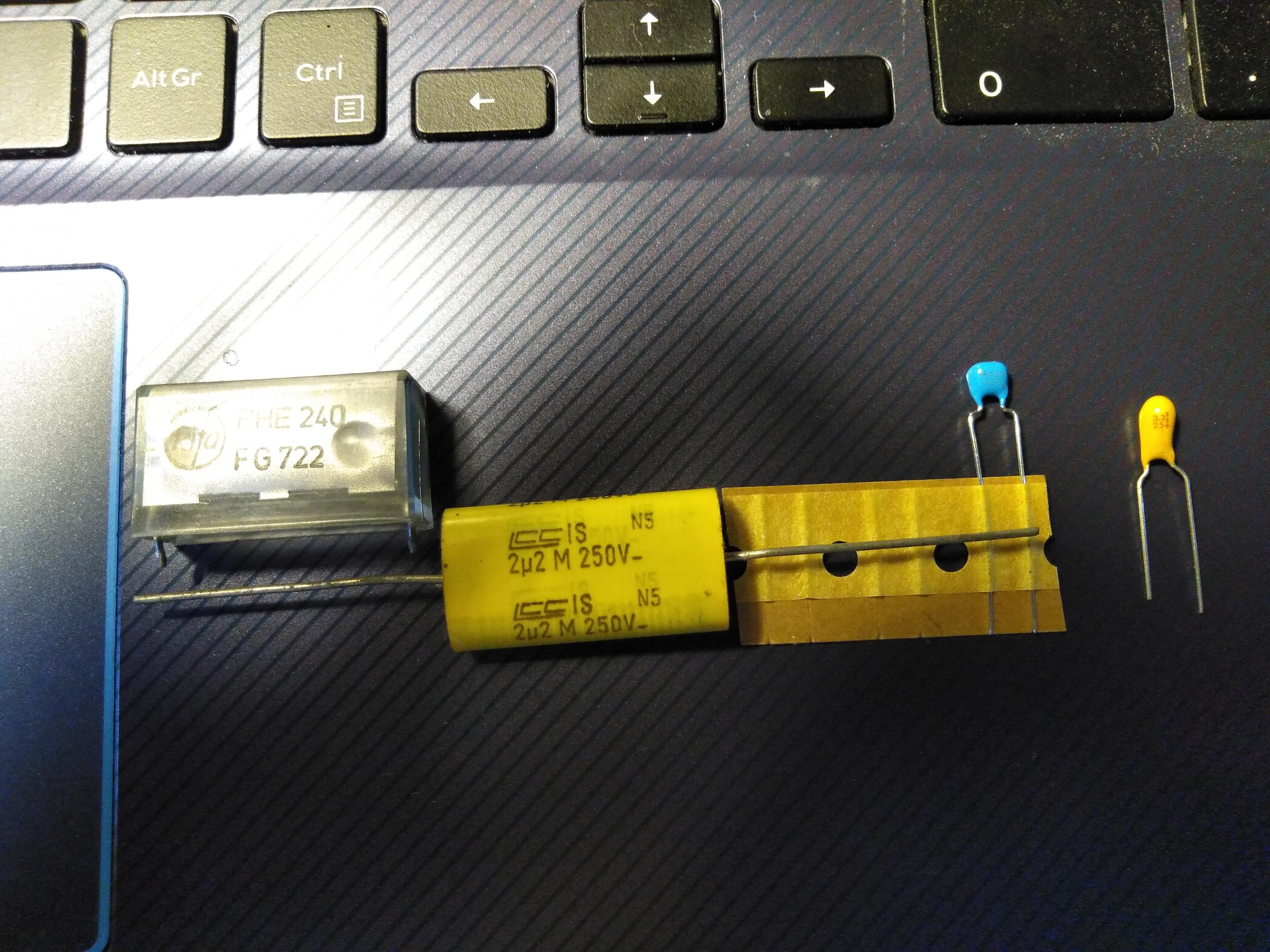

Hello
I dug deeper in my components drawer and found the caps in the attached picture.
From left to right :
Wima which will be difficult to use given the arrangement of the printed circuit board
Another film cap. Looks to me to be the same technology as the Wima because they share the same size. But easier to use.
The little Murata I spoke about. It is a ceramic cap. I bought them a while ago to repair a mechanically damaged device. Was sold by multiple of ten...
A little tantalum also sold by multiple of ten.
And not in the picture, the aluminum electrolytic Luxman used in the first place.
I've enough of each to replace all the 3.3µF caps in the circuit.
Which one would e the best to use ?
Thanks a lot for your help !

I've found the Farnell reference on the invoice. Enclosed is the datasheet.
What do you think ?
