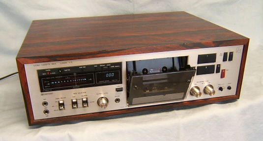

I would like to ask for some help or some idea . I have a Luxman K-15 3 head cassette tape deck , really nice condition .
Unfortunately I can't us it because after 15-20 seconds it shut done .It doesn't matter which function I use , play , FF, rewind always does the same .
Every function it works , I can listen music for 20 second .

The first thing to do is get the service manual. I think there is some sort of sensor that detect rotation of the take-up spindle. When it stops rotating, it turns the deck off. Probably something wrong with the sensor or the circuit.

We tested the sensor with a help of a technician , the sensor is OK .
But We just realised the digital counter is not counting at all .It doesnt matter if play ,rew, or FF mode I turn it after 20sec it turns of but the counter still shows 000 .

These is the cassette deck I'm searching for some help or the service manual or any info were I can find the service manual .
Any idea why the counter does not star , the technician told me that why after 20 sec, the motor shut of .
