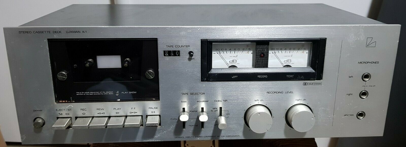

My Luxman K-1 has developed an annoying fault, it still plays fine, at normal levels, but it isn't picking up the line level input signal properly. I thought it wasn't even registering the fact there was any input until I tried cranking the rec level dials all the way up, and then the VU meters started moving. so something has gone wrong with the electronics, anyone got any idea how to start trying to diagnose the problem?

I think Mooly has probably figured it out, or I hope so, as that sounds a simple fix. Here's a picture of my unit, as you can see, there are no front panel switches to set wrong, I recorded a tape last night and it was fine, but this morning, not working. I'll take the top of and take some pics, then hopefully cleaning those big input switches will do the trick, I have some WD40 handy.

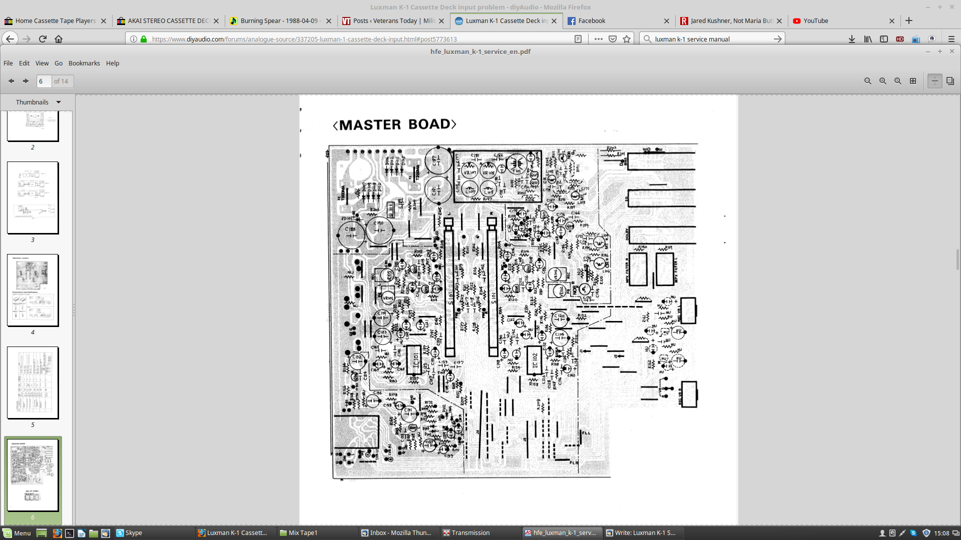

I have the service manual, if I interpret it right, there are two of those switches on the master board, labelled S101.
Those are the ones. Initially just give them both a good whizz to and fro by hand and see if it has any effect. Beware that doing that while playing WILL almost certainly switch the unit to record and erase what is on the tape.

Well I've finally managed to get the screws out and remove the bottom of the case to access the PCB. The switches are easily accessible. I've ordered a can of switch cleaner, will give them a good dose when it arrives and report back.

Finally got around to cleaning the switches - flooding them with switch cleaner than moving them back and forth a lot, did the two rec level pots at the same time as they could be crackly. This fixed the problem and the deck is working great again. I've made 25 recordings with it since cleaning and they all sound great.
