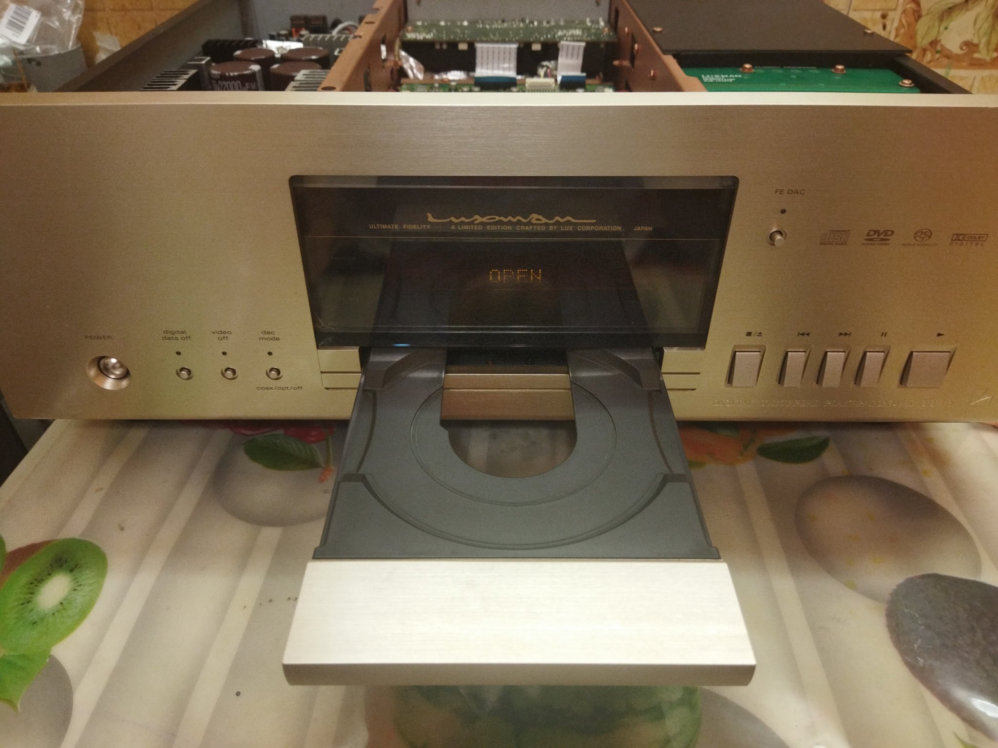

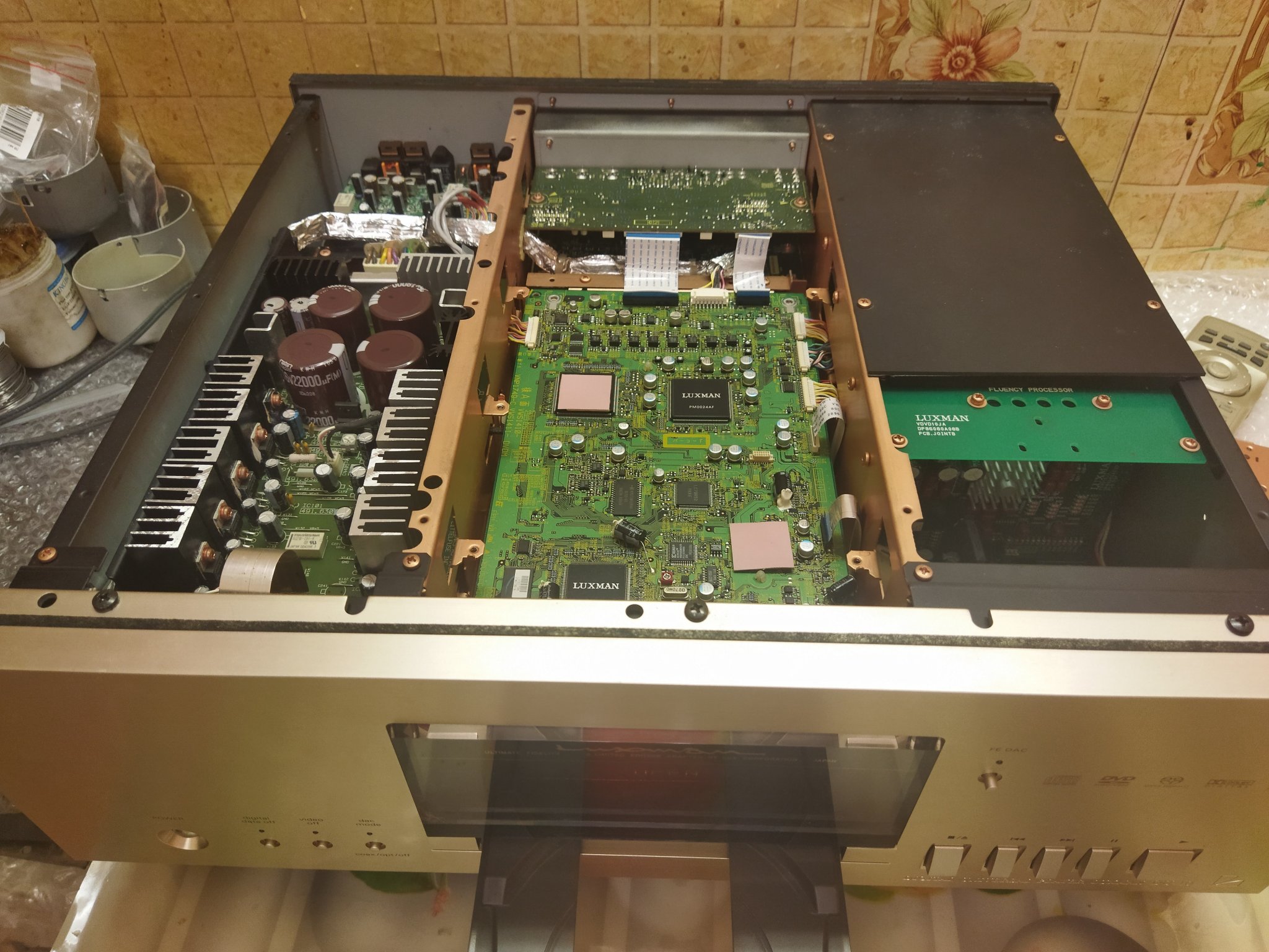

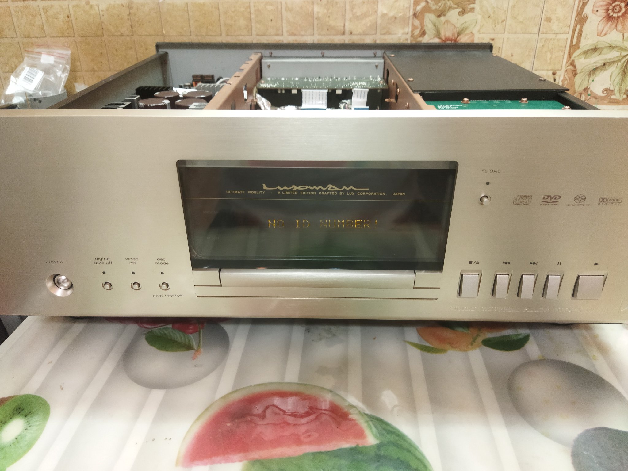

Good evening, dear colleagues. I started to restore and repair the luxman du 10 super audio player. initially it did not turn on at all, I had to repair the power supply and control circuit... the device is working, but the message "no ID number" is constantly coming out. maybe someone has encountered this situation, please tell me.

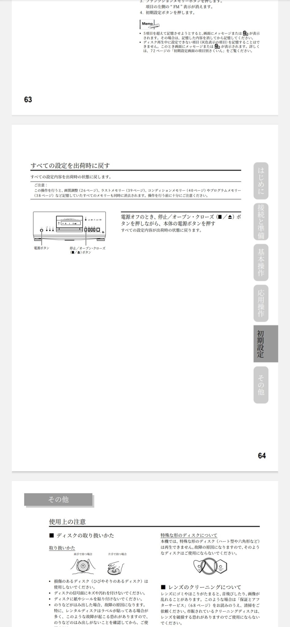

unfortunately, it says here about the switch of inputs and outputs for acoustics and that you can link four devices to one remote control using different IDs, but unfortunately this does not help in my version.... I believe that there is still a problem somewhere in the device itself, in the management, because it does not even reset to factory settings...
