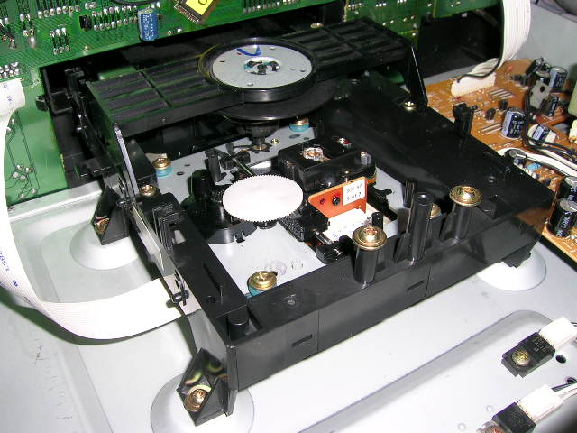

I have one non-working Luxman D225 CD Player, which have dead laser. Can anyone help me with info about optical pick-up type on this model? Schematic will be even better.

I don't have camera, but i will try to find a friend who has and i will post a picture.

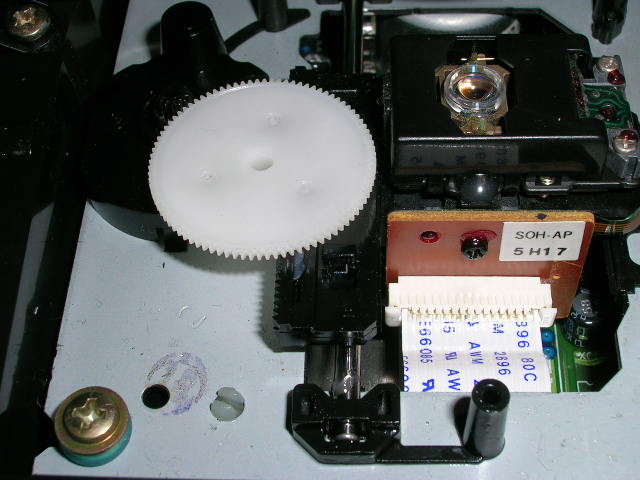

Hi Chico,
The part number on the laser head is SOH-AP. Make sure the cable is good (or be careful when changing the head).

I'm not shure at all, but everiting seems to work ok, logic, motors, sensor switches...
This is Samsung head i gess, not fammiliar with it.
I didn't have schematic, so it's hard to examine everiting and to be 100% shure.

When the disc is in, spindle motor rotates the disc and laser tries to read it without success for a couple of minutes. With empty tray there is red light from the laser head, and if disk is not inserted, “no disk” command on display shows up. So, I guess logic is ok, but laser is too weak to read the disc content properly.

What I want you to do is put the probe on the RF test point. Settings are 0.5uS / div (or as high as you can go) and 0.5V/div. use a 10:1 probe. You will see an RF waveform called an "eye pattern". What you normally would do is adjust the focus bias for the highest amplitude and sharpest pattern. Do not move any control very much. The next adjustments can get you into trouble easily. They are tracking offset and E-F balance. Do not touch without the service manual.
Send a picture of the RF test point before you do anything. It can be hard to catch. Also, try to measure (DC volts, 2-10 V scale) across a normally 22 R resistor near the RF amp that goes to the flat cable for the pickup head. Calculate the current. Compare to the Iop figure normally printed on the head. I use a laser power meter for quick checks, but they are expensive and I don't know what the expected value is for that head.
