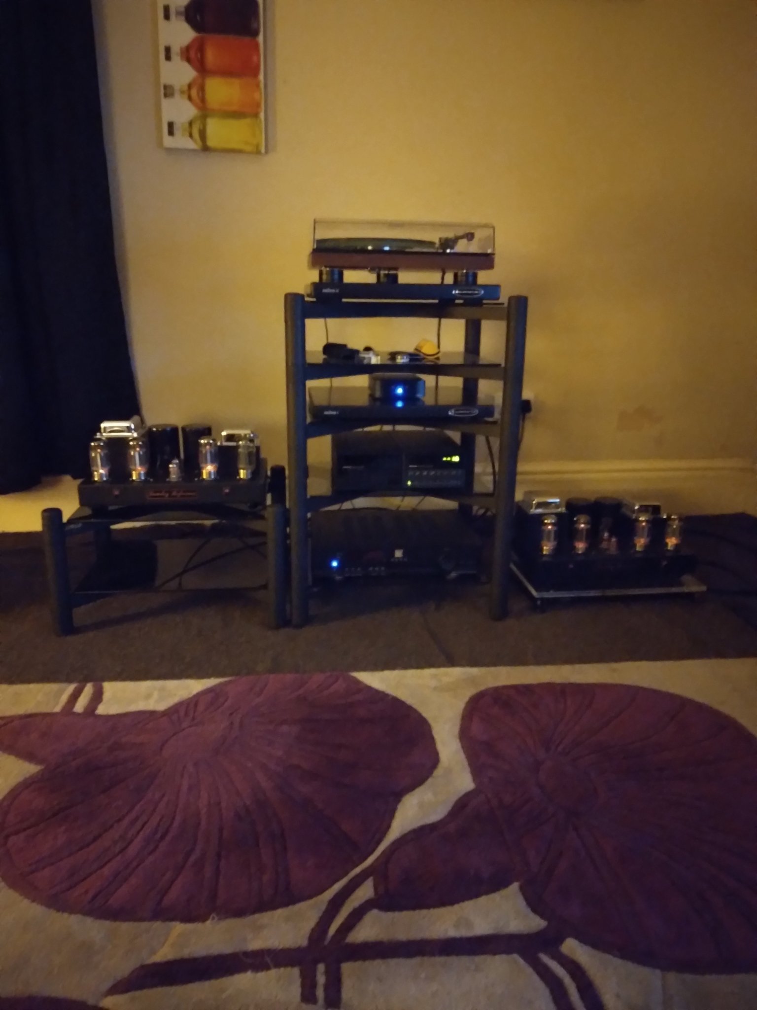

I have just recently bought a pair of Lumley Reference 120 Monobloc amps.
They are working fine but I have no manual or any other information about them.

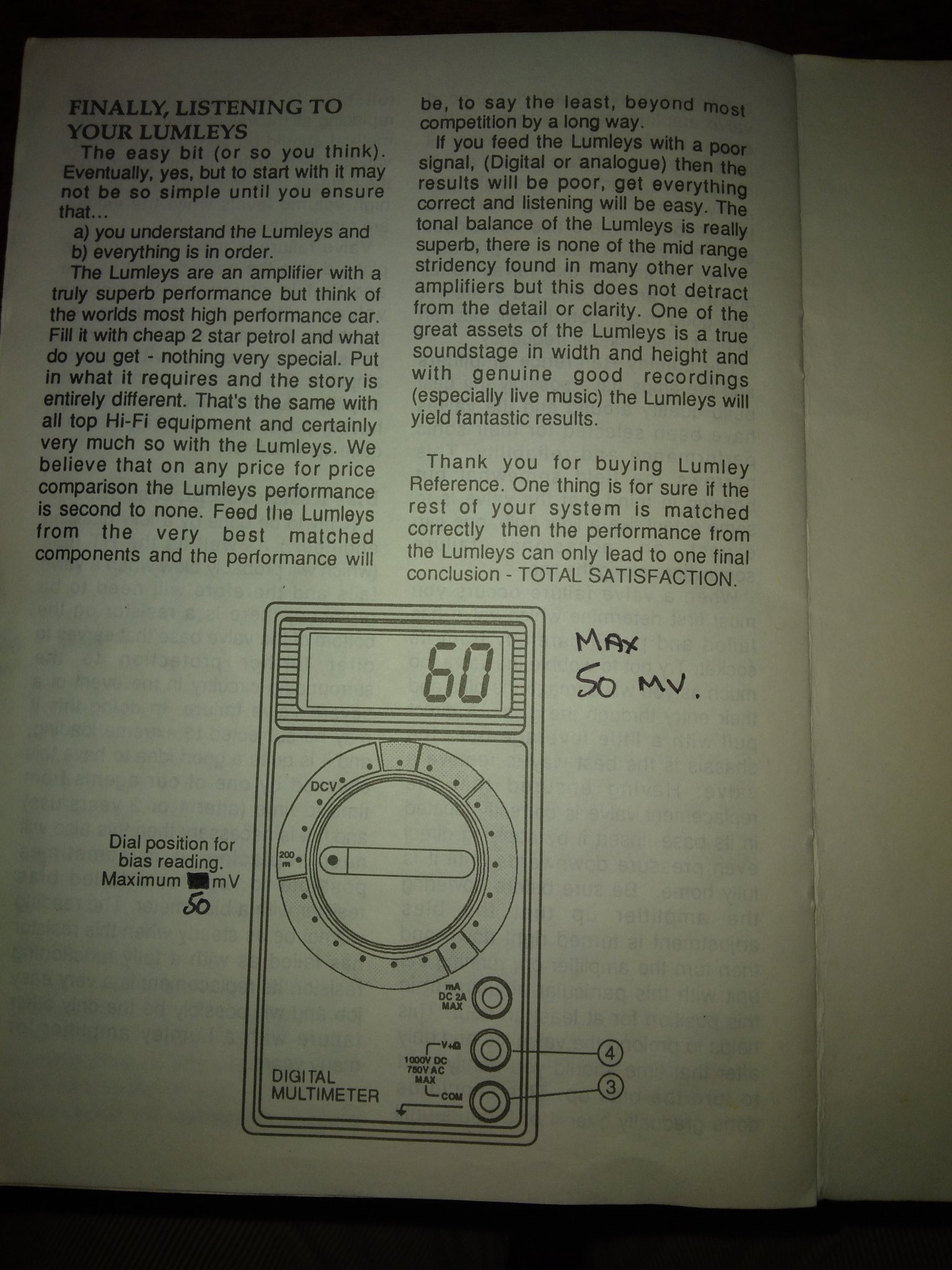

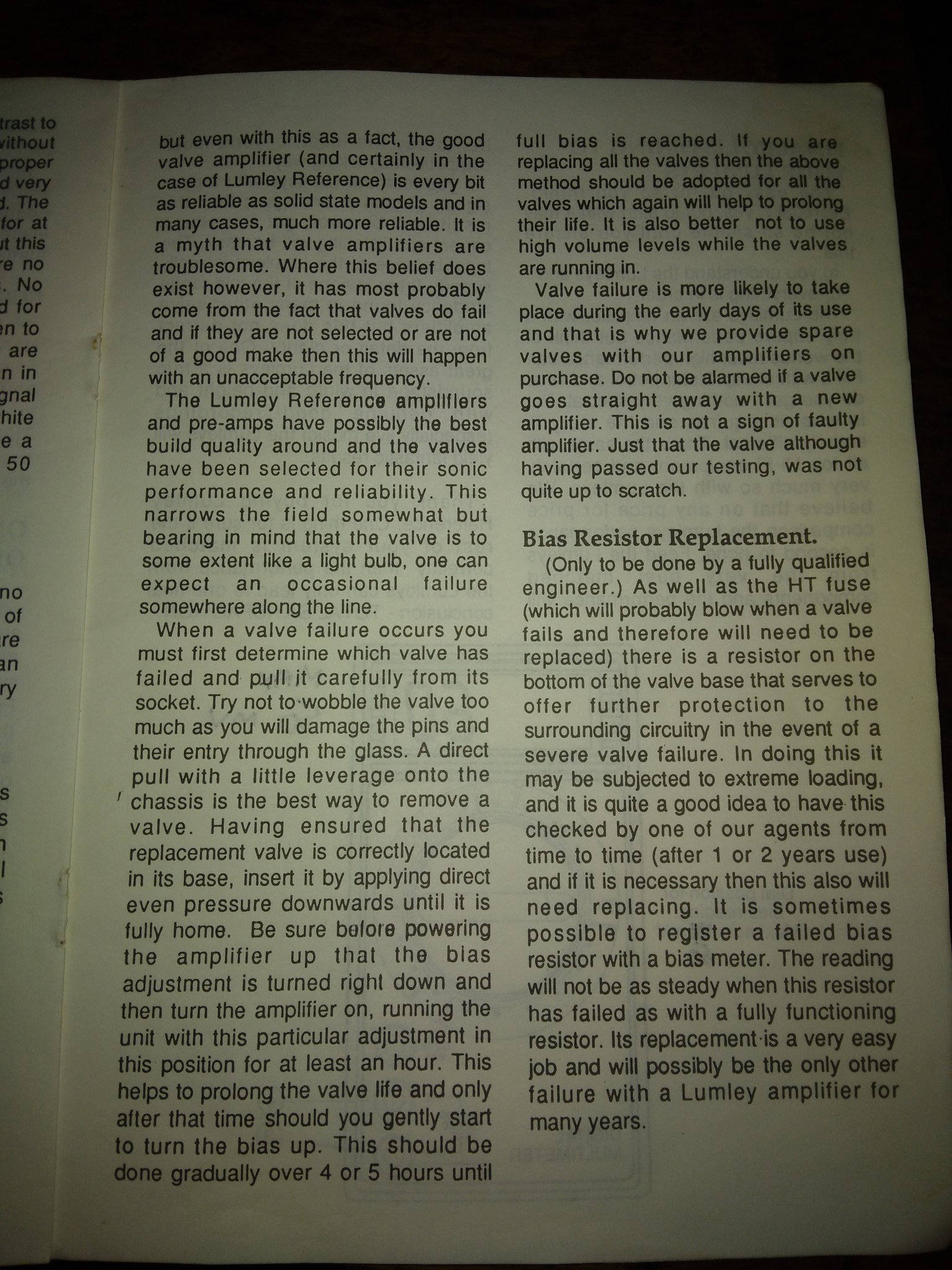

I have the manual for the ref 120 ... I also have the amps
Here are photos of the pages if these help.. the Bias setting is for the mk1 50mv . But I usually set to 70% of that 35mv with good valves. Mk 2 amps ' I believe is 37mv.
