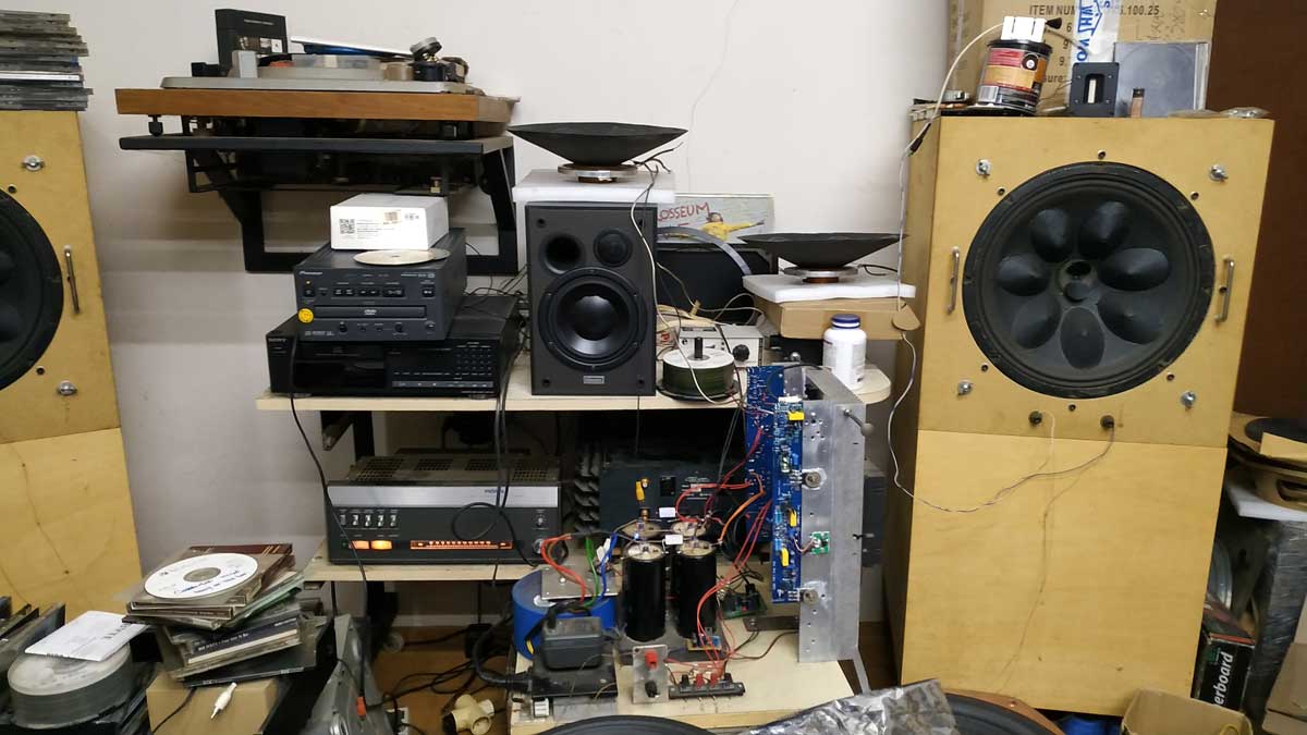

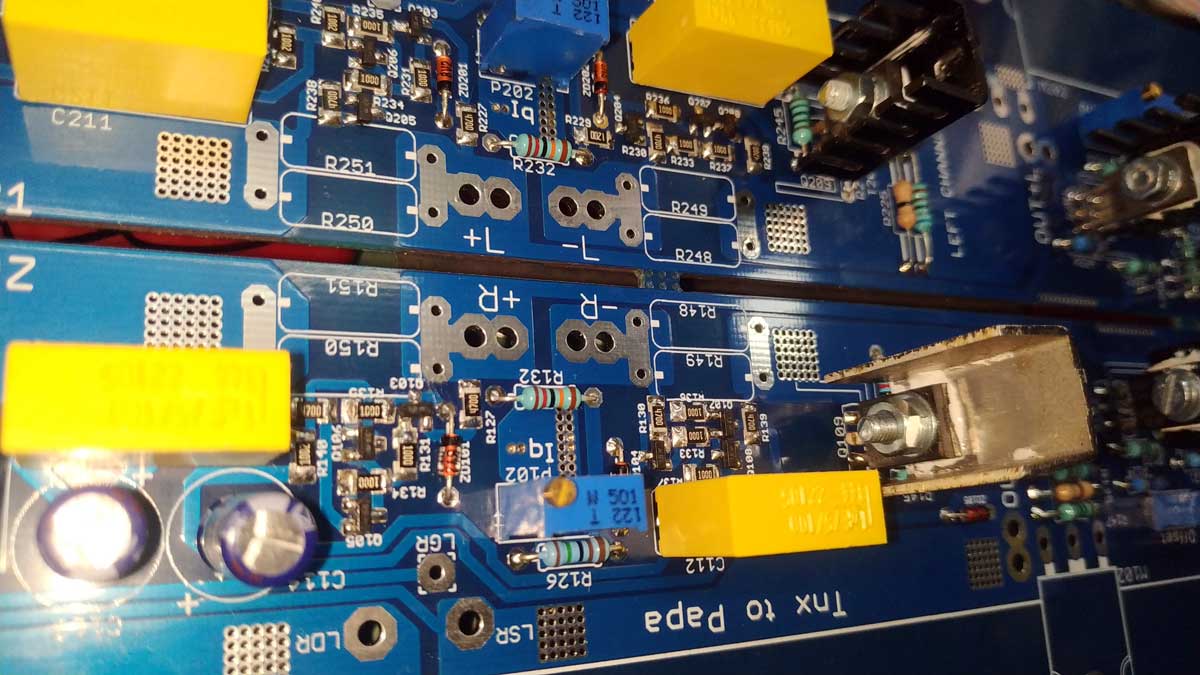

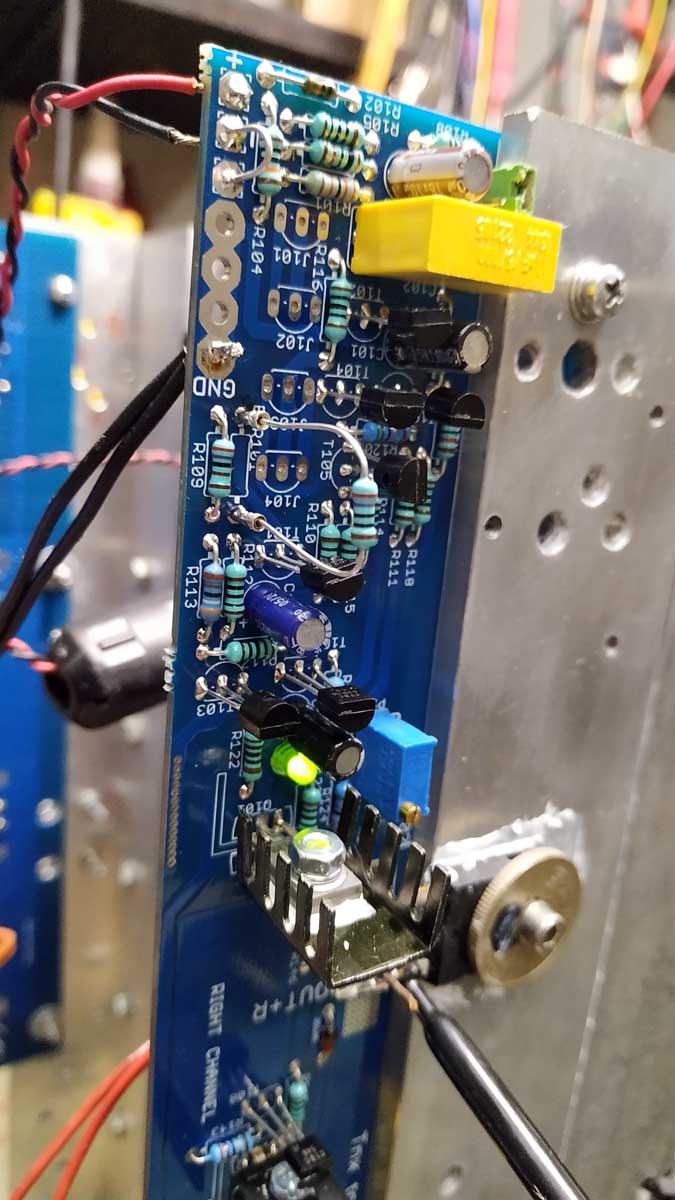

Second installment of Plethora of Pinjatas series of amps

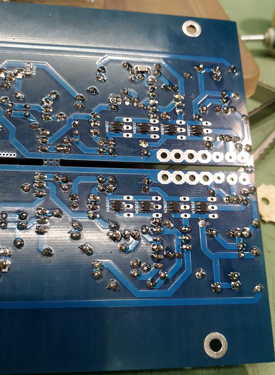

Started with this
Started with this
which is

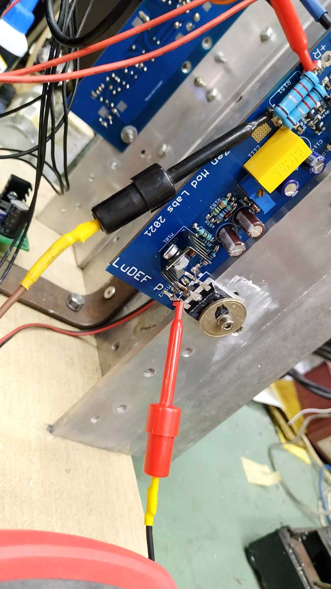

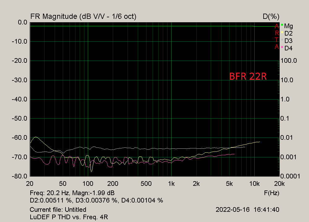

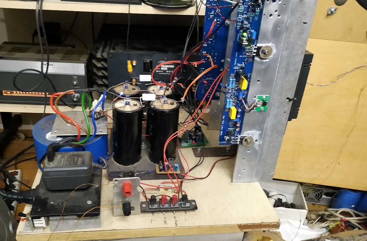

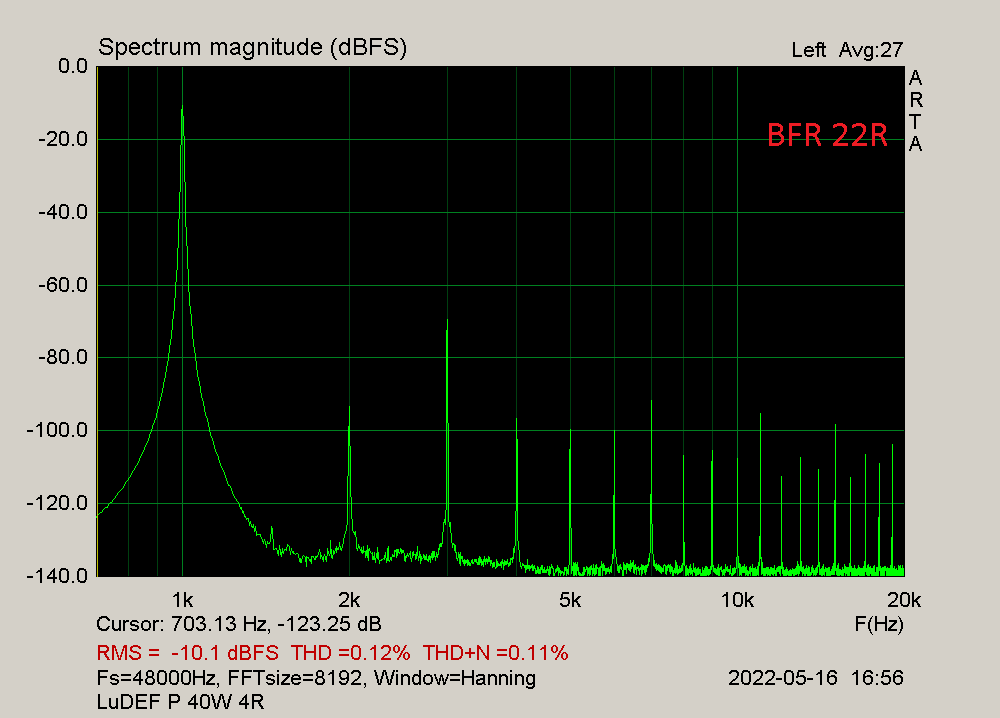

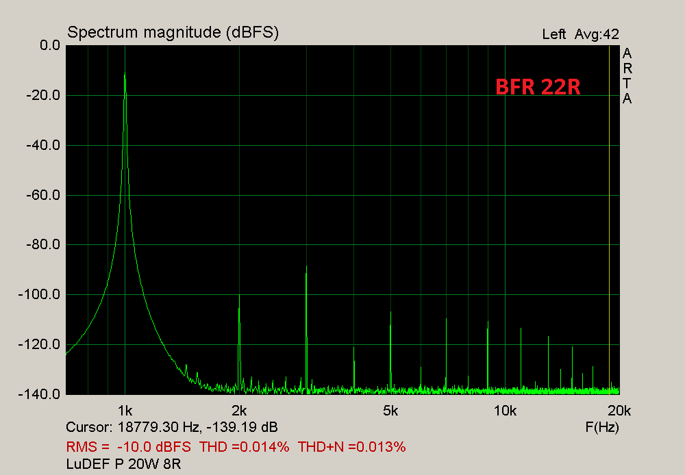

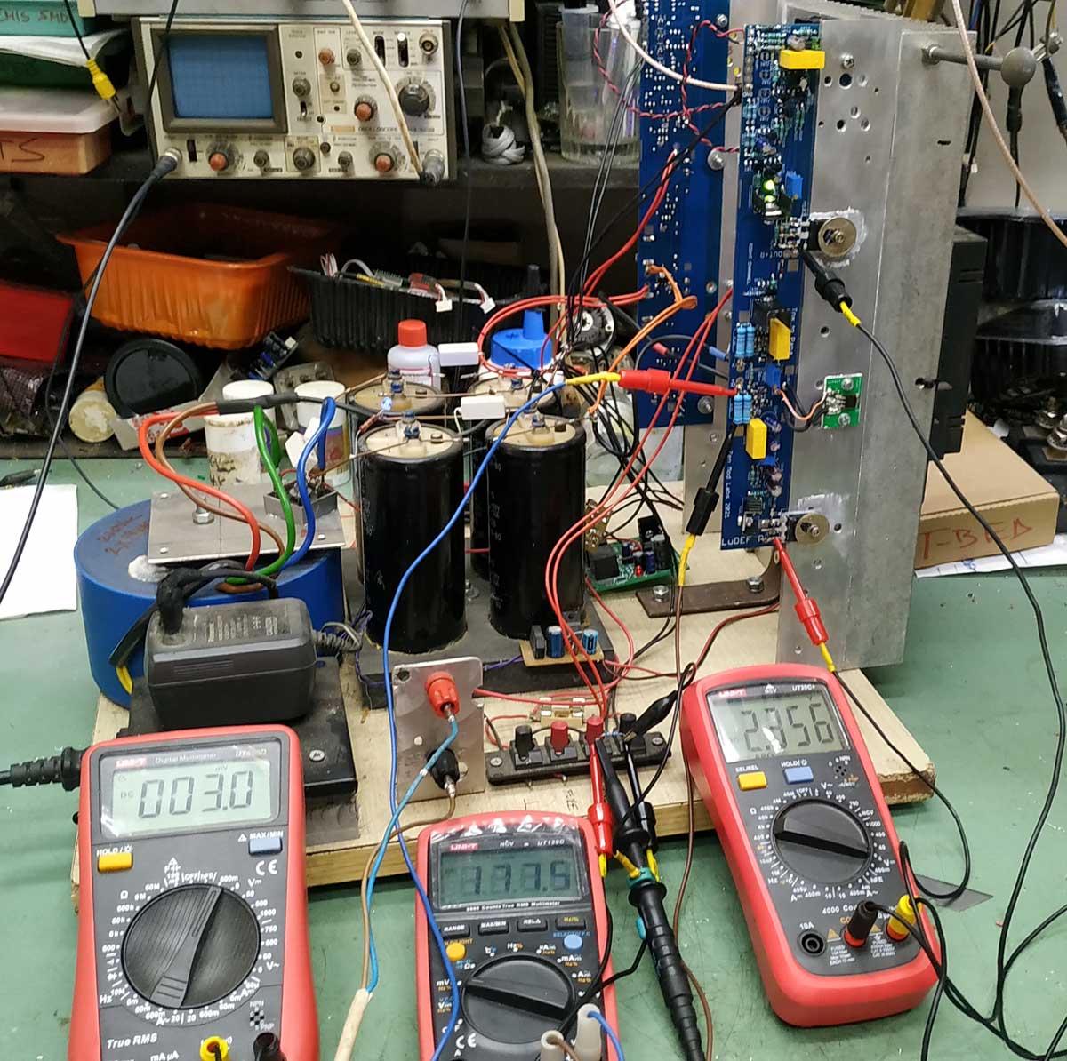

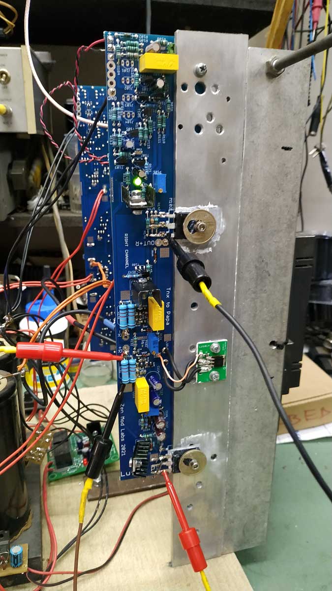

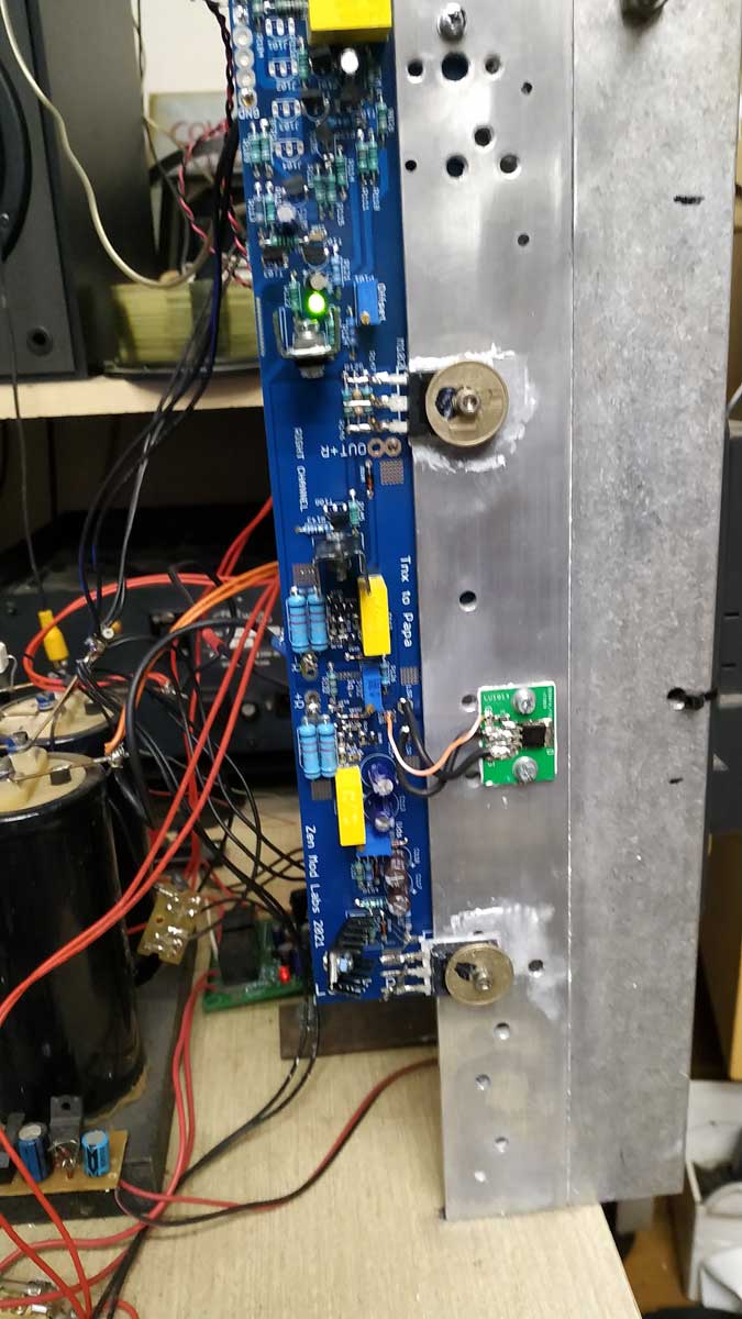

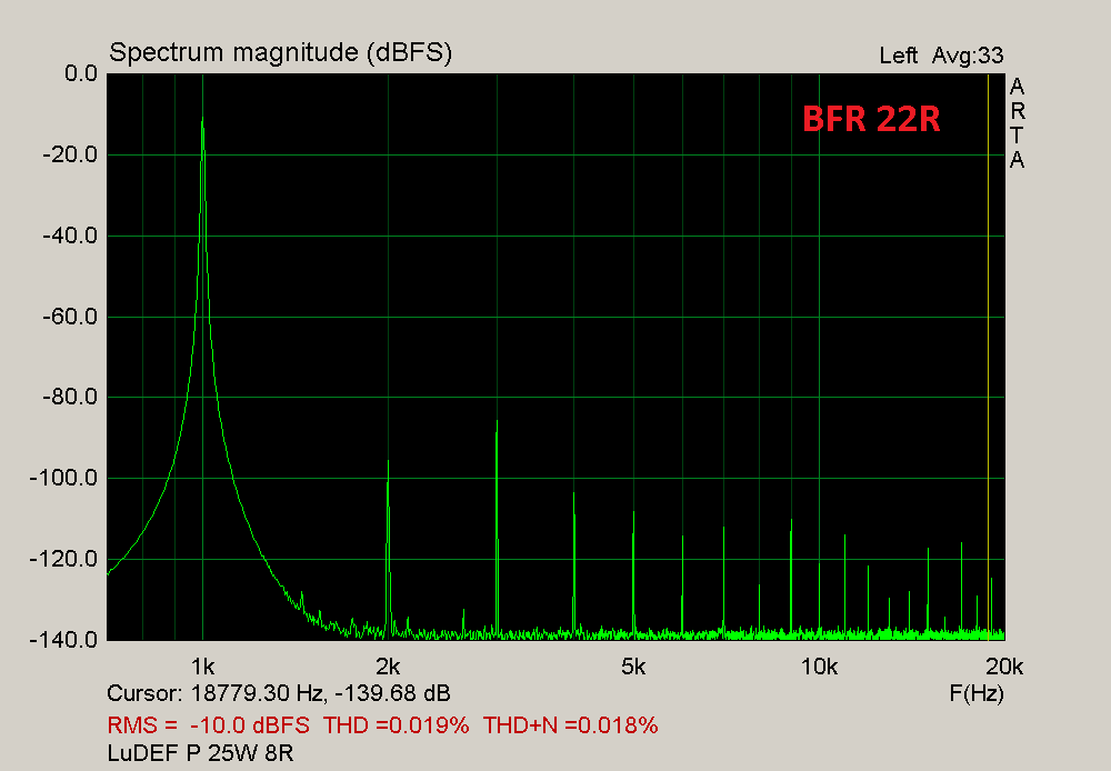

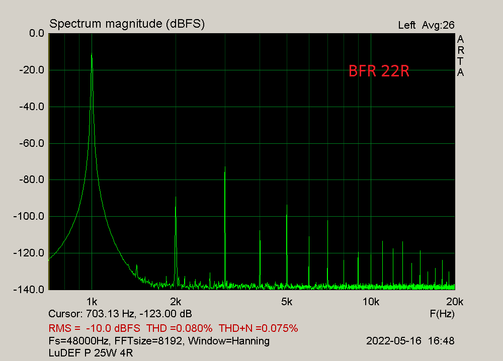

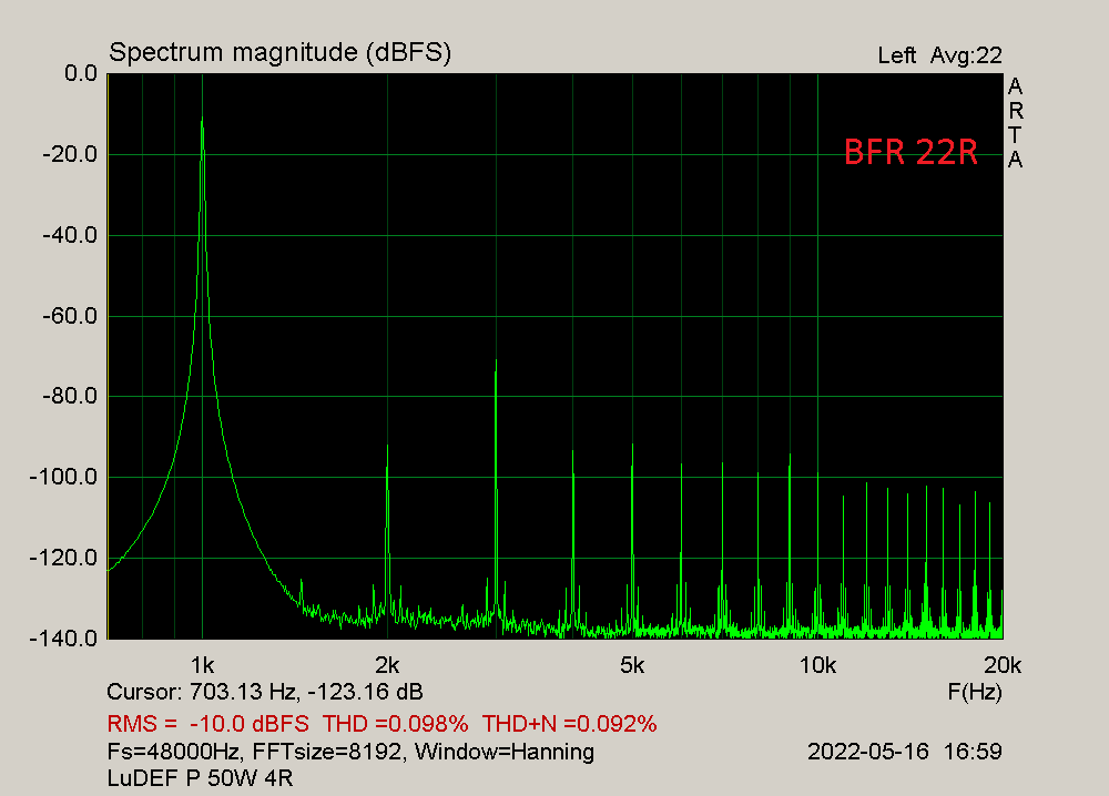

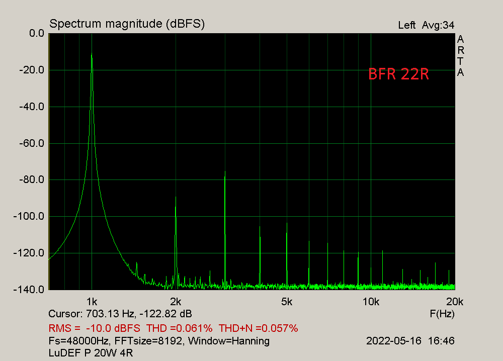

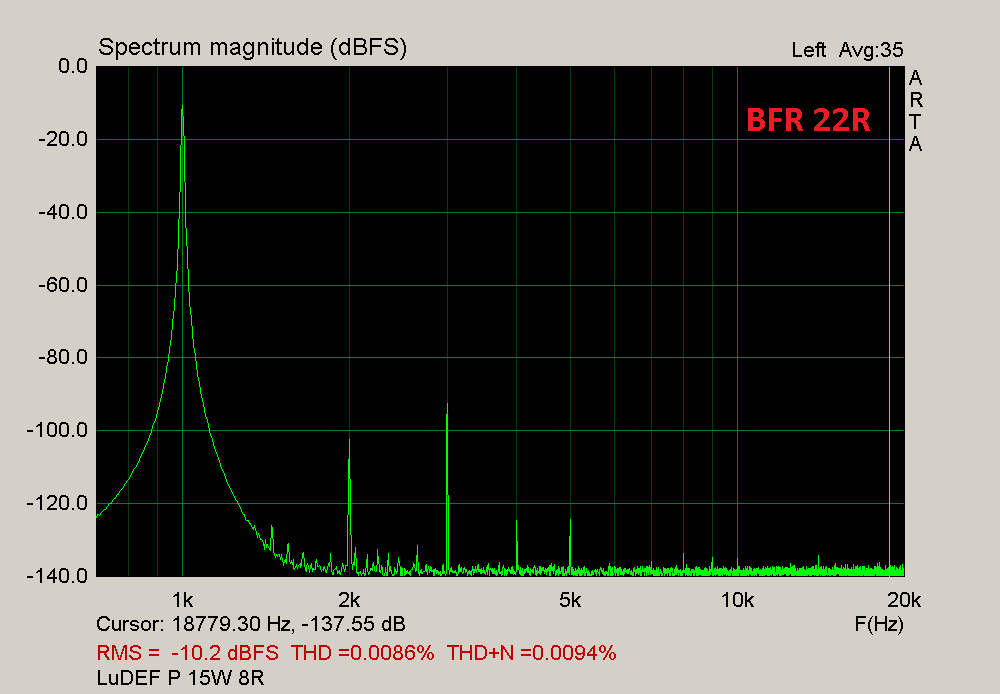

rails +/-23-ish
Iq 1A7-ish
output DC Offset negligible
LU1014 Uds set to 2V4

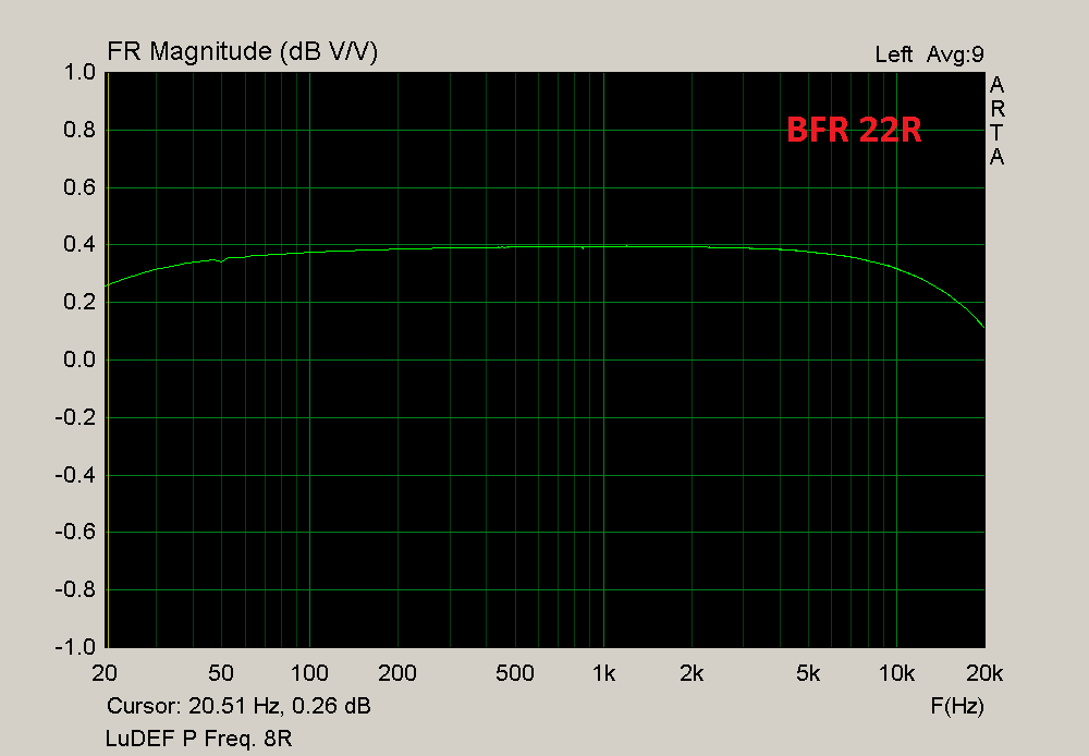

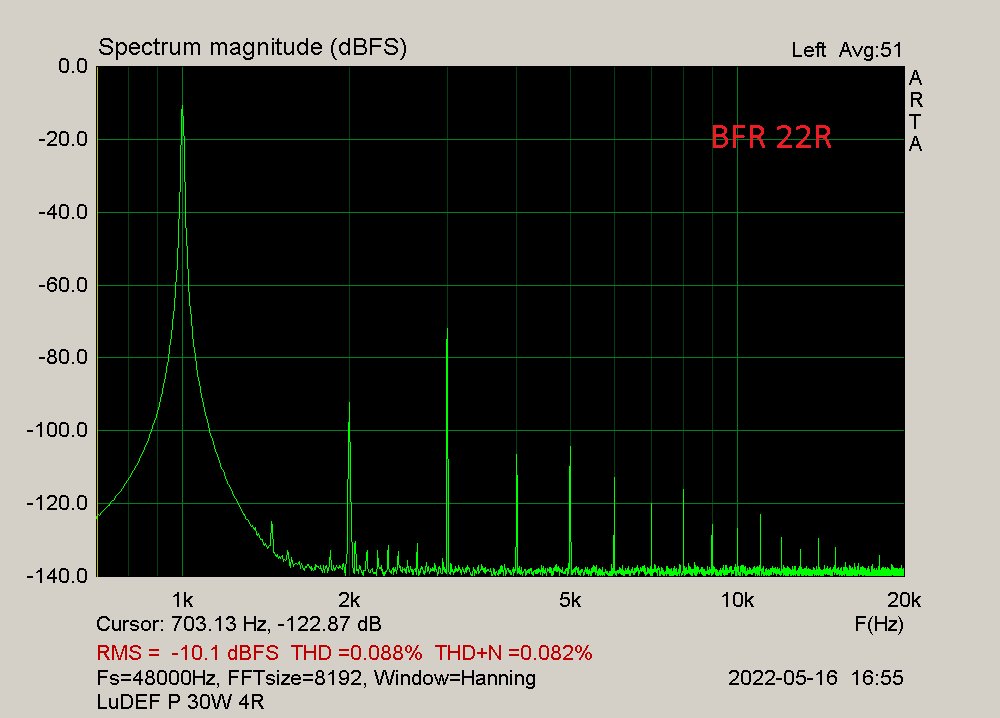

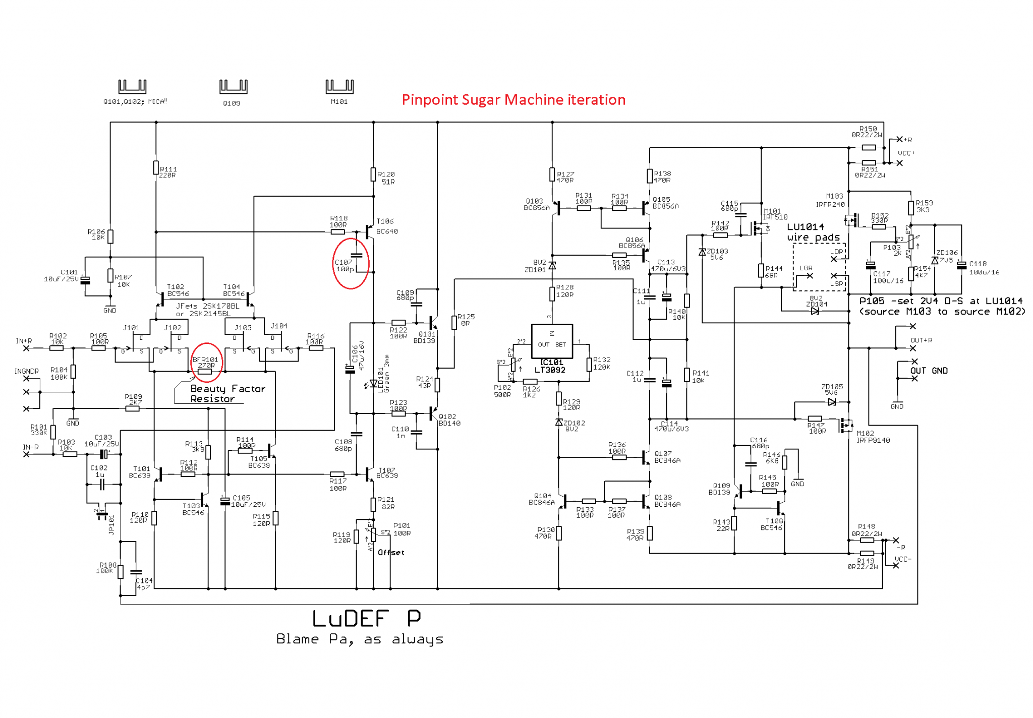

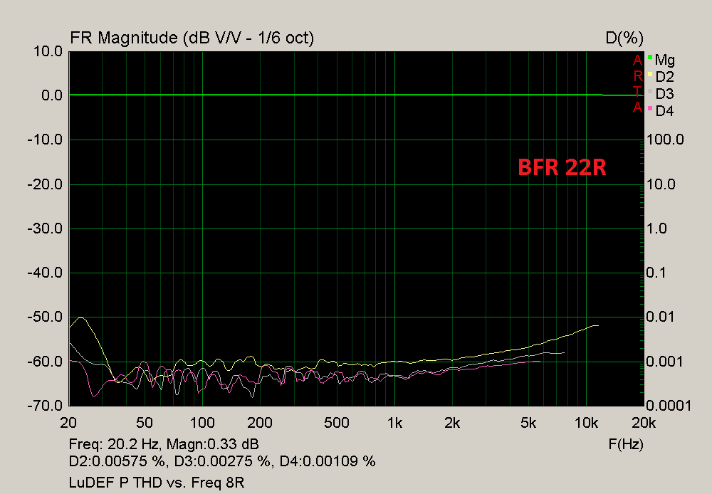

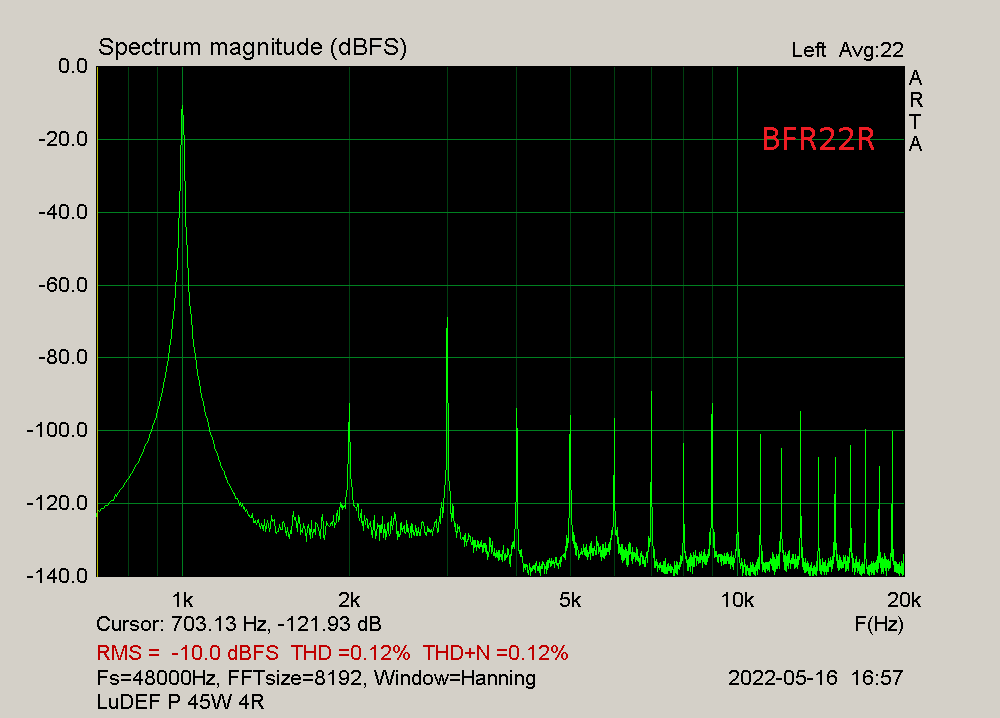

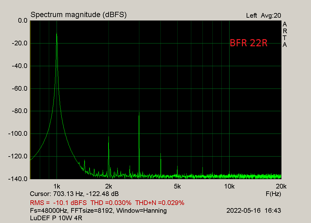

BFR (Beauty Factor Resistor) 22R, so OLG max.
thinking to make MC pre of this one

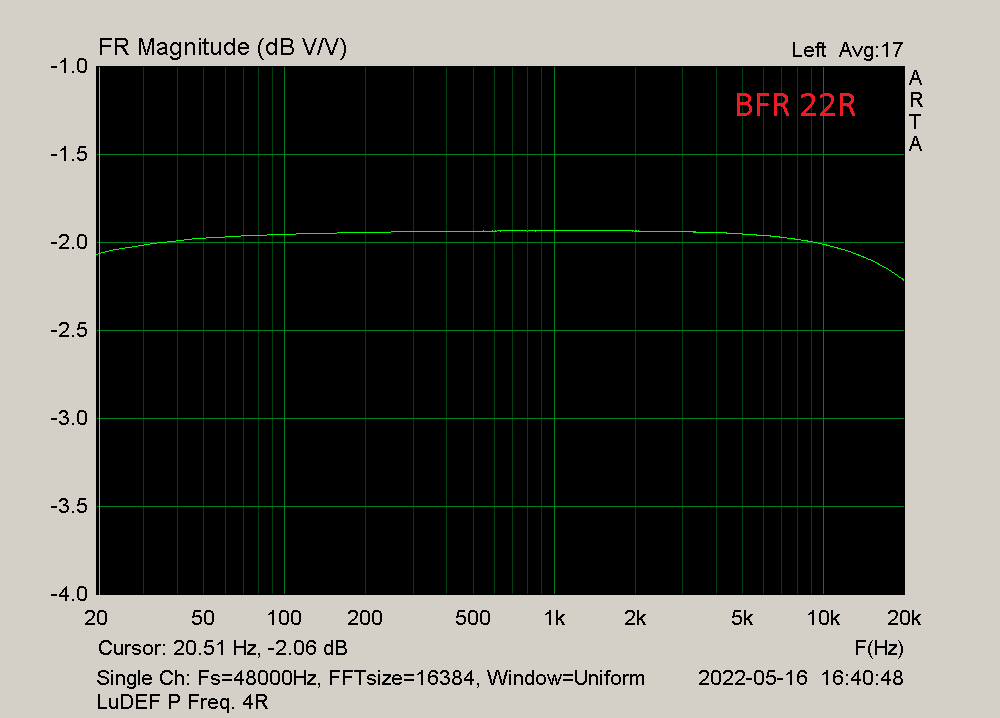

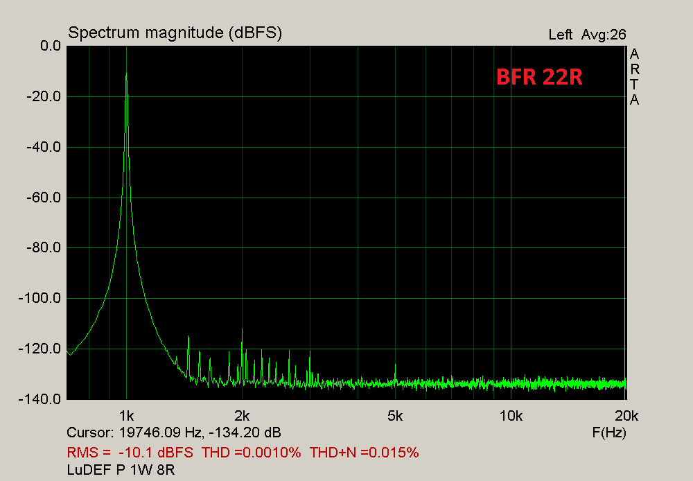

result, Pinpoint Machine - dominant 3rd

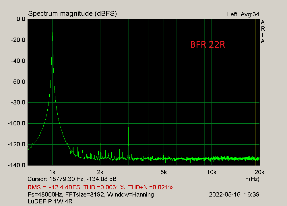

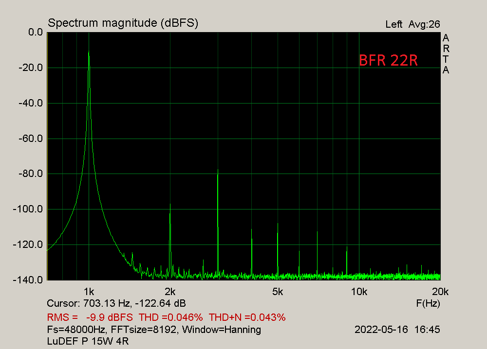

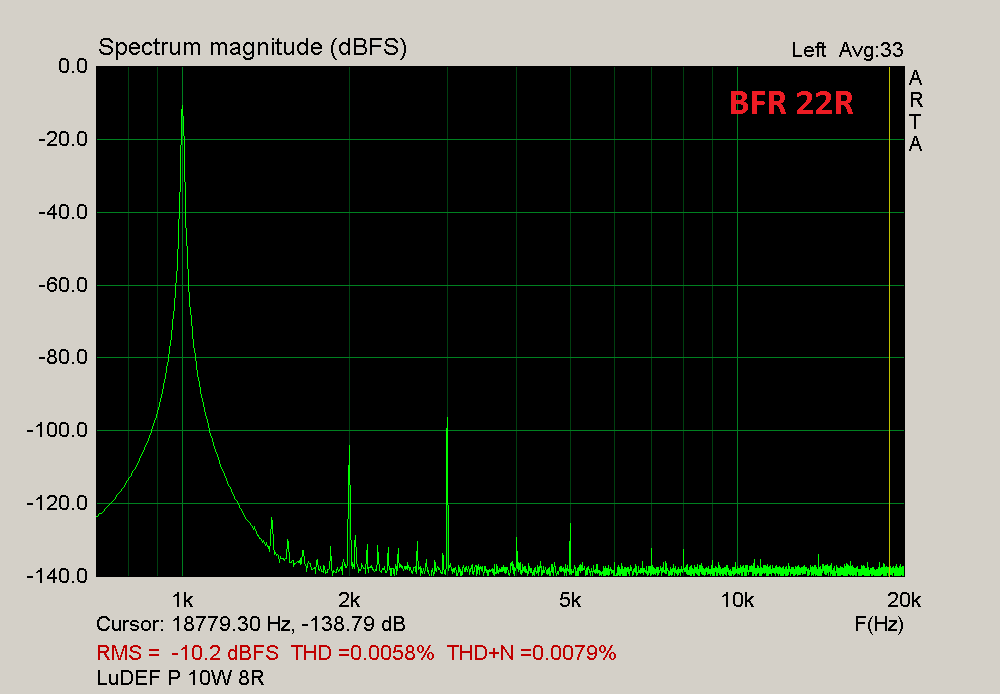

set of graphs for 8R Load:
Iq 1A7-ish

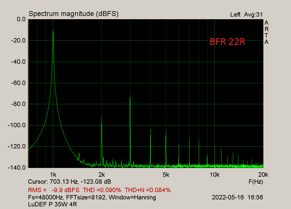

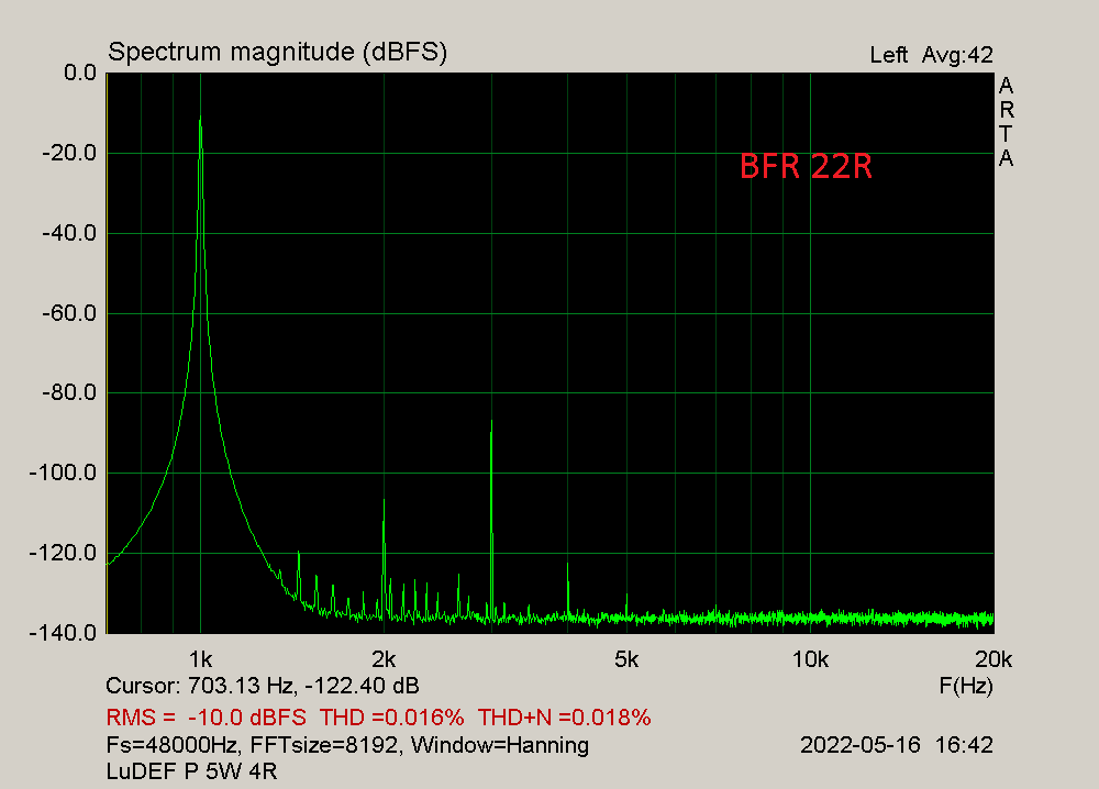

everything the same;
set of graphs for 4R Load

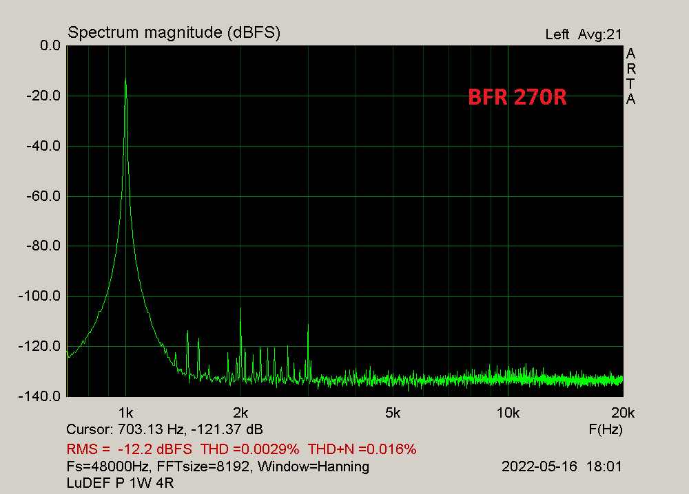

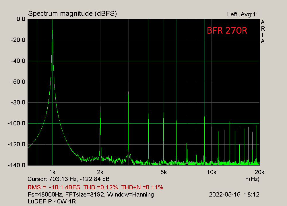

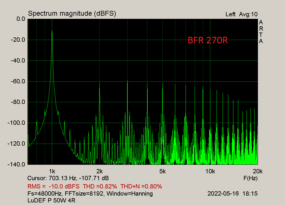

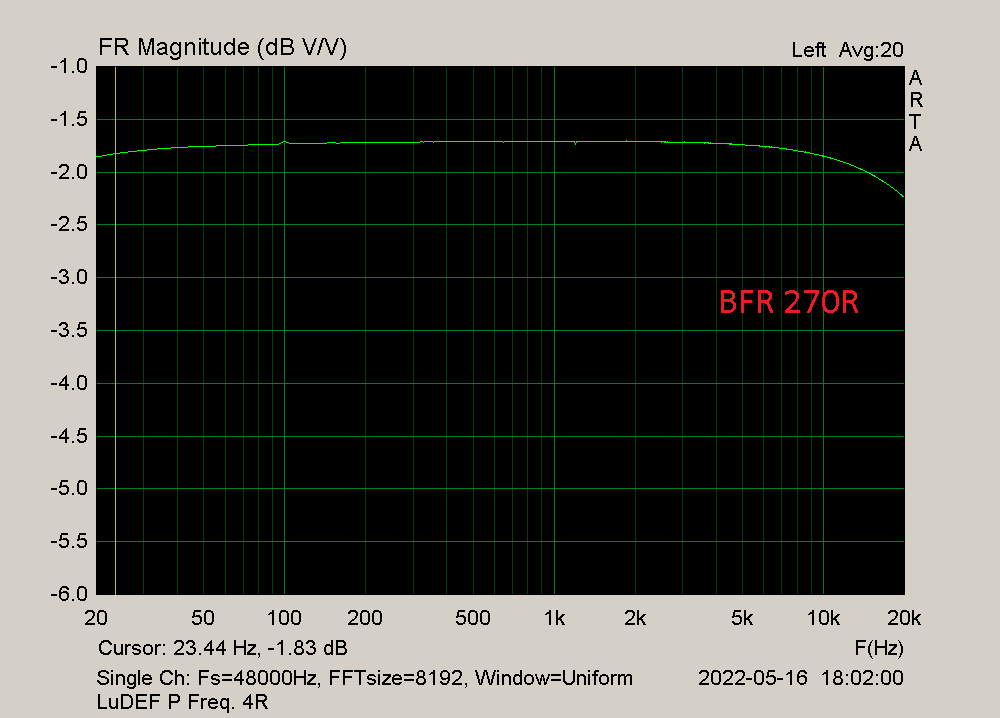

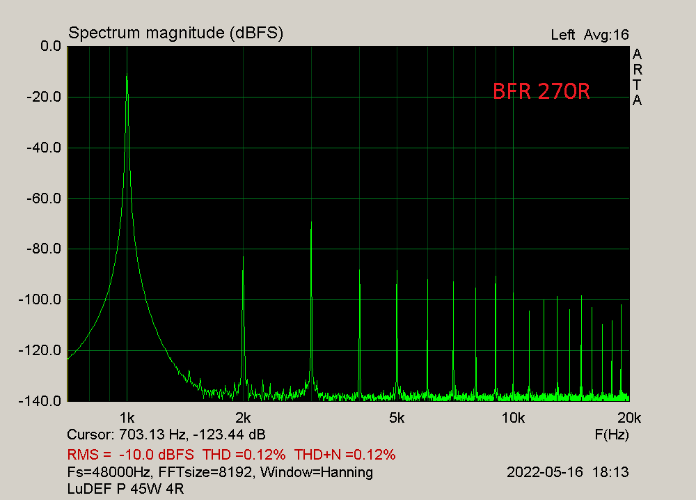

OK, THD levels are ridicolous
But, as intention wasn't dominant 3rd, finally to use BFR position for Sugar Level Tweaking

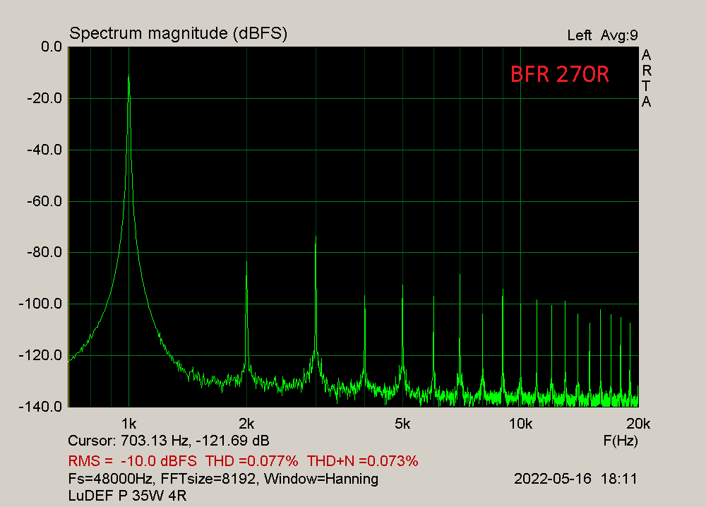

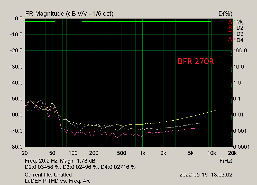

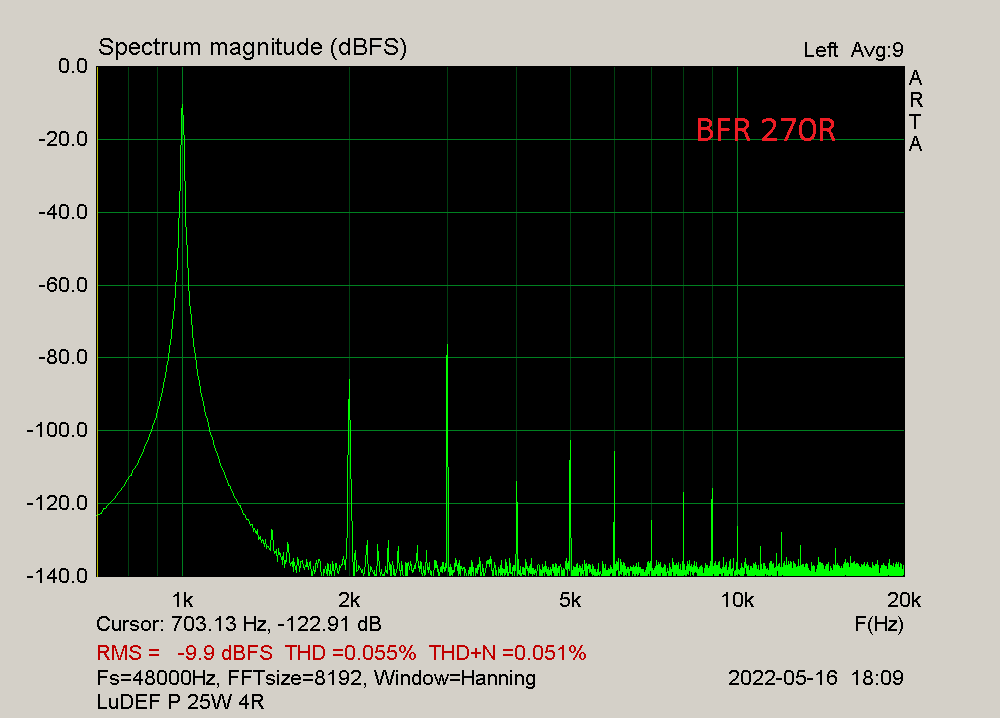

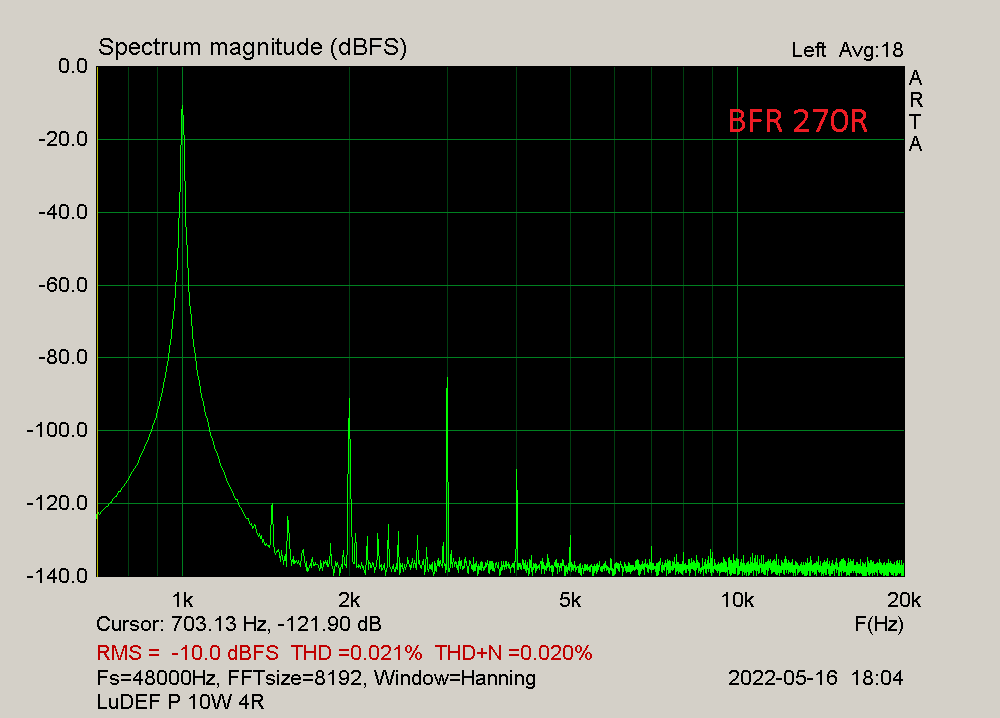

BFR changed to 270R (OLG goes down, amount of NFB goes down, degree of symmetry between phases (LTP) goes down)

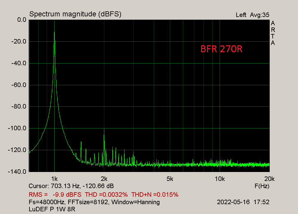

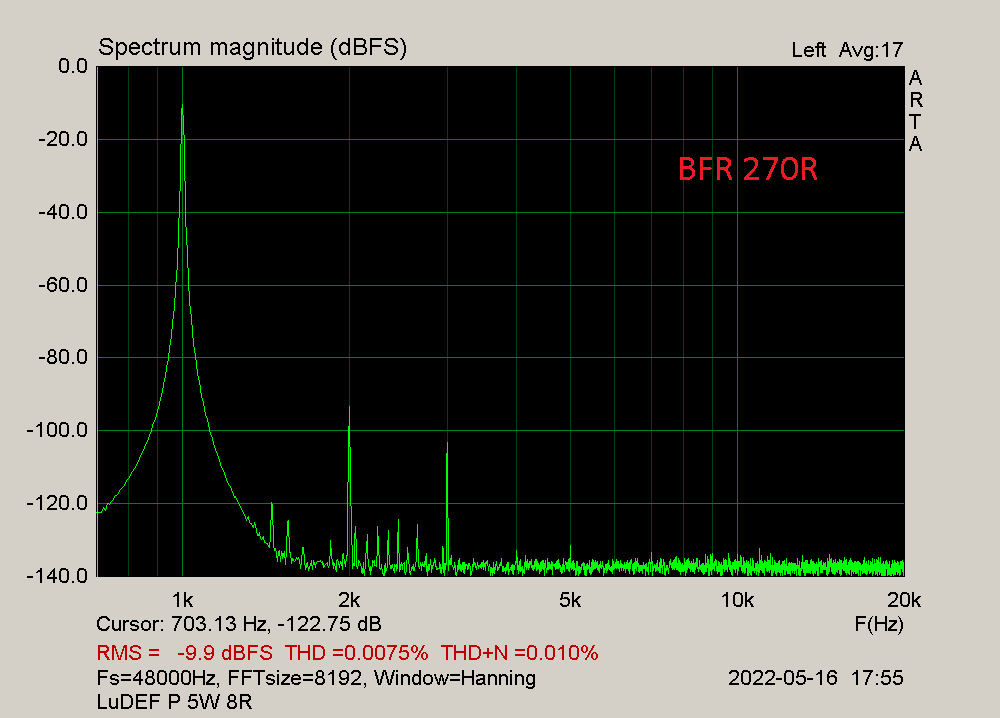

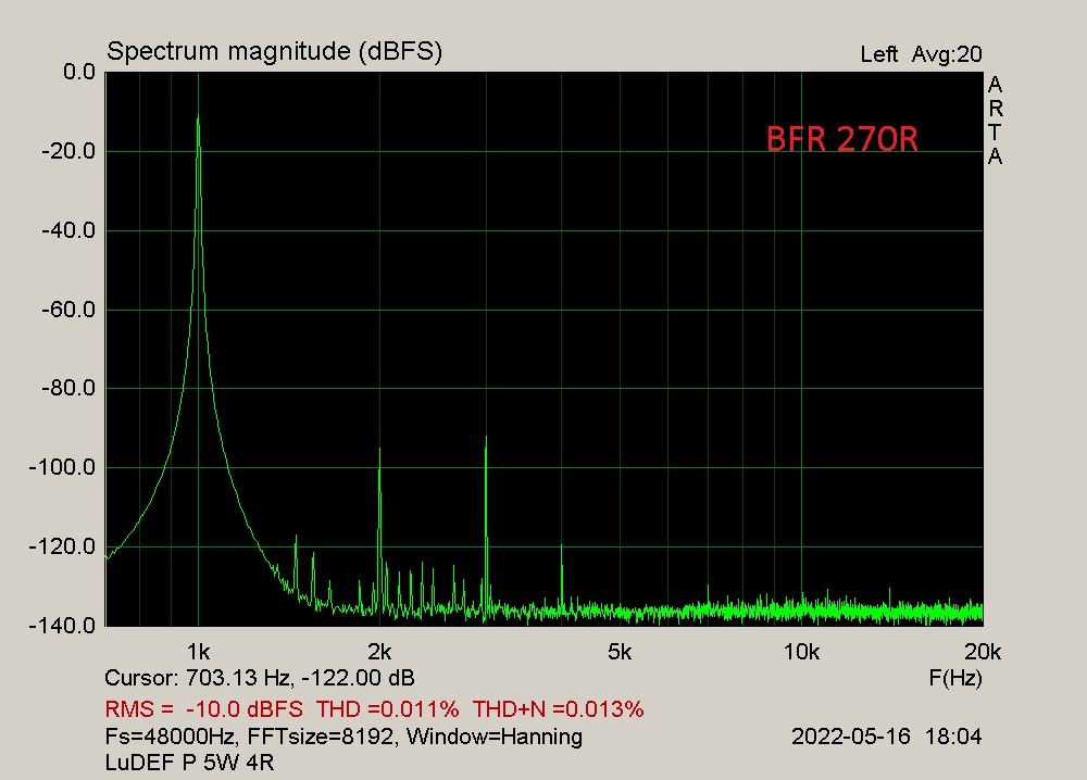

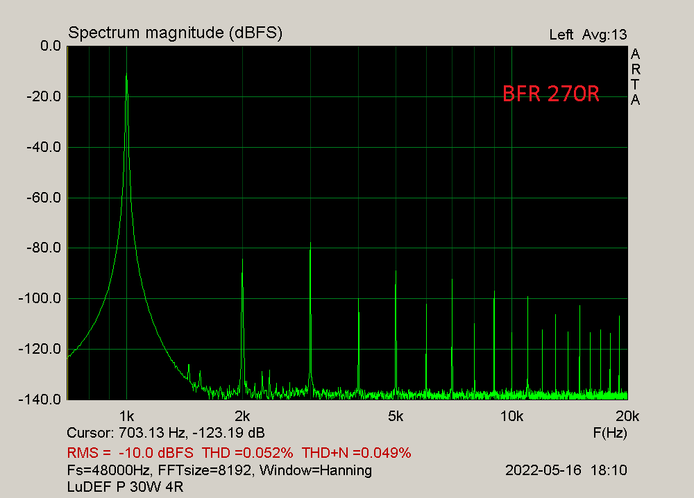

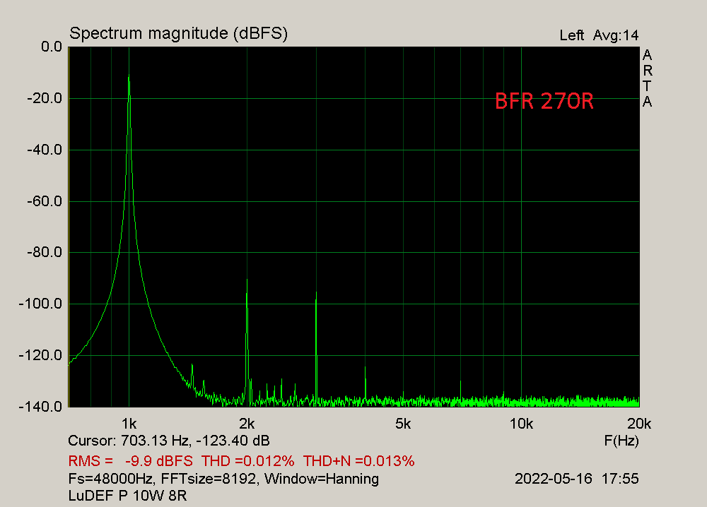

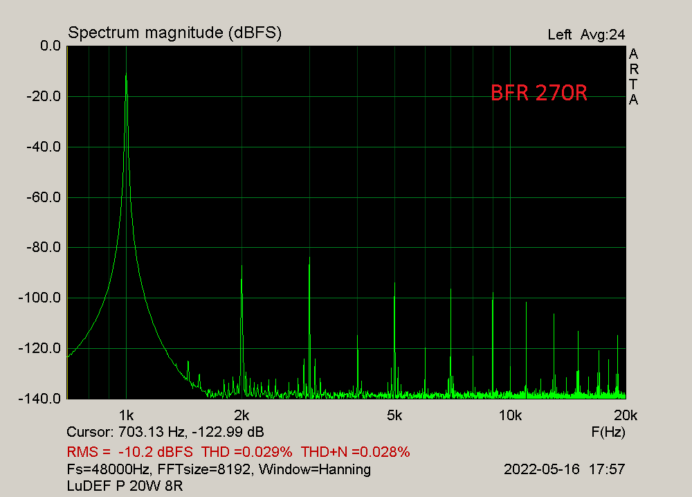

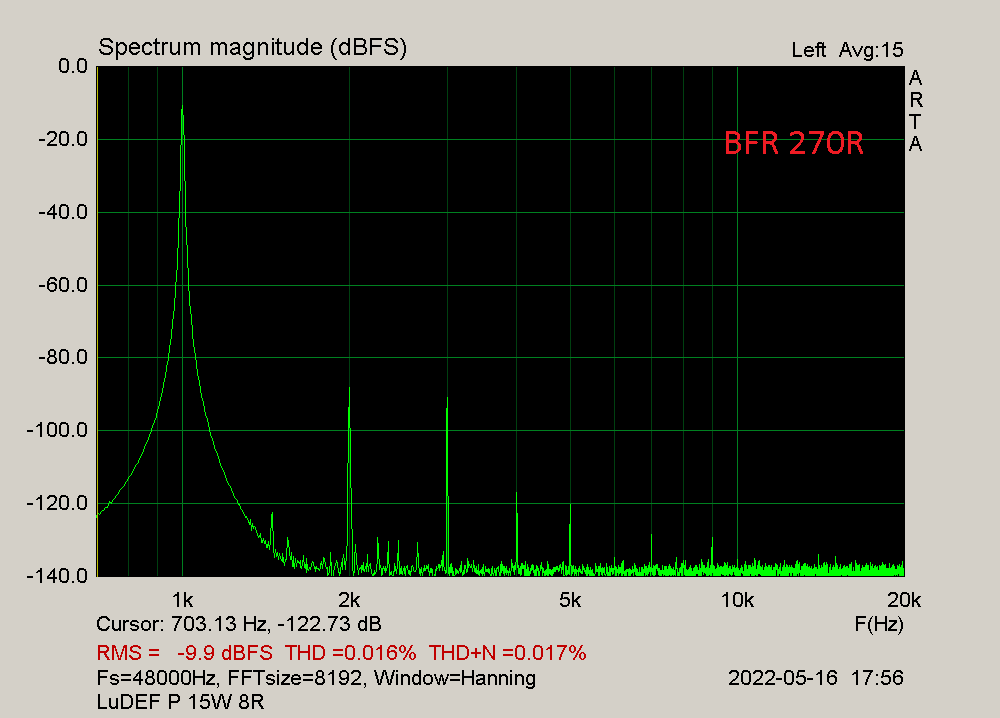

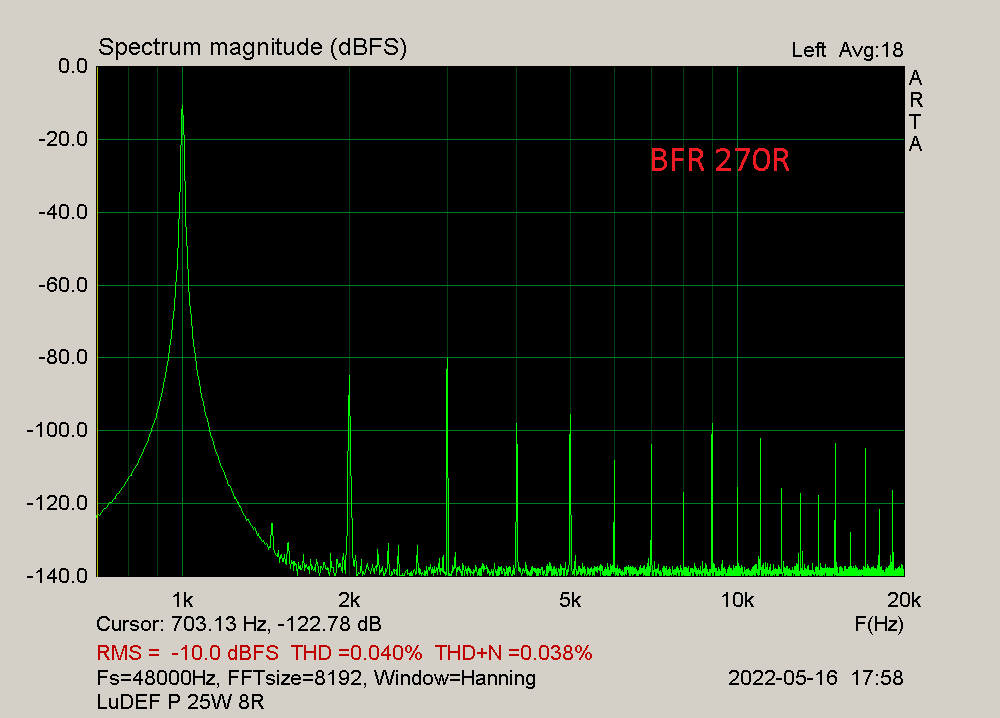

so, to repeat:
rails +/-23-ish
Iq 1A7-ish

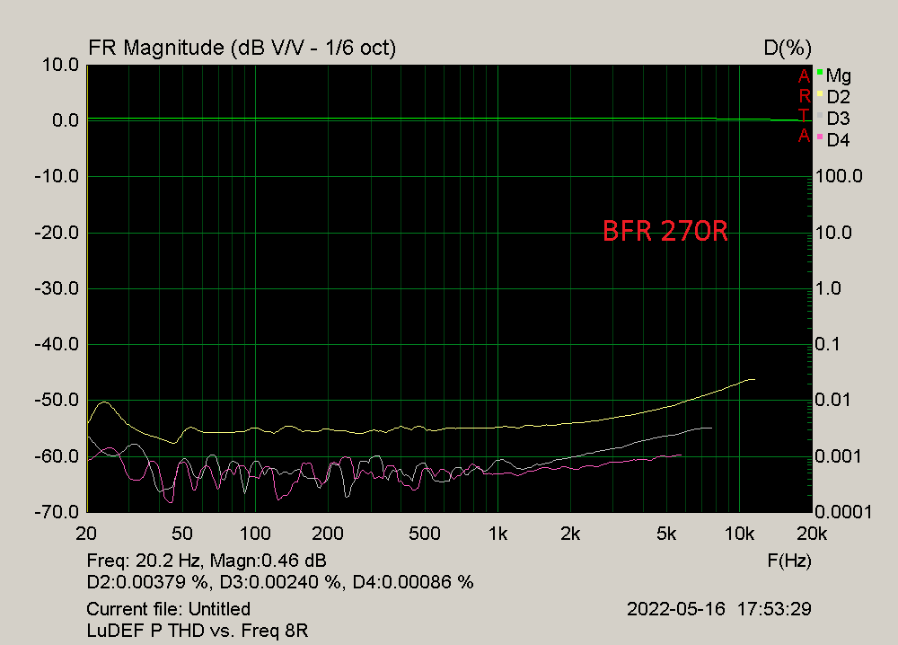

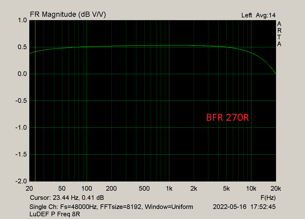

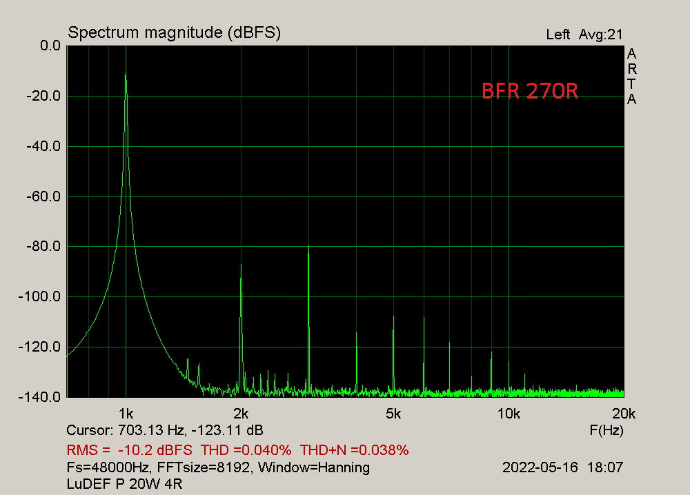

BFR (Beauty Factor Resistor) 270R
result - Pinpoint Sugar Machine, dominant 2nd, THD Levels still ridiculously low
rails +/-23-ish
Iq 1A7-ish

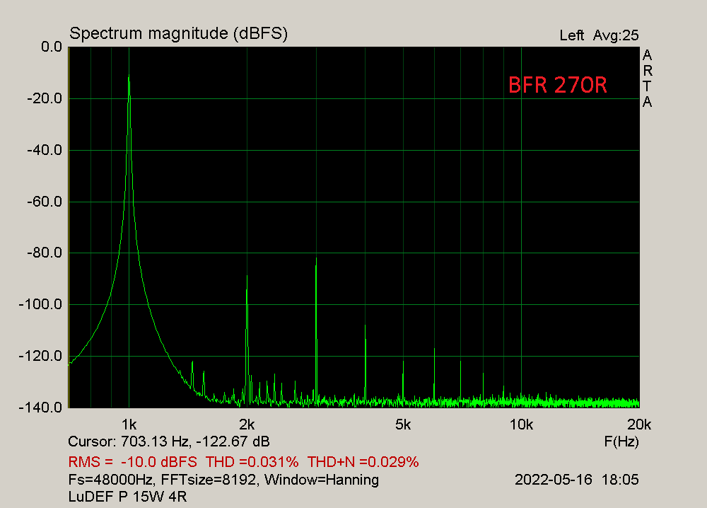

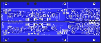

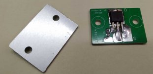

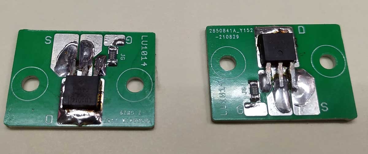

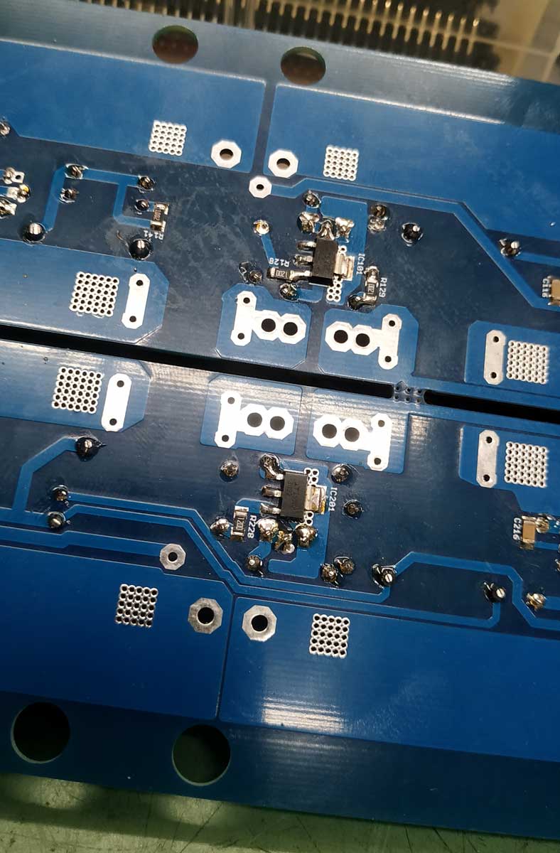

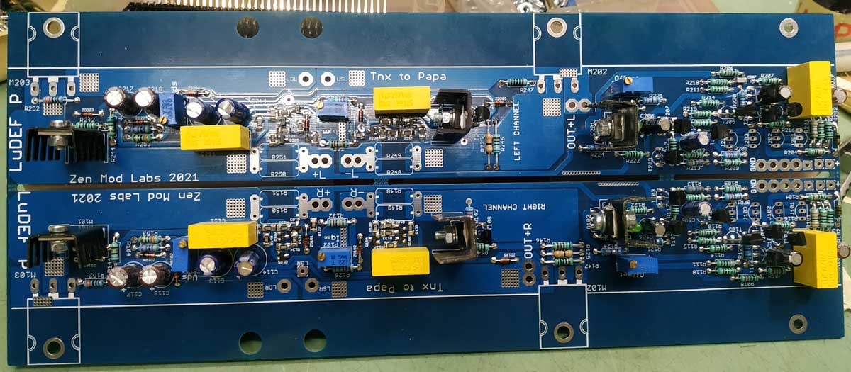

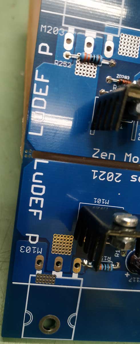

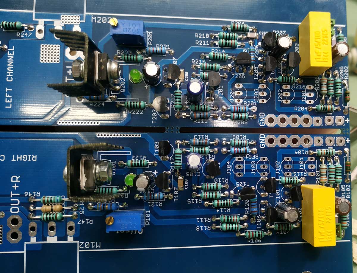

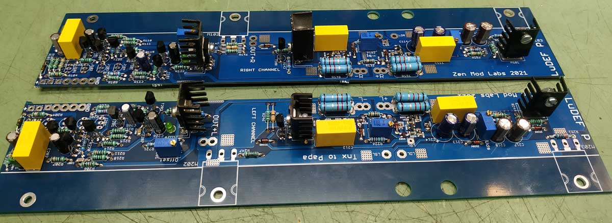

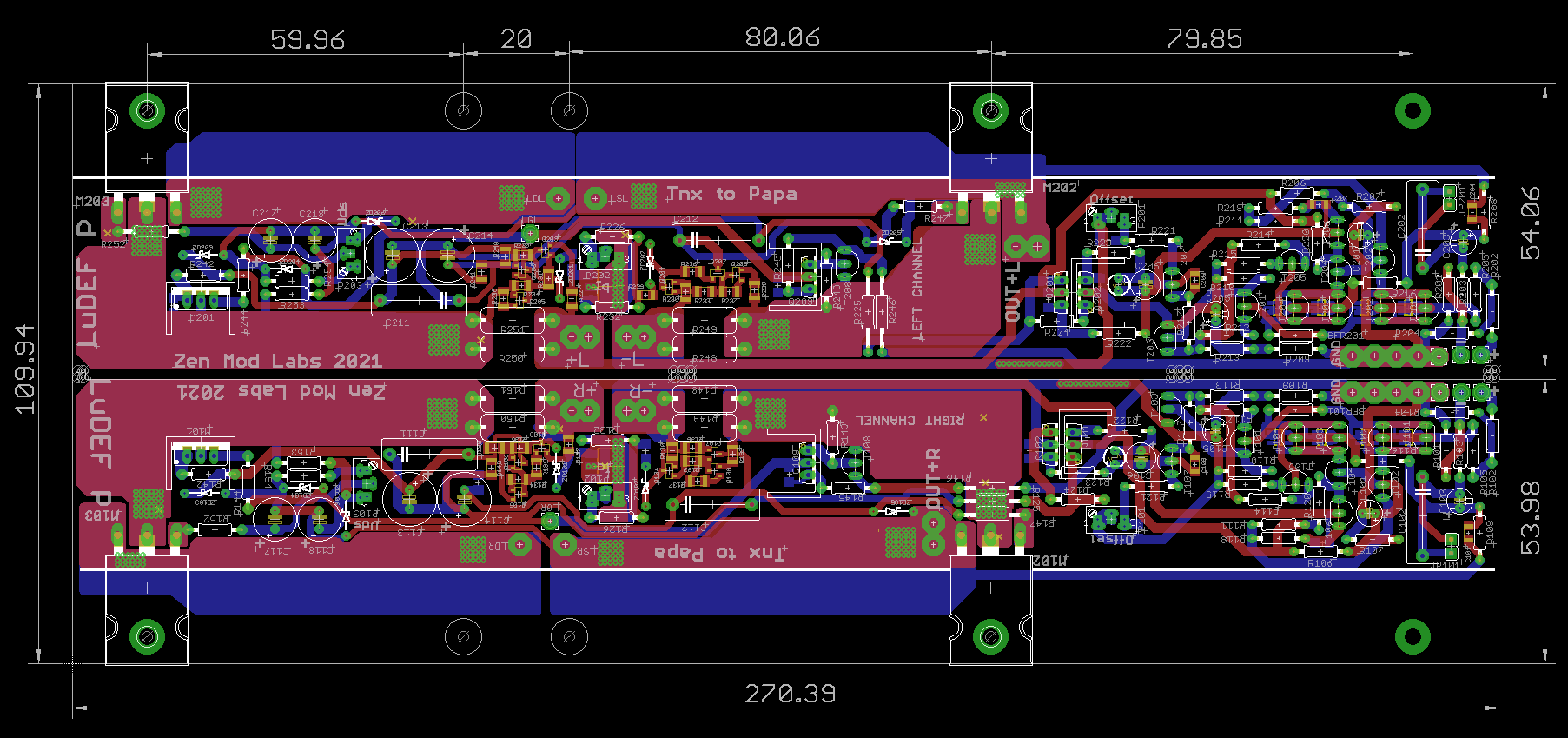

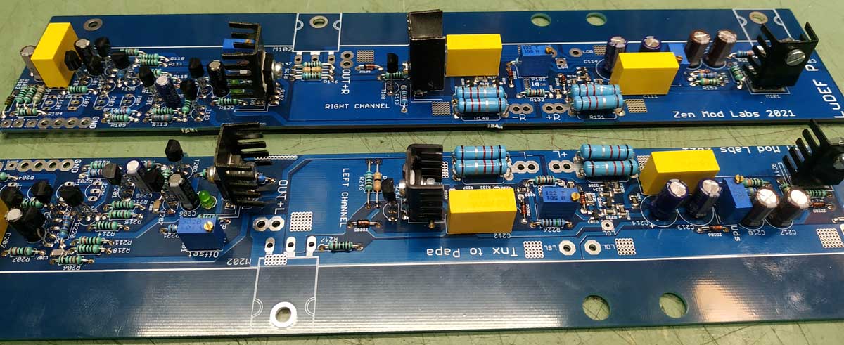

I've just learned that with new board software, now we can edit attachments in opening post
added parts placement pic

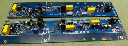

everything is completed, ZM just being lazy with Trade threads

Perhaps a silly question, but as I'm still halfway through mu luDEF build...
Can a luDEF be converted to a LuDEF-P? Would I want to?
thanks
thanks
difference is just in FE
non-P is having autoformer FE, while P is having active FE
as everything exists and almost anything can be converted in something else, LuDEF can be converted to LuDEF P and vice-versa
though, easiest way for doing that is just taking proper set of pcbs and associated parts from drawer
just compare schms in post #1 here and post #1 here: https://www.diyaudio.com/community/threads/ludef.369990/
