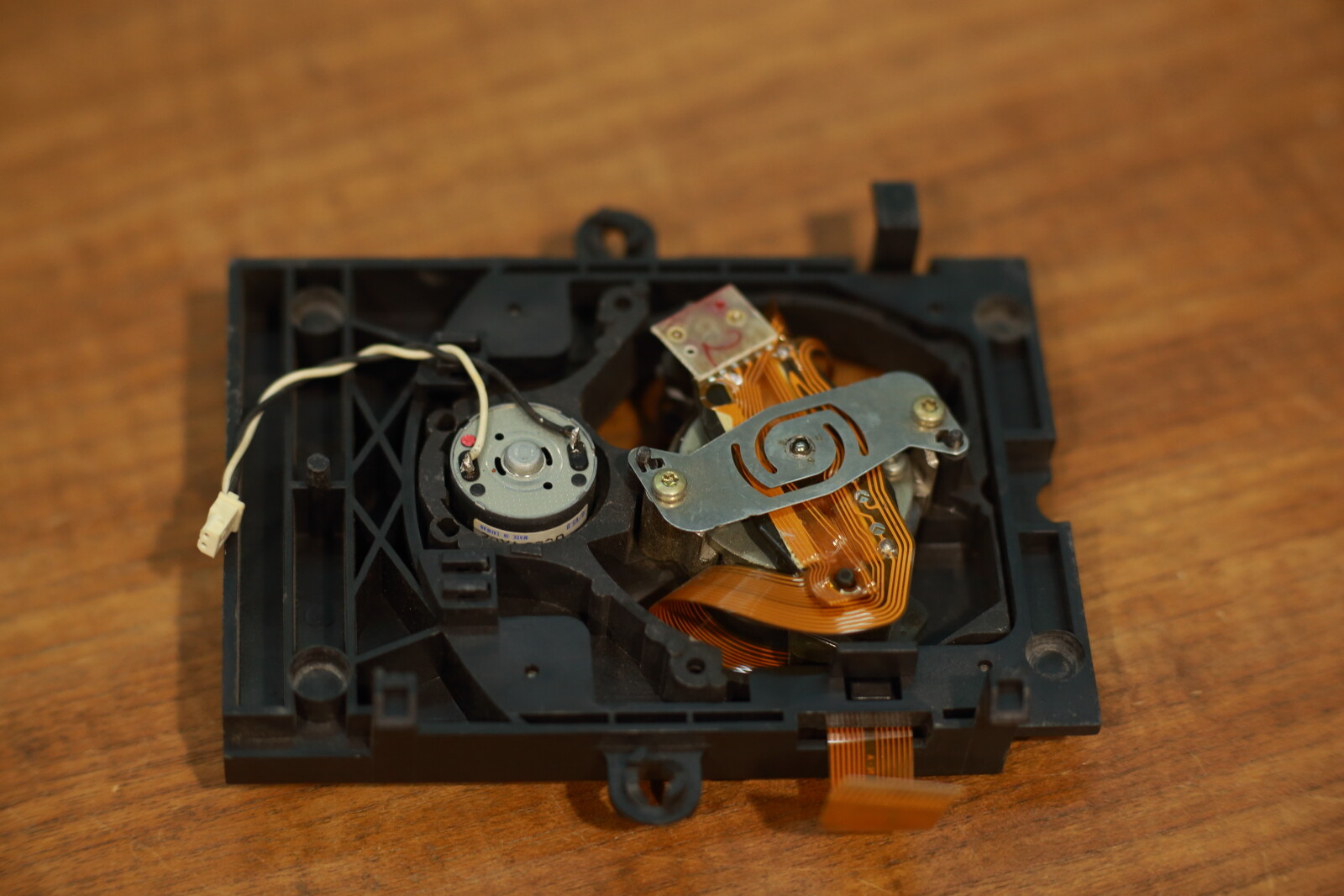

The bottom of the toy-type motor is sealed as seen here:
And the bottom has the press-fit spindle (which I'm told has a very tight and specific height adj, so you don't want to mess with it):
So where to oil (if motor lubing is reasonable to begin with)???
EDIT:
Maybe those tabs on the bottom need pulled back??
EDIT:

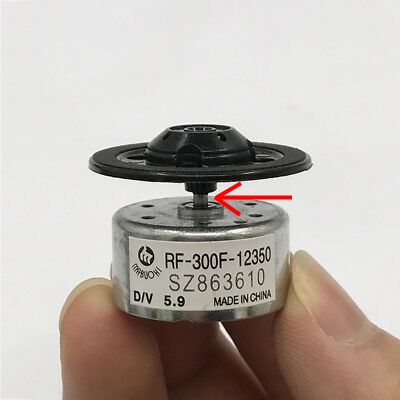

Thanks.Oil here,...
I am concerned about what the OTHER end of the commutator, as well as the brushes, look like 3+ decades after manuf./use ...
... are they worn out, dry, etc???
I would leave the brushes and commutator as is, you can't really do anything to either anyway and dismantling and assembling again isn't necessarily straight forward.
Unless it has a dead spot I'd stop at oiling the bushing.
