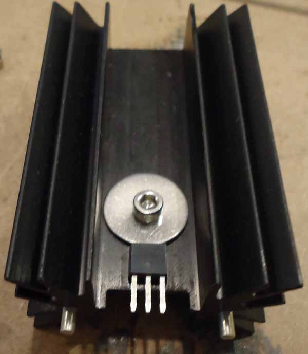

I think we need a thread for my Small LU1014D Amplifier to descibe how to mount LU1014D to heatsink.
In the image you can see one way.
But there are a couple of other options.
Let's see what you can contribute.
Thanks.

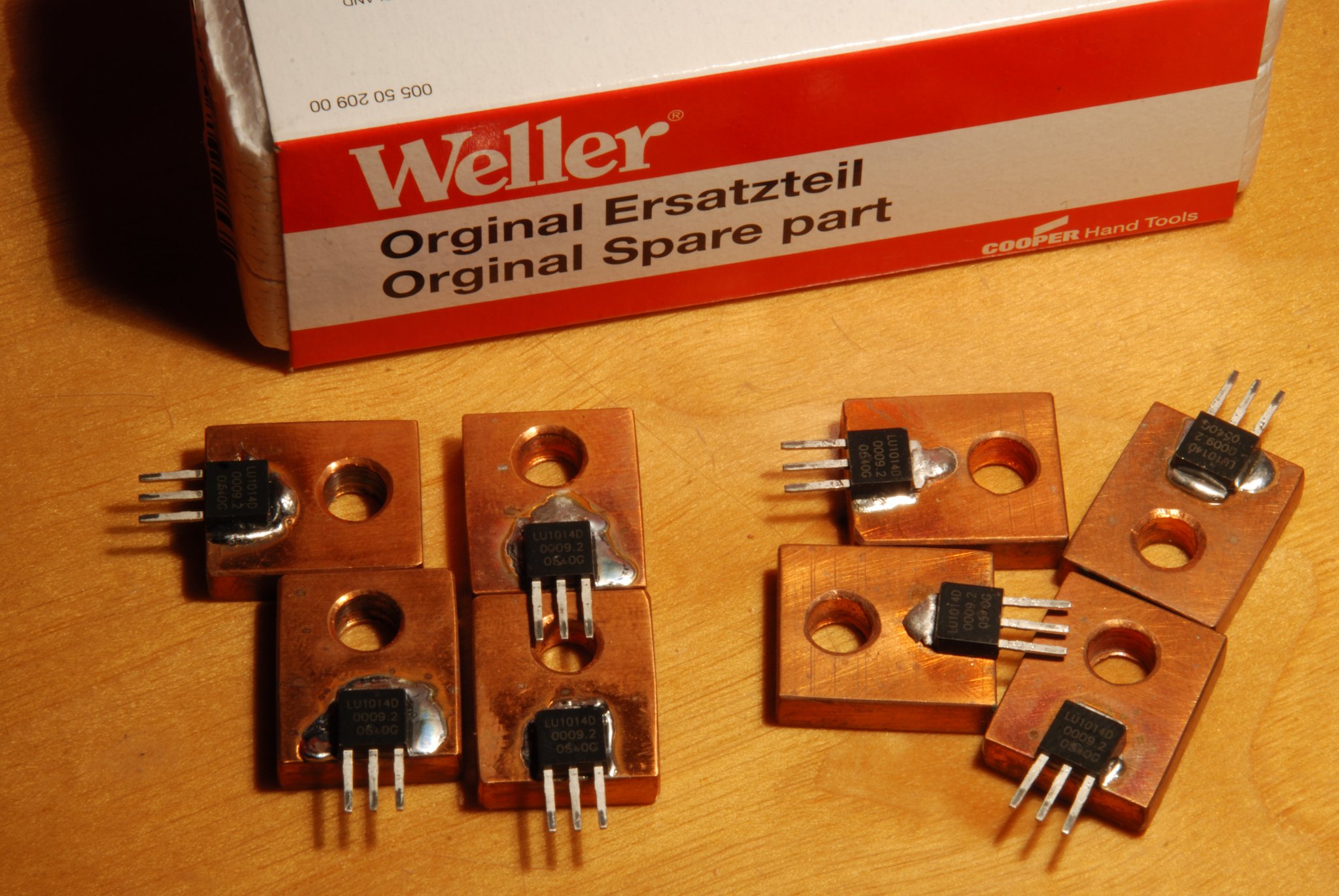

I was offered some LU1014D Adapters by a guy here in forum.
So, there are some adapters around.
I like the idea to solder LU1014D unto a copper adapter.
Then put it onto heatsink with screws.
Maybe use insulators, if this is necessary.
