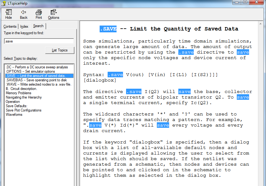

I want output a list power power dissipation and voltage drop across every resistor in my simulation. I would rather do this than click on every element and create a ref voltage point at half the junctures. Also I want this for not just the .op command.
Anyone know how to do this? I assume you write to the log somehow?
LTspice IV>Help> type in keyword .save
to put it on your schematic you have to use the <spice directive> button on the far right of the toolbar

if you don't need the information on every node, branch V,I then you can use .Save to list just those that you want to keep for the analysis in post processing
for instance I just did a sim with one of my circuits that created 95M .raw file
with the directive:
.Save Is(M1)
the .raw is only 3.5M
if your circuit needs some time to settle from the turn on transient you can also cut the size of the .raw output by specifying in the .tran a time to start saving data - just save the last cycle of the analysis frequency of your .four fundamental
but the post processors all require the .raw saved data, no way around that

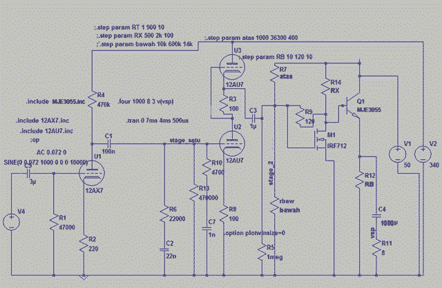

halo mister
lot variable step is required to optimize the circuit
to look for maximum amplitude with low distortion
i want to analyze 5th order distortion to 2nd distortion
so the max amplitude not will low thd but have low higher odd distortion also
if the step not limited to 3, i m sure a more lot people want to use it

The part tolerances for tube amps are quite wide and drift with tube aging, so if you have to optimize 20 parameters just to get ultra-low distortion, then why not just stick with a pure SS design?
Also take a look at using the Monte Carlo function in LTSpice, I don't think there is a limit on the number of components that can be used, if there is, it is probably higher than 3.
