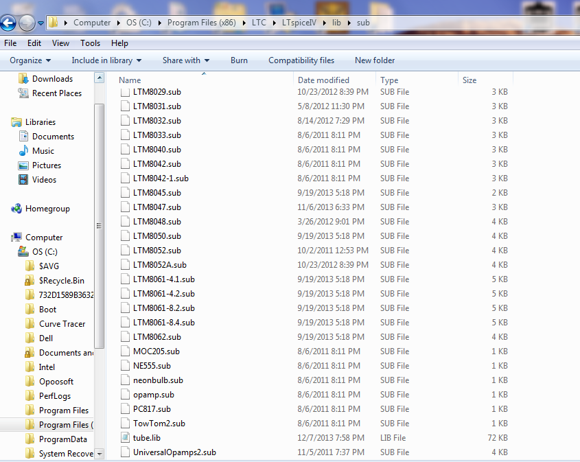

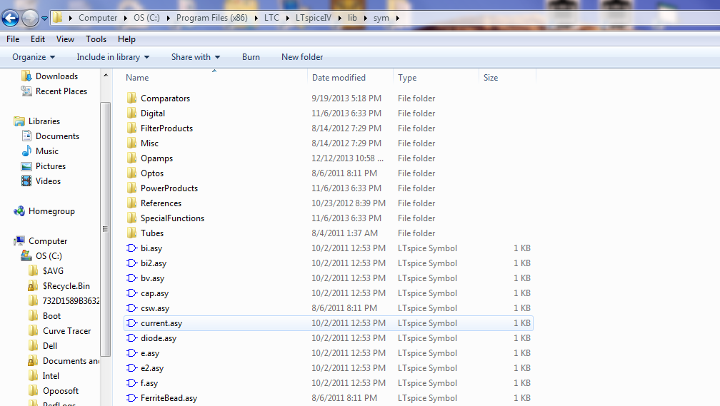

I am going to post some instructions and give you the files you need to install a large tube library in LTSpice. Apparently all of the older threads where I provided the files and instructions have evaporated - I was trying to find those.
OK so you want to install a collection of tube models and their supporting symbols. Note both are provided with no warranty implied or otherwise.
There are two directories you need to locate. LTspice is a 32 bit program and will be installed in program files in xp or Program Files (X86) in Win 7. Locate the LTC folder..
Path to tube symbols is \LTC\LTspiceIV\lib\sym - unzip the tube_sym zip and paste the folder here.
Next step:
Path to tube library is \LTC\LTspiceIV\lib\sub - unzip the tube_lib zip file and paste the file here.
Start LTspice and under the component folder (AND gate on the menu) you will see a folder called 'Tubes' click on this and you will find diode, triode, tetrode, and pentode folders. Click on the folder of your choice and you will get a number of choices. I have lots of triode models and fewer pentodes, tetrodes and diodes. A few models may be funky, but most work ok.

Thank you for your clear instructions, and tubes now work. One exception that was that I left "tube.lib" as just "tube". If I added ".lib" to the name, LT Spice did not recognize the file. Anyhow, below, I put together this simple headphone amplifier schematic exactly as per an online design. Green is the input, and Blue is the line out. I'm getting some undesirable clipped lower-half waveform behavior when I feed a signal on the input. At lower frequencies, the distortion is even worse. Is this the circuit design's fault, or am I abusing LTSpice? Thank you.
Strange that you had to remove the .lib from tube library, I have 3 installations of LTSpice on different machines currently and this worked fine on all of them.. Hmm..
