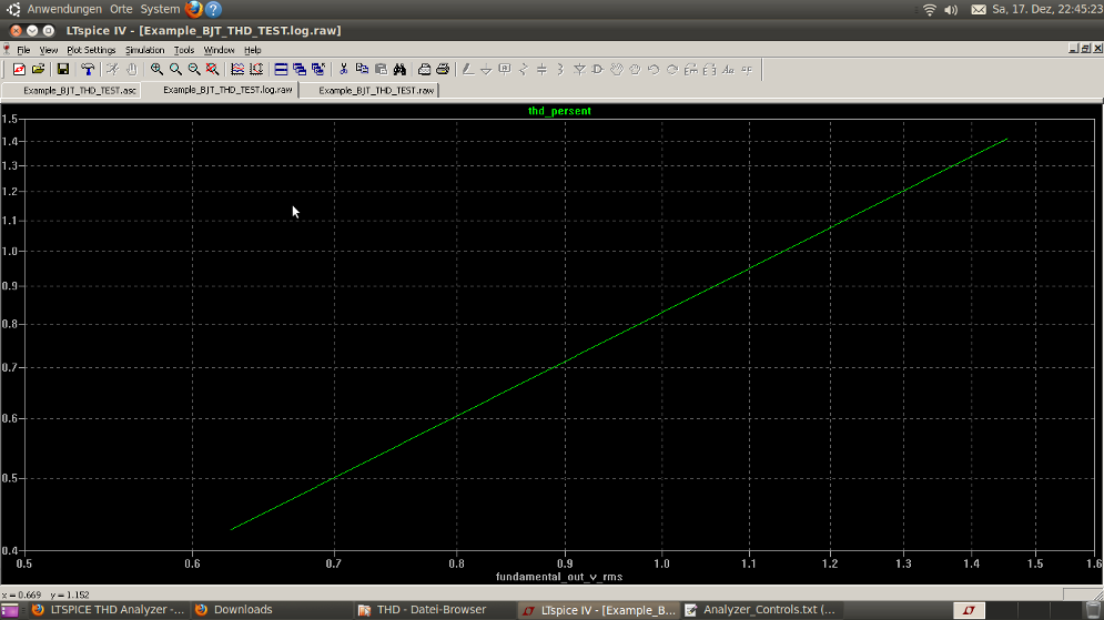

THD_Analyzer.zip contains all necessary files and example. Unzip all files in the same directory, open “Example_BJT_THD_TEST.asc” and run simulation.
You can monitor analysis progress in the left lower corner of LTSPICE window. After simulation and analysis is complete (including completion of .MEASURE), follow the instructions to display
results.

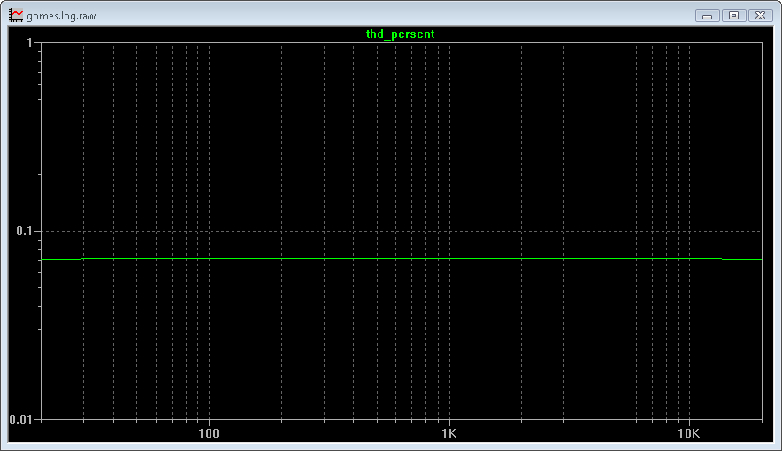

Hello,
You made all modifications correct.
To display distortion vs. frequency plot:
Double click on horizontal axis label of your distortion plot.
Put fg label name instead of Fundamental_Out_V_RMS
Set frequency limits and log scale. You may have to do this twice for log to be applied.
Eugene

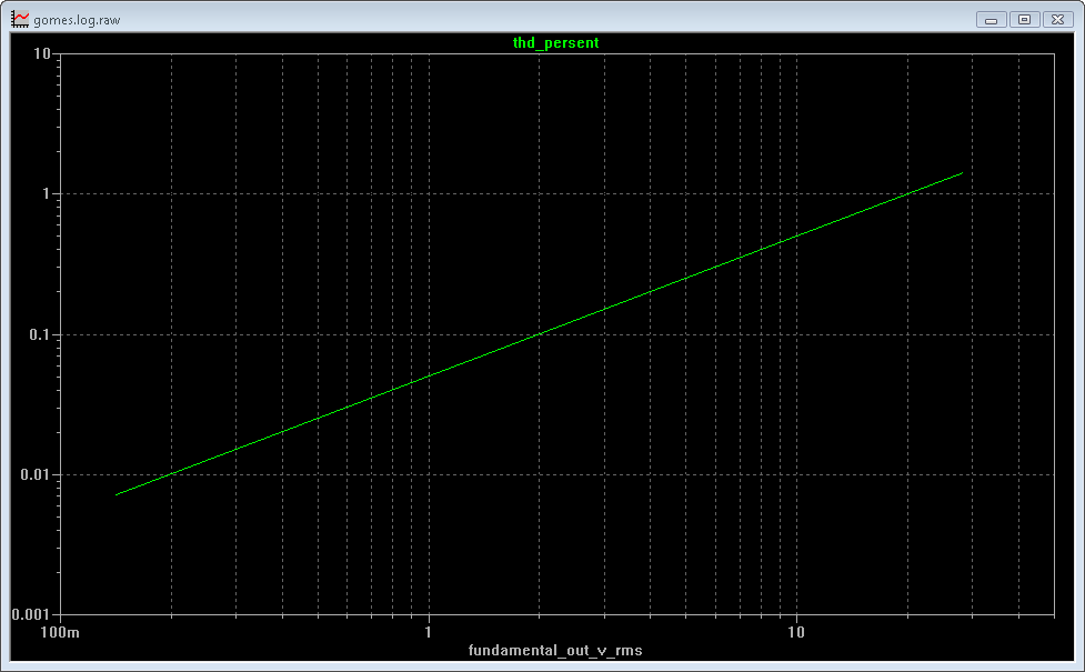

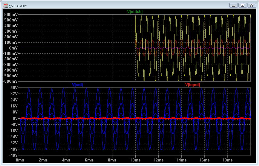

Hello,
You have to place analyzer symbol on your schematic and connect it's output to your amplifier input and analyzer input to amplifier output. The same way as if you are using real measuring equipment.
I modified your schematic. It is in zip file, together with 2 plot setting file (*.plt), that you may use to display frequency or amplitude sweep results. You can also see control file example for amplitude sweep.
Pictures show transient plots for amplitude sweep and distortion plots for your circuit, frequency and amplitude sweeps.
Don't hesitate to ask any questions.
Eugene.

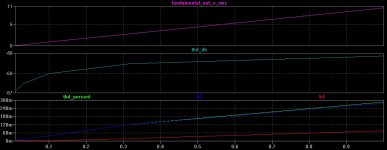

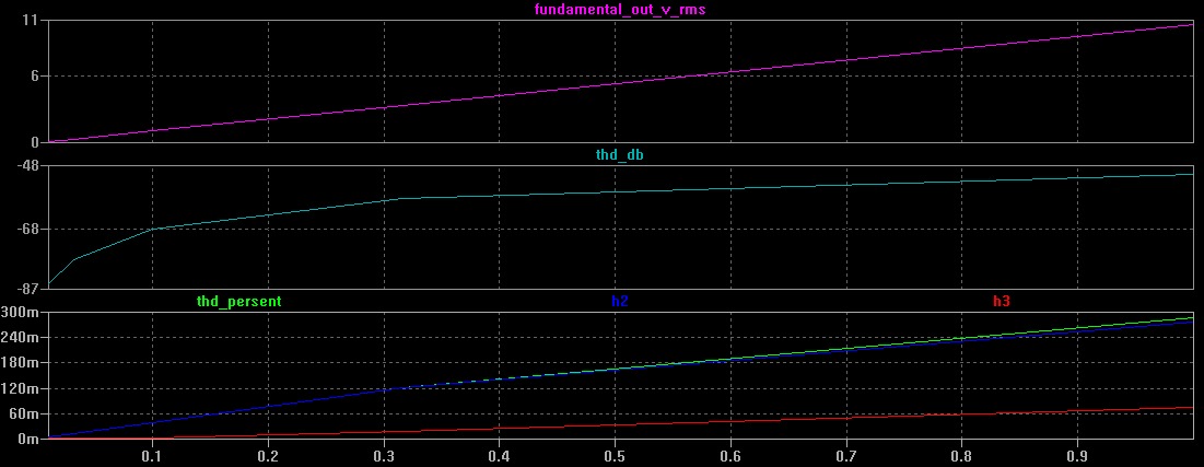

Hi, Eugene,
Thanks a LOT for so excellent and useful piece of software!
I would like to ask about data representation and interpretation of graphs (please look at the picture attached). Bottom graph is the most valuable total, 2nd and 3rd harmonics.
Input voltage of DUT changes:
.STEP dec param Ag 0.01 1.0 2
What I would like to display on 3rd graph is THD% = F(V_out). Yet there is something strange. X axis starts from zero and ends with 1. Does this mean input voltage?
Then, -51 dB THD = 0.28%
Looks like Y axis (on third graph), labeled with "m", is a strange notation of THD %.
Q: Is it possible to display graph THD% = F(V_out), or better just to export data to spreadsheet and draw graph here?
Hello,
Yes, your X axis is "ag" by default. Then 1V is your maximum setting of generator amplitude from .STEP command.
To change X axis to output RMS value, click on horizontal axis (on numbers).
You will see "ag" in the top tab. Change it to "fundamental_v_rms" and set corresponding limits in lower tabs.
In notation 280m=0.28, as soon as it is in present, 280m means 0.28%.
I was not able to figure out how to display preset notation on the scale in this case. That's why the name represents meaning.

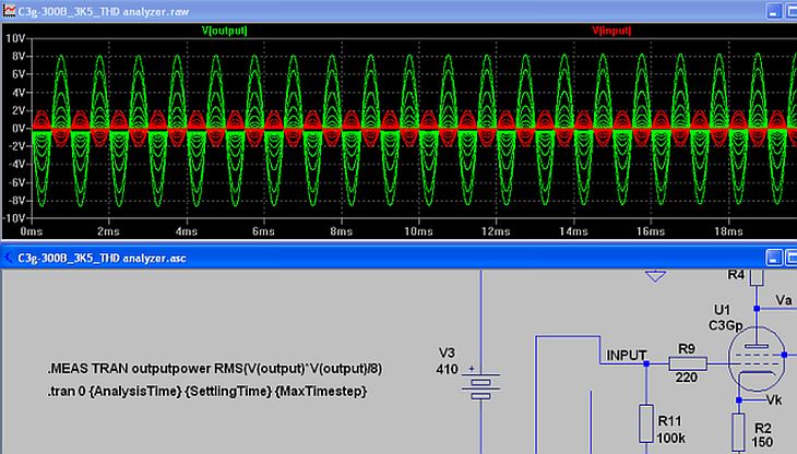

Hi Eugene,
I'm not an LTspice expert, only pre-breadboard user mostly.
If I put the directive for power measurement and outputpower as baseline, the resulting diagarams represent amplitudes THD and Pout THD. Is it correct?
Does my setup is correct, in general.
Thanks.
