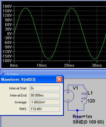

My suggestion is that you start with a simple power supply simulation.
Build a schematic first:
1) voltage source, sine, 0V DC offset, 120V amplitude, 60Hz
2) three inductors, L1 will be transformer primary, L2, and L3, secondary windings. Include a spice statement
k0 L1 L2 L3 0.9992
which basically connects the three inductors. To do that, click on the menu button ".op" (upper right hand side)
3) connect L1 with the voltage source, making sure one of the ends is grounded; connect L2 and L3 in series. The middle point is the center tap. See attachment for the actual values. The transformer will step up from 120V to about 300V.
4) ground the center tap of the secondary of your transfomer
5) connect two diodes at the two outer ends of L2 and L3, anode (triangle) towards the transformer, and the cathode (vertical line) together
For details, see the attached file. Load it in ltspice, and run it. Play with it, change values, etc.

ikoflexer said:1) voltage source, sine, 0V DC offset, 120V amplitude, 60Hz
LTspice treats sine waves as peak values so in order to get 120Vrms you need to enter in 168V as the AC voltage.
dave
