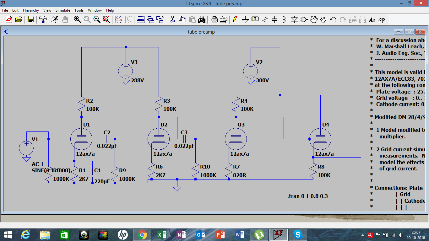

When I measure the signal in LT spice using the Ac Analysis for the schematic below I get 41KV coming out of U4. This seems to be impossible to me with a B+ of 300V. I am feeding the circuit 1V AC.
Using the Transient Analysis feeding it 1V at 1Khz I get an output of 300V peak to peak.
Does anybody know why there is such a discrepanty in outcome?

The classic .AC analysis card assumes Perfect Linearity. It does not know anything about "overload".
1V input gives the *Voltage GAIN*, not the overload. A better way to see this: 1mV in gives 40V out.
Yes, three stages of 12AX7 is likely to give gain of 40,000.

PRR is correct, .AC is a Spice small-signal analysis that linearizes the circuit around its bias point. When the signals are not small, the results are unphysical, but the ratios are still the same as for small signals (1 uV -> 40 mV, so 1 V -> 40 kV and 1 MV -> 40 GV).
