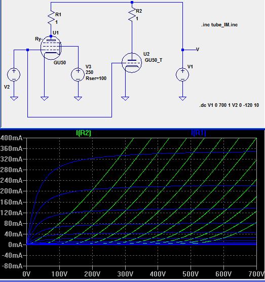

I spent some time looking for Spice models for the the GU50.
I managed to find some Russian tube models here, including the GU50: audioportal.su/showthread.php?t=7020
I am however not able to get the models to work in LtSpice.
It seems the tetrode/pentode models have the electrodes in a different order than the LtSpice symbols from DuncanAmps, and I do not know how to fix this.
More strange; the triode models seem to have the pins in the right sequence, but they do not work either. 😕

Update:
The triode model works.
Must have been a "hick-up" in LtSpice that showed wrong current, in the wrong direction through R2. Deleted and re-inserted resistors and it works.
For the pentode I have temporarily defined a new symbol with nodes in same order as the model.
Svein

revintage:
To create a symbol to work with the models in tubes_IM.inc, just open the existing tetrode symbol and edit the pin number assignment so that
P G1 C G2 correspond to 1 2 3 4. Make it look a little different, and save it under a different name.
Attached is the symbol I used (tetrode-Ry.asy)
Svein

Dave,
the error message you posted is typical if you use a triode symbol (3 pins) and a spice model value for tetrode (4 pins)
Svein.
