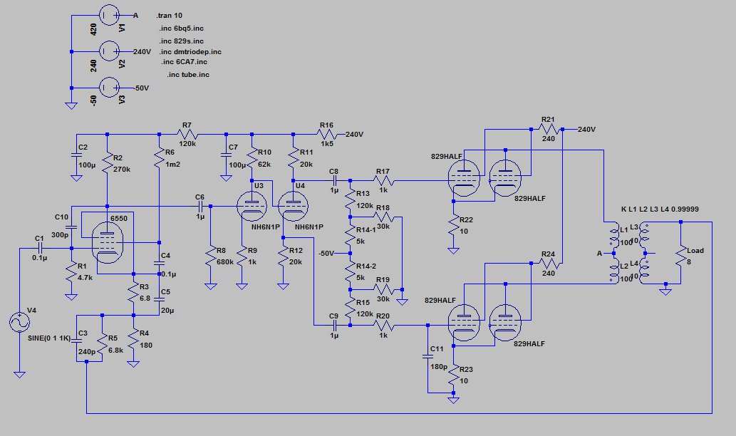

I've got most of my Priboi in LTspice, at least the important part. Anyone of you have models or parameters for the GU-19, GU-29, 6R3S ?
I am also try to make the Priboi transformer in there, anyone has some good strart values ?
At the moment I am making my teeth with the 829, seems to work. I'll try to make me a spice curve tracer unless someone has one ready to suggest.
The schematic is done, only the hard part of making the tube models is needed. It even runs, gives garbage results as the models are obviously wrong...
Later I could make the nice looking symbols for each of the tubes.
The transformer also has garbage values...

Hello do you still have the spice models for
GU19, GU29, 6R3S, i try to build a amp​
it would be nice .when you help me
