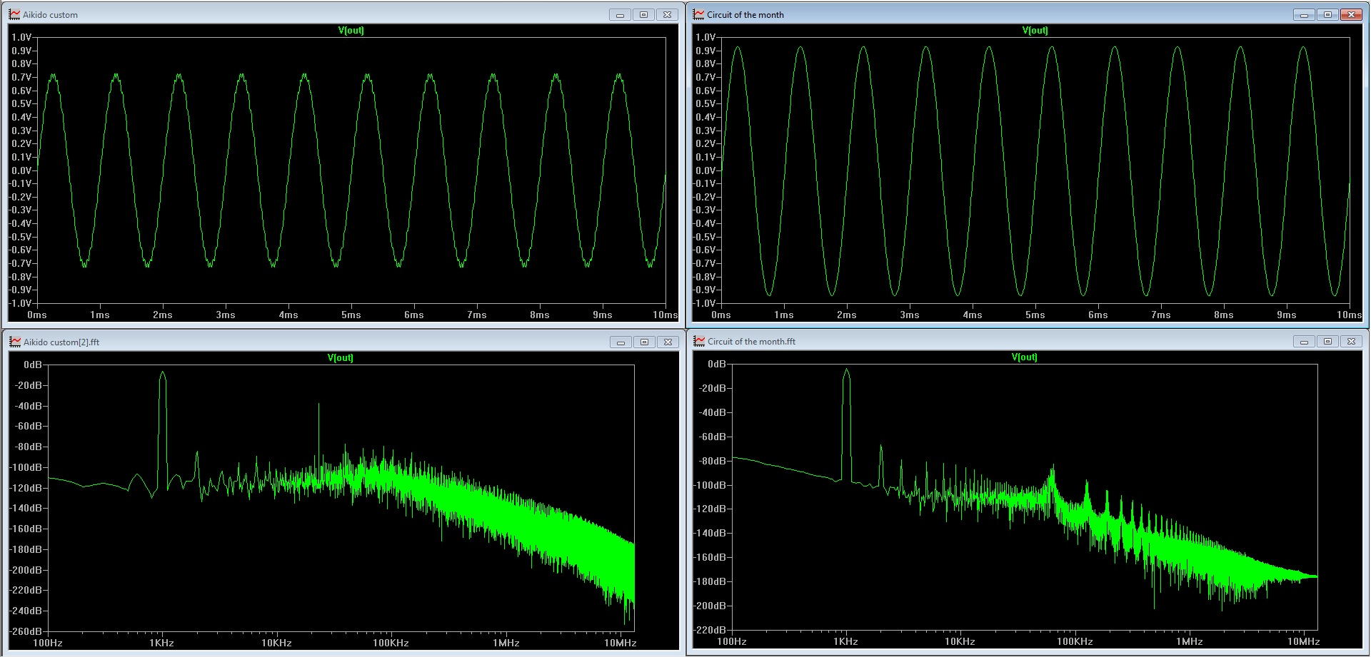

I've recently ran into something very odd.
The plots doesn't seem to match the fft?
Look at this and tell me what you see?
The left simulation appears to have a ragged response, really ugly.
The fft shows much better than the sim on the right with the smooth nice looking curve?
What am I missing here?
Ok, I'll give a hint...
The left sim uses a smps @ 23kHz while the right one uses idealized voltage sources.
Wich would sound better? Things like this makes my head spin.

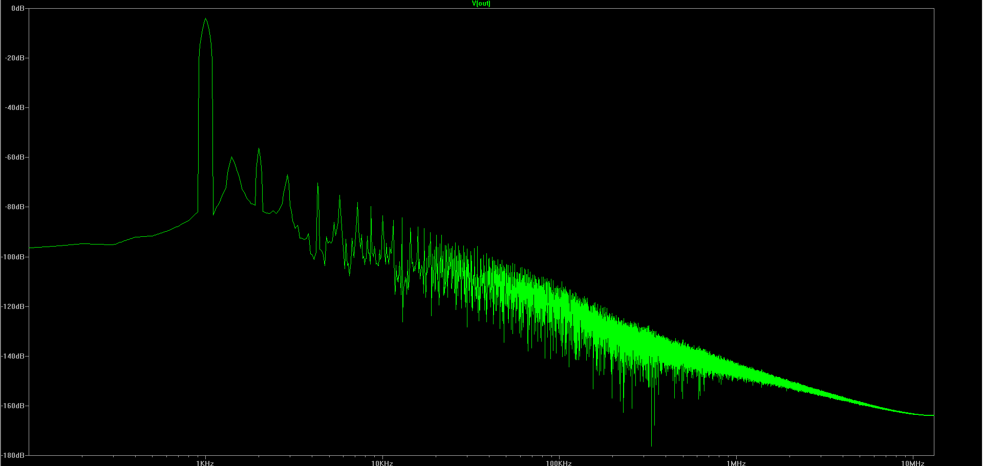

I guess I can treat you to another fft as well, this one represents the previous sim on the right but with a simmed smps @ 23kHz. (The smps model is ran with the tube circuit)
Would the superimposed 23kHz ripple be audiable in any way?
I don't have the right terms for it, harmonics or modulations of sort lower in frequency but generated by the switching frequency?
If the 23kHz ripple is harmless the left sim is one magnitude better than the right one, if it's harmful the right one (with a really good psu) might be a better solution?
(The plot in this post shows the worst of both cases, the right sim with a 120mVpp 23kHz ripple on the B+.)

the 23KHz could cause problems several ways, most "audible" will involve intermodulation distortion prodcuts which can be below the 23 KHz
try a 20 KHz sine with the circuit showing 23 KHz ripple - you will most likely see a 3 KHz IMD difference product, simialrly with 10 KHz

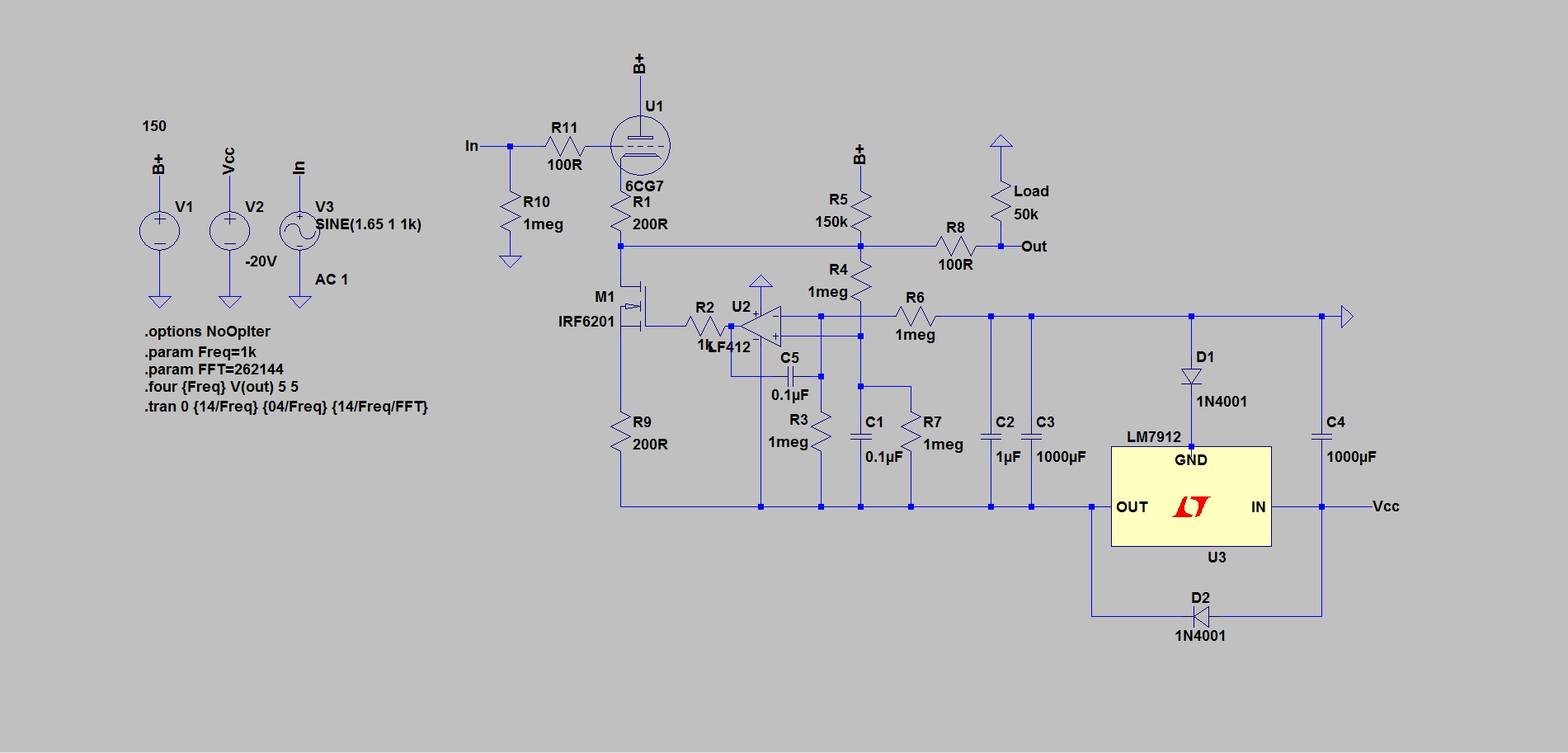

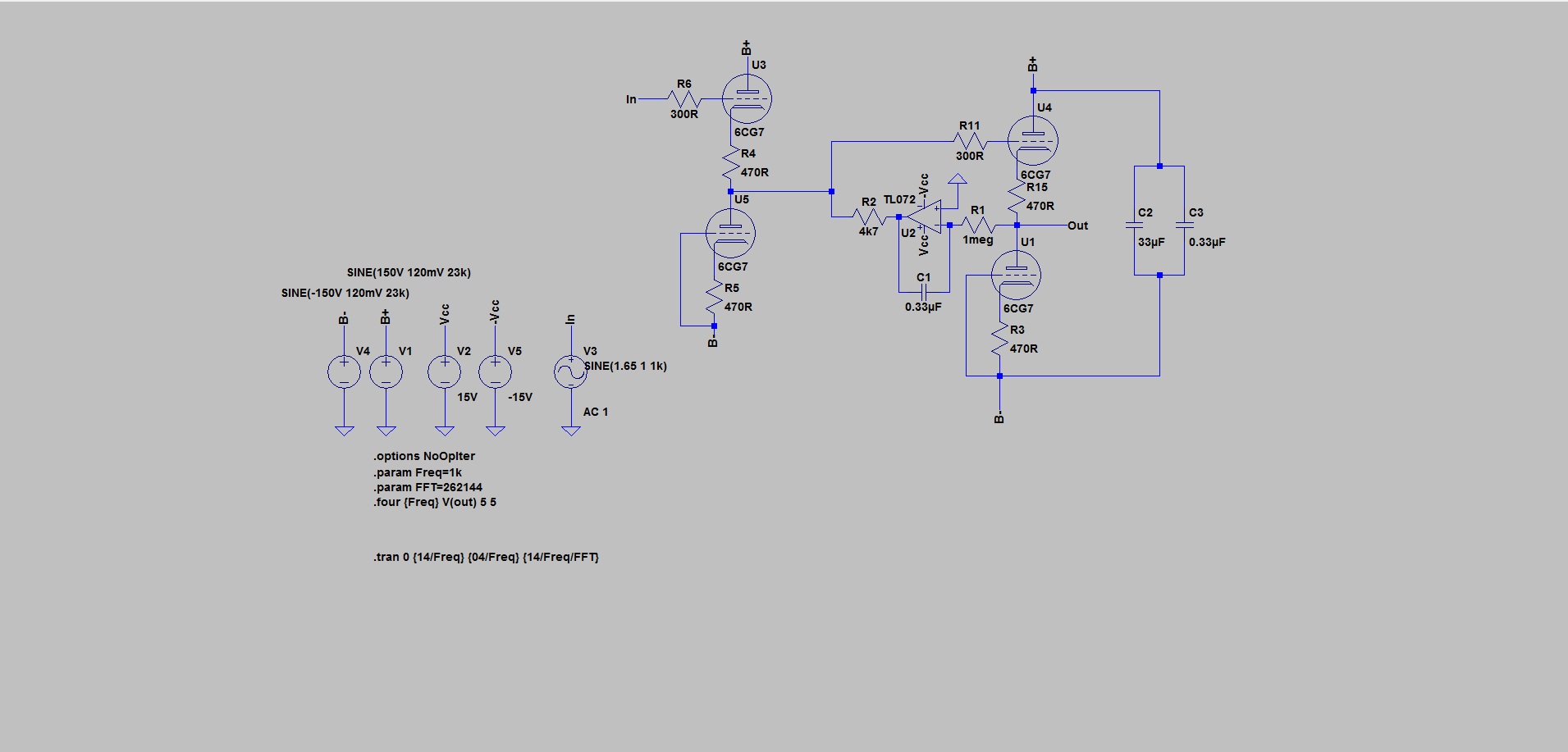

Here are two framegrabs for the fast sims.
If I run a full sim with the smps it takes a looooong time.
Like I said earlier, this is nothing fancy and definately not optimized in any way.
I'm almost a little ashamed to post these schematics. :ashamed:

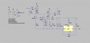

No wonder your thread got cool, your circuits are unrealistic:
Make the SMPS switching frequency ten times higher! 23kHz is a joke.
You have two high Zout CFs in tandem.
Also you must turn off compression ".option plotwinsize=0" for your FFTs to get useful.

As for the tandem CF's, it'n not even a circuit of my own devising. It's a ripoff from a respected electronics designer, I'm just toying with ideas to see what I can come up with.
A CF's input impedance should be in the megaohm range.
So what if the output impedance of the first sage is a little on the high side?
You might be 100% correct in it being a bad idea but it would be more helpful to explain why it's so bad.
I can live with losing some voltage, heck if I wanted a large voltage swing I wouldn't be looking at buffers.

Re: leftmost schematic your dc servo design is not good, it will significantly degrade the AC performance of your first stage - need to rethink that. Hint: That 4.7K resistor is part of the load for AC or DC signals present on the output of first stage, makes your current source quite pointless..
You could probably get good AC performance right down to 5Hz or so with a single tube and coupling cap without the complexity and the danger of unintended interactions possible with these designs. Sometimes the best circuit is the least complex one that will do the job whether or not it has a coupling capacitor in it somewhere.
