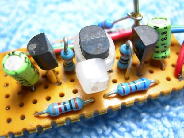

Then, if you put each pair Body-to-Body contact,
you have made close to a 'perfect' dual transistor.
See my attachment, what I use instead of glue (some glue will attack plastic!).
If you wish, you can add silicon thermal grease compound
http://en.wikipedia.org/wiki/Thermal_grease
but I do not bother with it. Just good tight mechanical pressure works good enough for me.

Hi!
This is another of my original audio ideas.
When I use this way to attach and mount one LTP, long tailed pair,
I will get the pcb layout to correspond to most amp schematics.
You put one BC550C with legs to LEFT and the other with legs to RIGHT.
C, B and E will be logically situated.
A matched pair in body contact, for good thermal tracking, is supposed.
Regards 🙂 Lineup

Not so good idea ... you will get an asymmetrically temperature gradient
yes, true, a bit 🙂
But if you test it in real life, you will see it is no big problem.
There are many theoretical assumptions, ungrounded fears
.. that are of no deal when it comes to practical reality.

One other feature I did not mention:
you get both collectors at V+ side and both emittors at V- side.
So most of the time you can easily make short tracks for supply.
regards, lineup
regards, lineup
Yes and no ... one bjt will have longer pin conections
This is no problem for me.
As I use hardwiring, when doing 'critical' circuits.
for normal audio, roender, I can asure you,
you won't be able to measure or hear anything
by using the construction in my last picture.
Regards 🙂 having no fears & anxiety, when doing audio, Practically

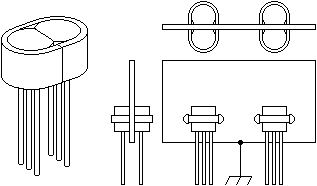

Better stilll,
is to do like I have seen in hifi amplifiers
-> wrap both transistors with a copper-housing
elektor projects have used:
copper tubing (usually for transporting water in houses)
with an inner diameter close to the diameter of 2 TO-92
you cut like 8-10 mm of such a copper tube
then you slit the tub open and put around those transistors
and press the copper to 'grip tight' the transistors
I could show a drawing of it, if you need.
There might even be pictures around of this way.
Edit:
I found an image, in a very good article!
Regards 🙂 lineup
