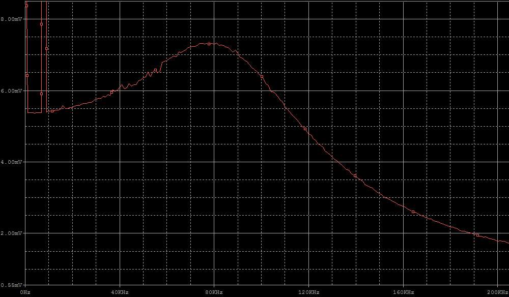

Tim_x ! do you try use this way to compensate your amp?

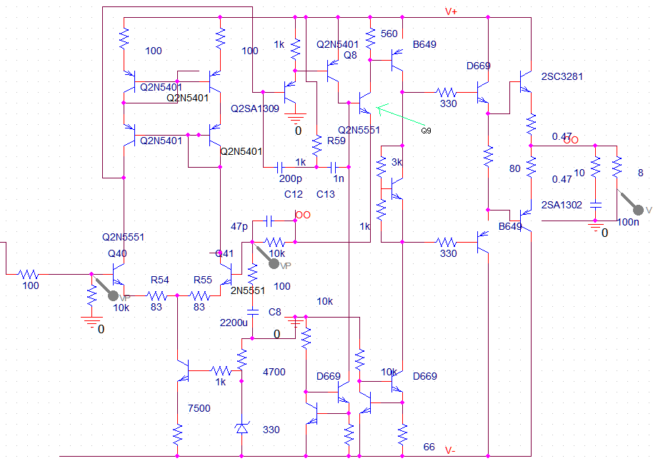

my view of this is that it can be viewed as two amps in one: the first consists of the LTP (Q1+Q2)+ associated VAS (Q3+Q4). This is very much an opamp.
the 2nd is a JLH-styled follower, consisting of an input stage with current feedback (Q7), its VAS (Q8) and an EF buffer / current amplifier (Q9+Q10).
If it is really for a headphone application, either one (with minor modification) is sufficient.
high feedback designs sometimes have poor overload recovery; with the 2 pole compesation I used there were massive bursts of oscillation in clipping - the baker clamp is just the first layer of taming bad clipping behavior, at last count I was diode clipping 3 nodes, added a current limit transistor and series Z in the vas to limit output V sat currents to survivable levels
V gain in the output stage is very useful in distortion reduction, following Cherry's argument distortion from a stage is reduced by the gain between it and the input - the classic feedback aproximation. but it turns out that the reduction in signal level due to gain beween a distorting stage and the output is the more powerful distortion reduction mechanism (for 3rd order and higher nonlinearities) so maximizing V as well as I gain in the output stage is very profitable

your values for the 2-pole compensation are not the best for the vas, with a high impedance output drive you want to minmize the load on the output where the load shunts current to ground and is "throwing away" gain - I think you will find that equal value C is more efficient in this sense - just double the required high frequency stabilizng Cdom value to get the new value for the 2 series caps
if you can extend the compensation loop to include a output buffer stage then the higher C load on the output you show is good because it minimizes the C seen at the compensation network input
This is my amp !Amp can only work with C12=200p ,C13=1n . If its values is smaller , amp will not work . Although amp can work , there still has thumb sound when I turn off power => amp still ocssilate .
If C12 is smaller than 100p , ltp+cfp will defeat Blameless ,distortion is about 200uV-300uV at 25V output voltage
If a compensate cap is use for CFB stage , amp will also ocssilate . It is hard to know why a compensate cap cause ocssilation .
A cap from collector of Q8 to -input will also cause ocssilate .Perhaps only Leach can use this compensate method 🙂
Using a resistor at emitter of Q9 will produce a noise quite much . It is to easy to hear although volume is set al low level . Perhaps this resistor decrease gain of Q9 and cause RF exist in amp .
Current amp still has sound from Radio stations if volume is set at high level .
