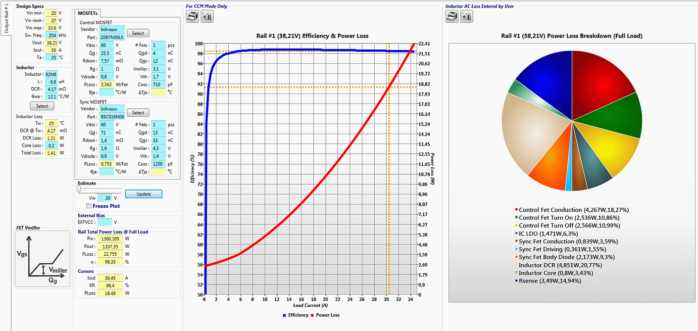

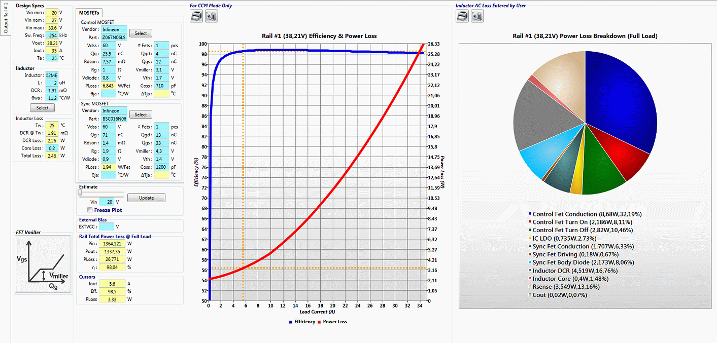

Simulations are done for 1000W cont. load:
2 phase:
4 phase:
Initial design parameters:

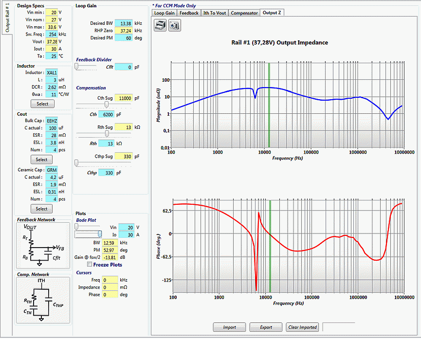

regulation loop bandwidth > 10kHz

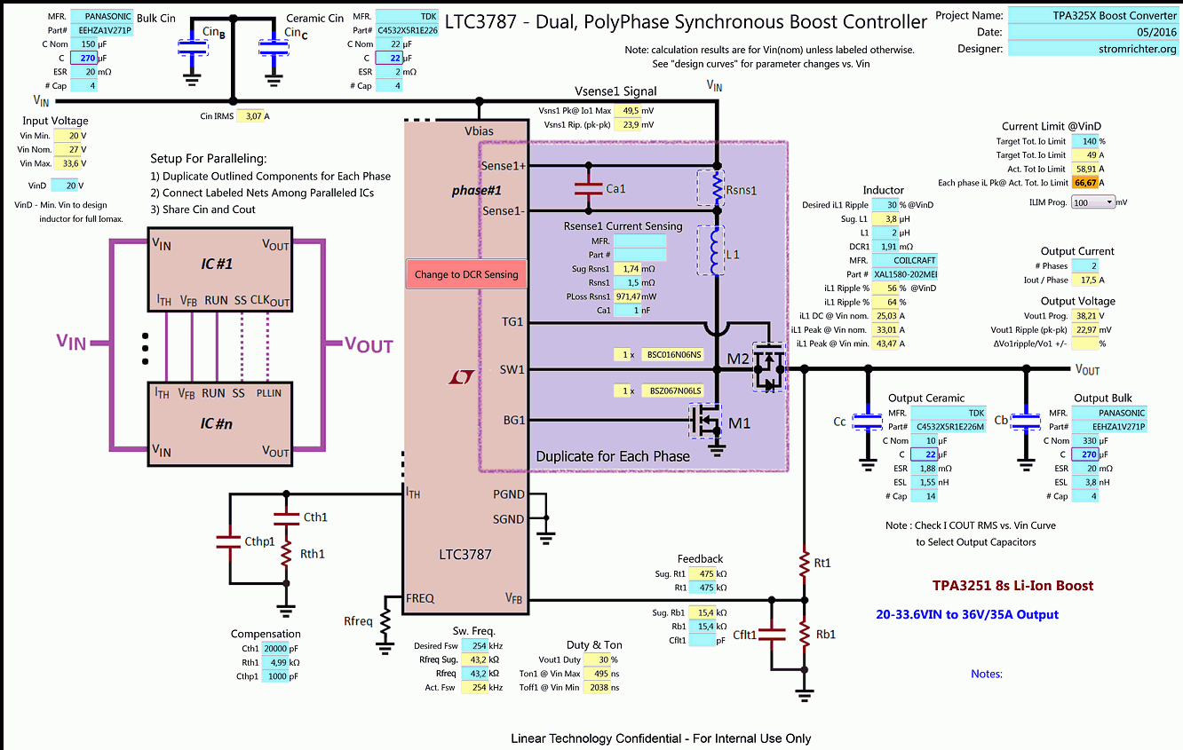

4 phase operation for 12V SLA battery input with up to 30A per phase
2/4 phase operation for voltages greater than 24V like SLA in series or lithium battery packs

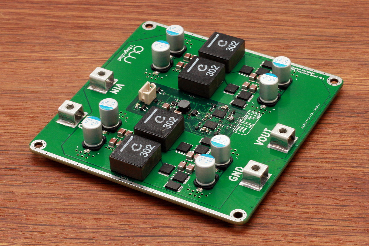

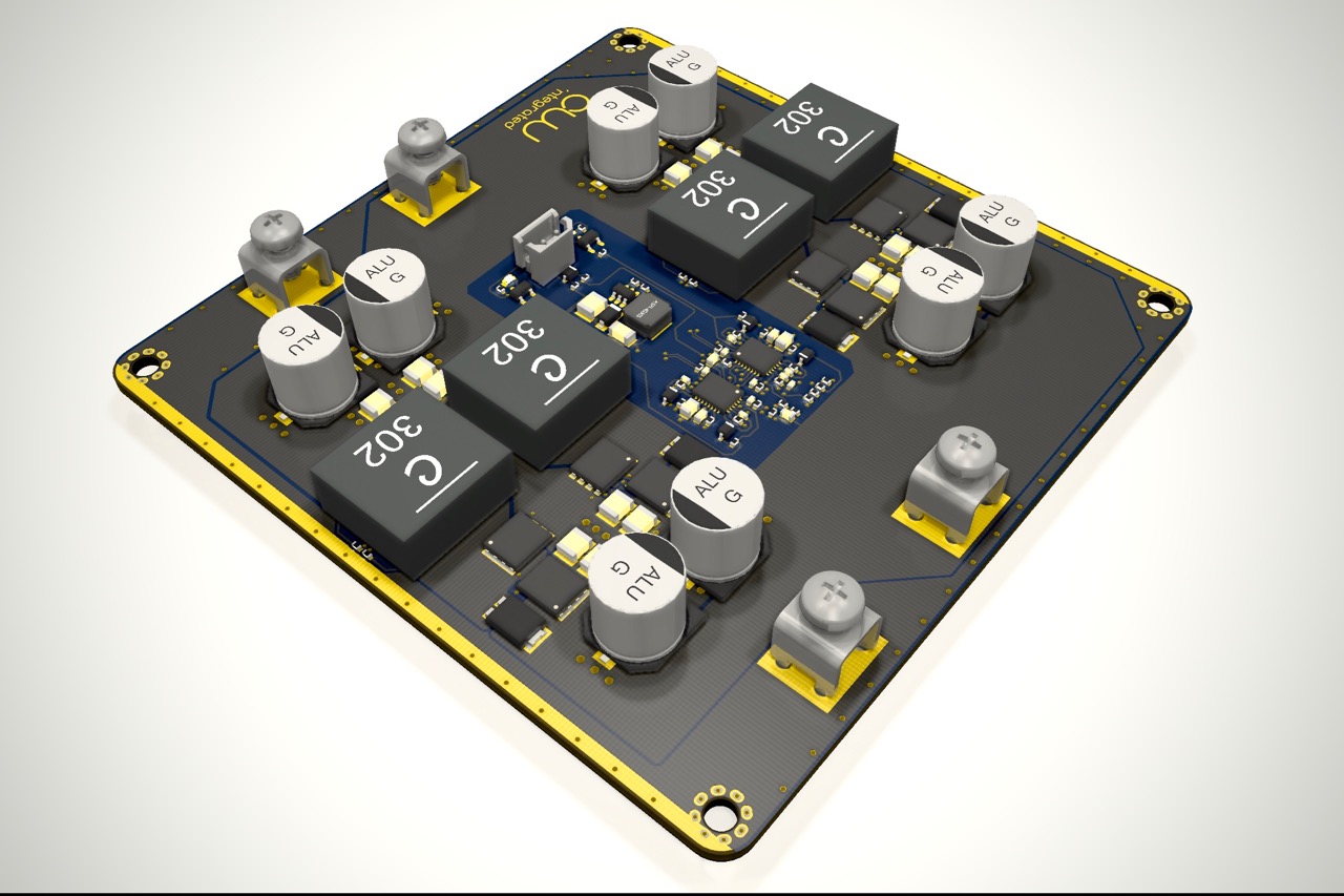

The PCB is a 4 layer board with 100*100mm in dimension. The design is finished and several use cases are available for simulation in LTSpice and LTpowerCAD.

This groupbuy is for a bare PCB with schematics, BOM and assembly instructions. I want to order a minimum of 10pcbs but actually need less so thats where you can jump in.
For the first run i'd order standard 1.6mm, 4 layer, 1oz, green silk board with HASL. The price for one PCB is roughly 7€ then. If there's enough interest, we may order ENIG (2oz.) boards with Red or Blue silkscreen.

The design is practically untested (as usual for the first run), so their is a small risk that some things need manual patches. Having said that, the implementation is working in simulation (LTSpice, LTpowerCAD), so the chances are high it works out of the box. Things need tweaking are regulation bandwidth and compensation.

Actual digikey BOM cost is at 100€+tax. Simulations do look fine for 50V output voltage at 23A load current stepped up from 10V input voltage. (draining ~123A from the battery)

So, in the end they found together, TPA3255 2.1 100x100mm system in direct contact with the 1200W 4-phase LTC3784 boost-converter board, making it possible to go the distance with even only having 10V at the input to put out 600Wrms. As this asks for 1200W power into the amp and an realistic efficiency of 92% from the boost converter, this setup is asking for 130A at the 10V input. (Things get much easier when using a 36V supply) For the AFE module and bulk caps there is a mounting holder within half of the height to make good support for stability while driving with the bike. The whole thing measures 110x110x70mm, i'd call this a power-brick.
