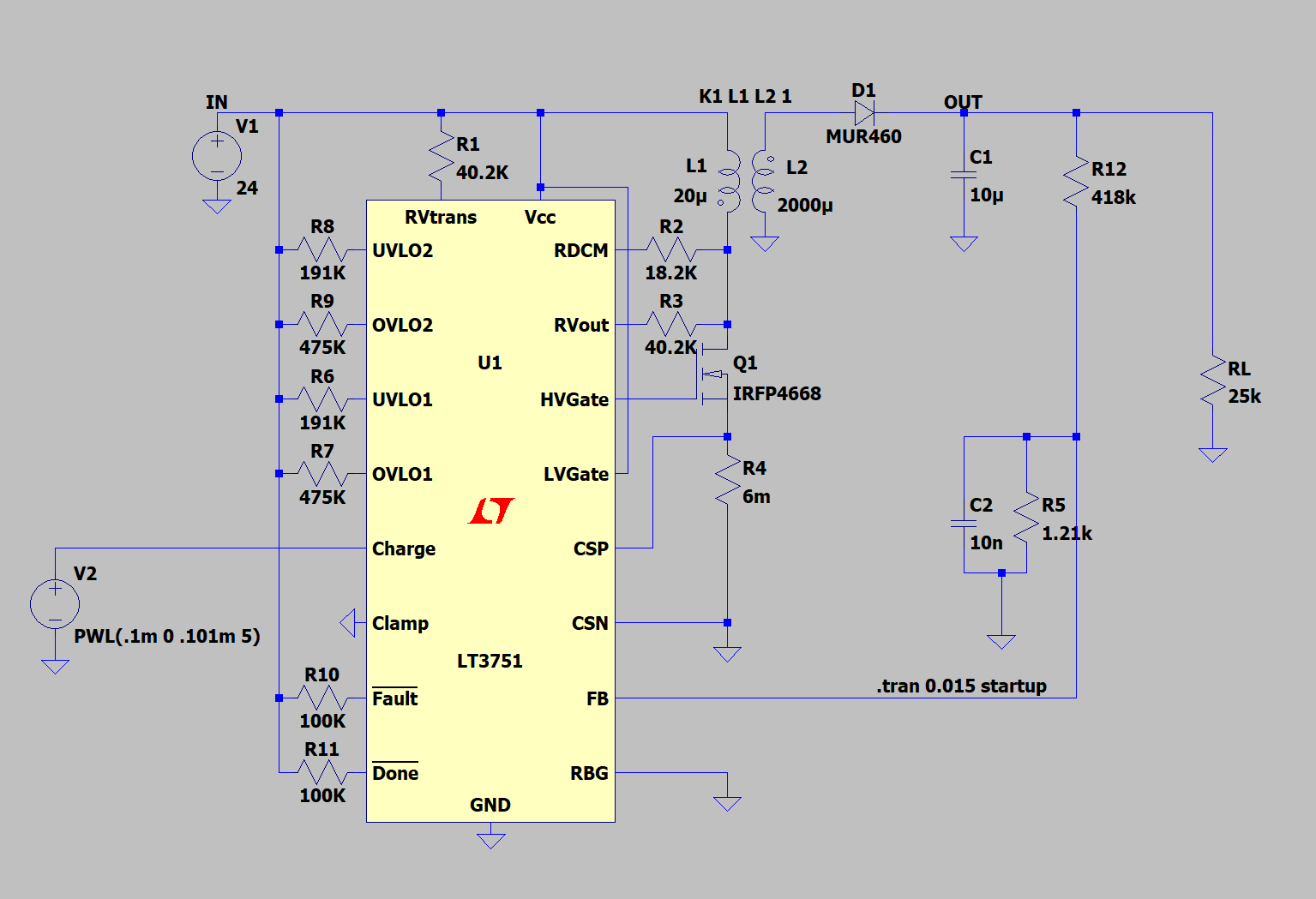

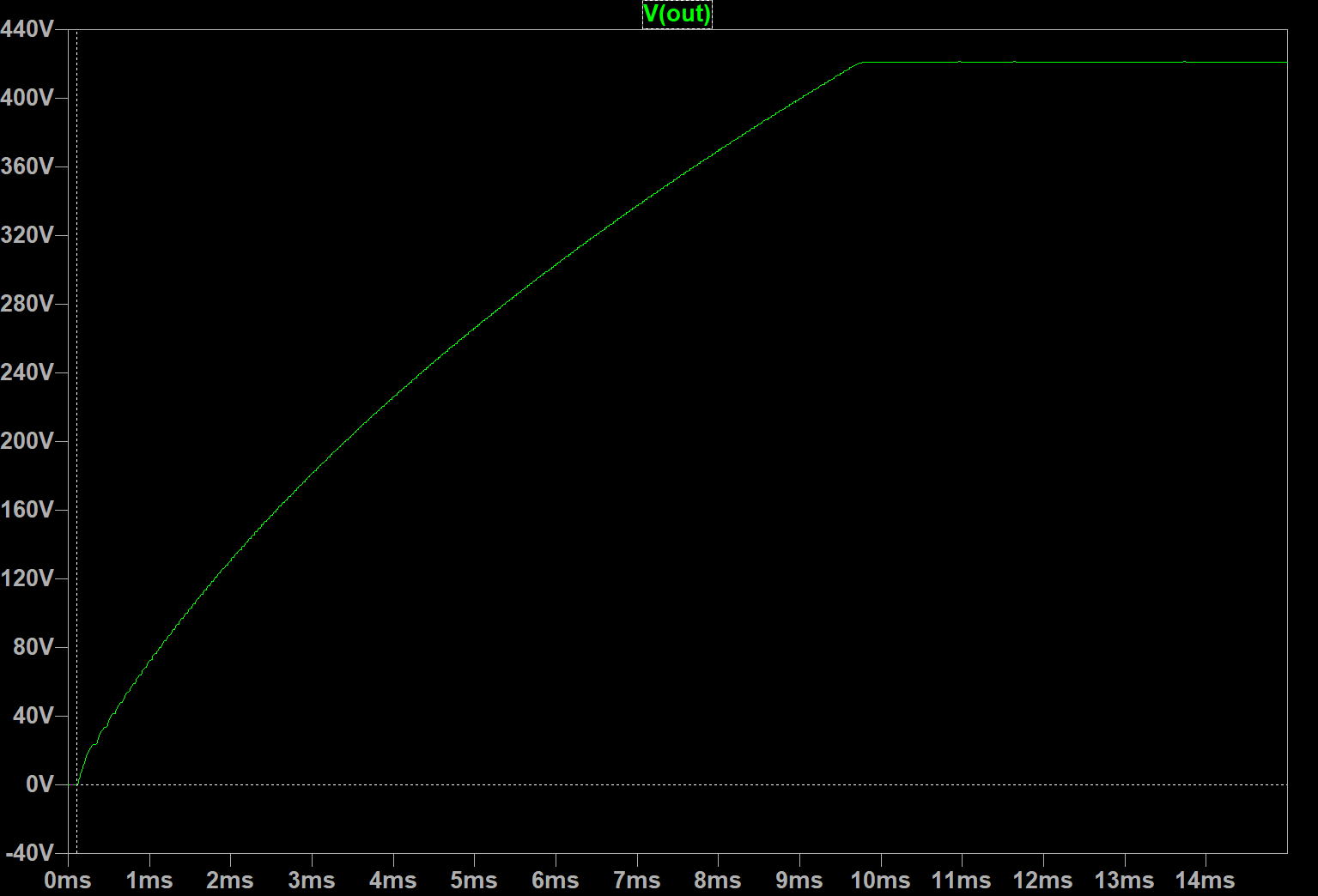

1) The LT3751 package (TSSOP or DFN) has a Pin 21 on the underside of the chip which presents an obstacle for using it with a TSSOP-to-DIP adapter to test it out on a breadboard. LT3751 Datasheet and Product Info | Analog Devices Any way to get around this without designing a custom PCB?
2) Have you tried using this supply in an audio amplifier(s)? If so, was it quiet compared to other power supplies you have used?
3) Has anyone been able to simulate this circuit based on the schematic in the first post? If so, can you post the updated file?
