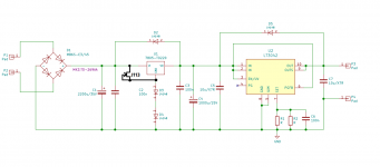

I don't see 0.8 uV noise LDO regs too often ! Seems like a worthwhile and affordable ultra low noise PSU for various purposes so I ordered some PCB's. Difference in specs with TPS7A4700 is spectacular IMHO. Here is a chance to build a true DIY non commercial ultra low noise board.
I wish the designer had pumped a dozen milliamps through the 2-diode "ground offset" mechanism in the preregulator. Get those diodes into a regime where their dynamic impedance is LOW. Here I show a JFET CCS doing the dirty work. You'll note I eschew the Walt Jung connection where the regulator pulls itself up by its bootstraps.

Or just leave out the prereg and use lower input voltages by choosing a right transformer like a 5V AC type. With a carefully chosen transformer losses can be reasonable. Only when using let's say a 12 V transformer for 5V output the prereg can be necessary depending on current. In my book choosing a 12V transformer with an ultra low drop 5V LDO is somewhat off 🙂 From the Vi to the Vo pins a coil can be soldered instead of the 7805.
Or use jumpers for the diodes and use a 7806.
The prereg only seems to be there for versatility purposes. In the words of the author: 78xx as a pre-regulator, to reduce power loss on the LT3042 and to increase the max. input voltage.
