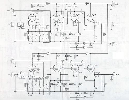

I want to know something about the DIY LS37 from Lite audio,
this tube phono has MC/MM input. but when i use MC the gain
is to high. How can we lower the gain?
see drawing
Providing readable schematics would be a good start to getting some help 😀 :smash:

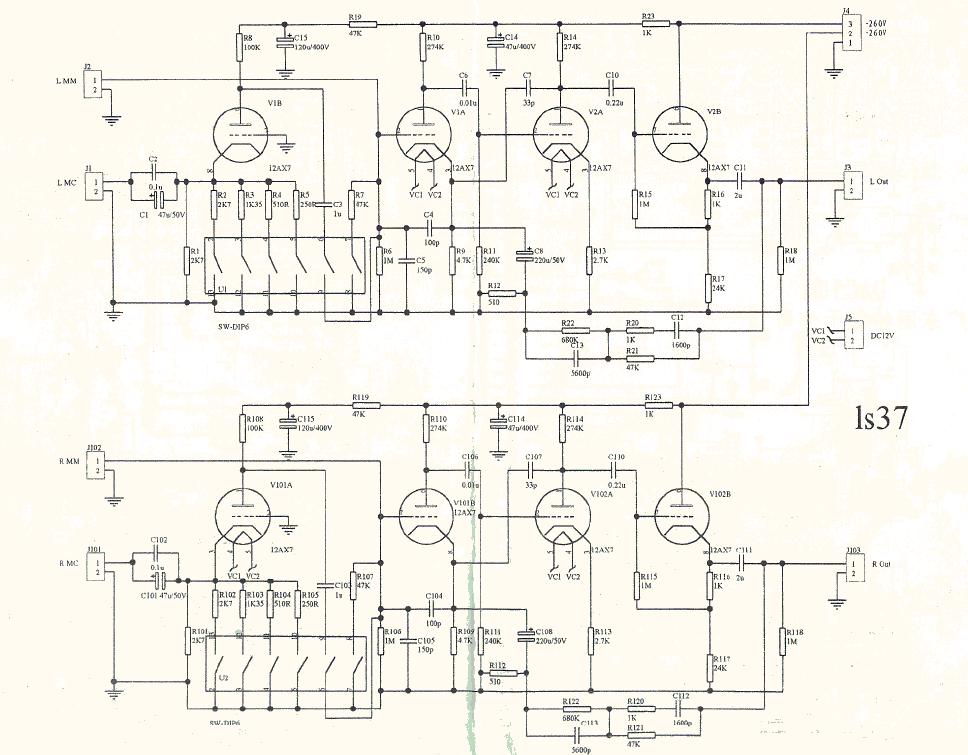

This pre makes use of DIP switches to set gain for the MC input. How are you setting your DIP switches?
