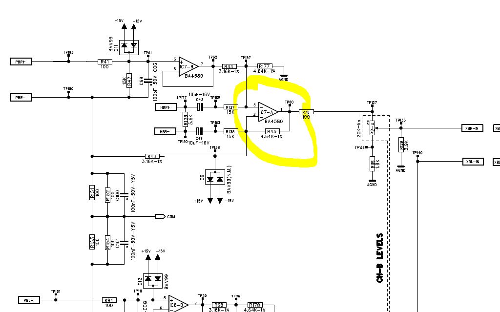

Channel B right has a noise. I replaced OP AMP at the input stage but the noise is still there. if this opamp is removed the noise also gone. Any suggestion? thank you!

which OP Amp? from where did you move it?
is this OP Amp at the Input stage or Filter module? where?
When you move out IC7 it move 7A & 7B. 7A is the RCA pre in 7B is the HI-Power pre in & buffer out 7A. is the noise is pops,hiss? move diodes D9 & D11 and see if the noise still there also try to check the capacitors around.
