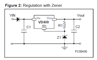

I was looking at data sheets for the LR8 high voltage/low current regulator IC and came across one for the discontinued VB408. In that data sheet I found an interesting little circuit (attached).
Like an LM317, these regulator ICs set their output voltage with a voltage divider from the IC OUT pin to ground, with R1 from the OUT pin to the ADJ pin, R2 from the ADJ pin to ground.
This attached circuit, instead of using an R2, uses a zener string to set the output voltage, retaining R1. The value of R1 needs to be chosen to supply necessary current to the zener string, maybe 10mA. The LR8 only needs minimum 10uA from its OUT pin to its ADJ pin.
The data sheet says,
The output voltage can also be set by a zener diode put between the adjustment pin and ground (Figure 2). The biasing current of the zener is properly chosen by R1 resistor. The zener diode improves the ripple rejection and reduces the value of the worst case output voltage error. In this case the output voltage is given by
Vout = Vref+Vz
I'm sure this can be done with an LR8 too. A string of four 75V zeners and one 51V zener should get Vout = 350V.
The expected load on the LR8 would be 35V dropped across it (385V input, 350V out) at 7.5mA, so 263mW dissipation.
Stupid idea?

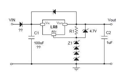

From what I can tell (and bearing in mind that I'm an uneducated tinkerer, definitely not an electrical engineer!), it looks like
1. Since the LR8 is rated for 450V at up to 10mA, popping it because of high voltage is not the problem if the raw supply is about 360V. (Unlike the LM317, which is limited to 37V In-Out.)
2. Reverse voltage would be an issue. The LR8 data sheet shows a 'typical application circuit' with an unspecified diode in parallel, with the diode's cathode to the LR8 IN pin and the anode to the LR8 OUT pin. Would that need to be a rectifier like a 1N4004? I don't see why a zener would be necessary as is needed for the LM317.
3. I'd think a lot of ripple voltage at the IN pin could zap the thing. The raw supply to IN should be well filtered. That's not a problem.
4. Too high value capacitors would be a problem though. The data sheet recommends only 1uF on the output. It doesn't mention anything about capacitance from IN to ground.
So, with an LR8, would this (attached) be enough protection?
(Is that series diode to the IN pin necessary? I never see that used...)
PS: The intended application is the B+ for a single 12AX7 drawing 2mA plate current, and a MOSFET source follower drawing 5mA, for a total of about 7mA. The raw HV supply could be as little as 360V. The desired Vout is 330V.

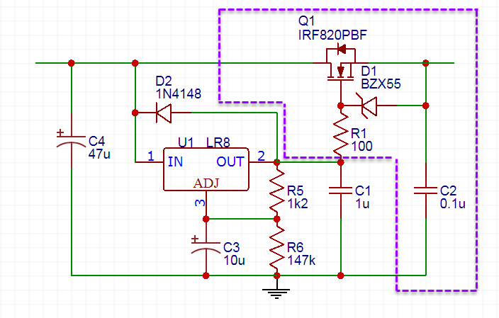

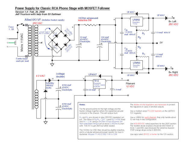

I read this article about using an LR8 with a pass transistor. And then used a version with a mosfet to provide 320 volts DC to a preamp and crossover that uses 4 6SN7 tubes.
Works very well.
Steve
I'd use a 1N4007 diode instead of the 1N4004; same price, more voltage.
The input diode could make the circuit discharge more slowly on power off,
perhaps it would be more reliable that way.
Thanks Steve.
In that circuit, it looks like the LR8 is set to 150V at its OUT pin, and I guess the IRF820 is stacked on top for the additional 170V to make the 320V output?
Four 6SN7s would draw something like 20mA to 35mA of plate current. The article mentions the described circuit to be good for up to 100mA. I'm not asking the LR8 to do anything near that. Only 7mA, max.
The zener string would provide a 'stabilized' voltage, and then the LR8 sits on top of that. I figure that could be a pretty effective and very simple circuit for a high voltage/low current application like a plate supply for a single 12AX7.
Question:
Is a diode necessary in parallel to R1?
If so, what kind?
My (limited) understanding is that a diode across R1 is only necessary if you add a capacitor from ADJ to ground (to increase ripple reduction). I wasn't planning on adding that cap, since I'm more scared of popping the IC than I am of ripple noise. The supply will be well filtered by the time it gets to the LR8.

I said I used a modified version of the circuit to produce the 320 volts. The circuit shown was the one that I modified. In my case the voltage drop and current requirement was so low that I did not need a heatsink on the mosfet I used.
For a single 12AX7 my version is probably overkill.

I agree. I use the form of circuit you mention for supplies greater than 400 volts.
The line voltage to my house fluctuates by 3 or more volts when large power draw appliances are turned on. 3% change on filament voltage is probably not significant. but 15 volts on screens and plates may be.
The combination of the LR8 and mosfet created a well regulated low ripple power supply for the preamp. The zener string and mosfet did something similar for the power amp.
