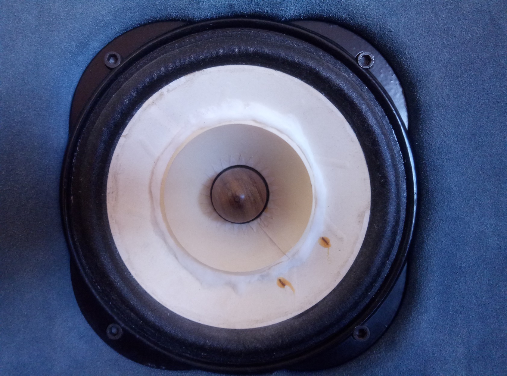

I found some time ago a couple of JBL fullrange, a signature D208. One was scratching, the other had a broken cone, both with damaged dustcap.
I restored them, new spider and new surround, and I bought a pair of titanium 2" tweeter diaphragm to obtain a dustcap.
The question is that I'm very doubtful on which kind of adhesive can I use to assembly the dustcap to the voice coil former. Everything is ready to work, but I have to resolve this last step.
Please have you any kind of advice about this argument? I'd like to transmit as more information as possible from the paper voice coil former, the speakers sounds good to me and I have no limitations in restoring, I don't want to reach a like-as-new pair of JBL 208, I just have to try if I have found a more adeguate speaker for my mix.

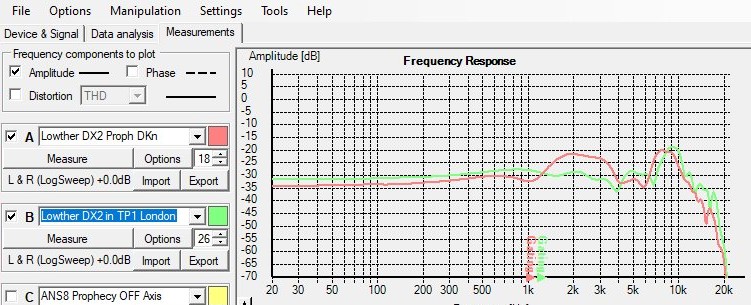

Here's the frequency response I measured of a PM6C in an infinite baffle, a DX2 and the PM6C in a Lowther TP1 horn.
attachment.php
Lowther units are made for different applications in different acoustic environments so one has to buy the right unit and use it in the right way.

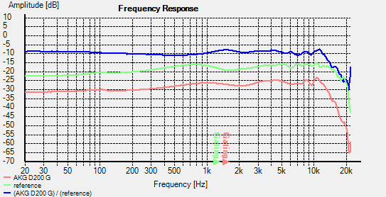

I've been measuring microphones so have needed as flat a speaker as possible. The green line is a Tannoy 611 measured with a measurement microphone.
attachment.php
(I've been measuring responses of AKG D200 D202 D222 and D224 mics and others)

With regard to the enquiry above and the adhesive to use on a dustcap, if one's got one unit with a dustcap and one without, then measure it on and off axis, and try a phase plug too. If gluing a dustcap I'd use cyanoacrylate, superglue. It can be undone with acetone. For other things I use Copydex, a latex glue that can be peeled off if necessary.

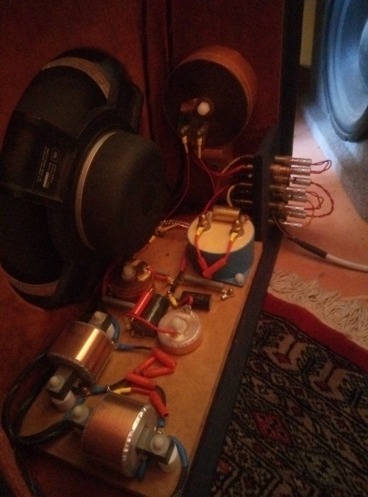

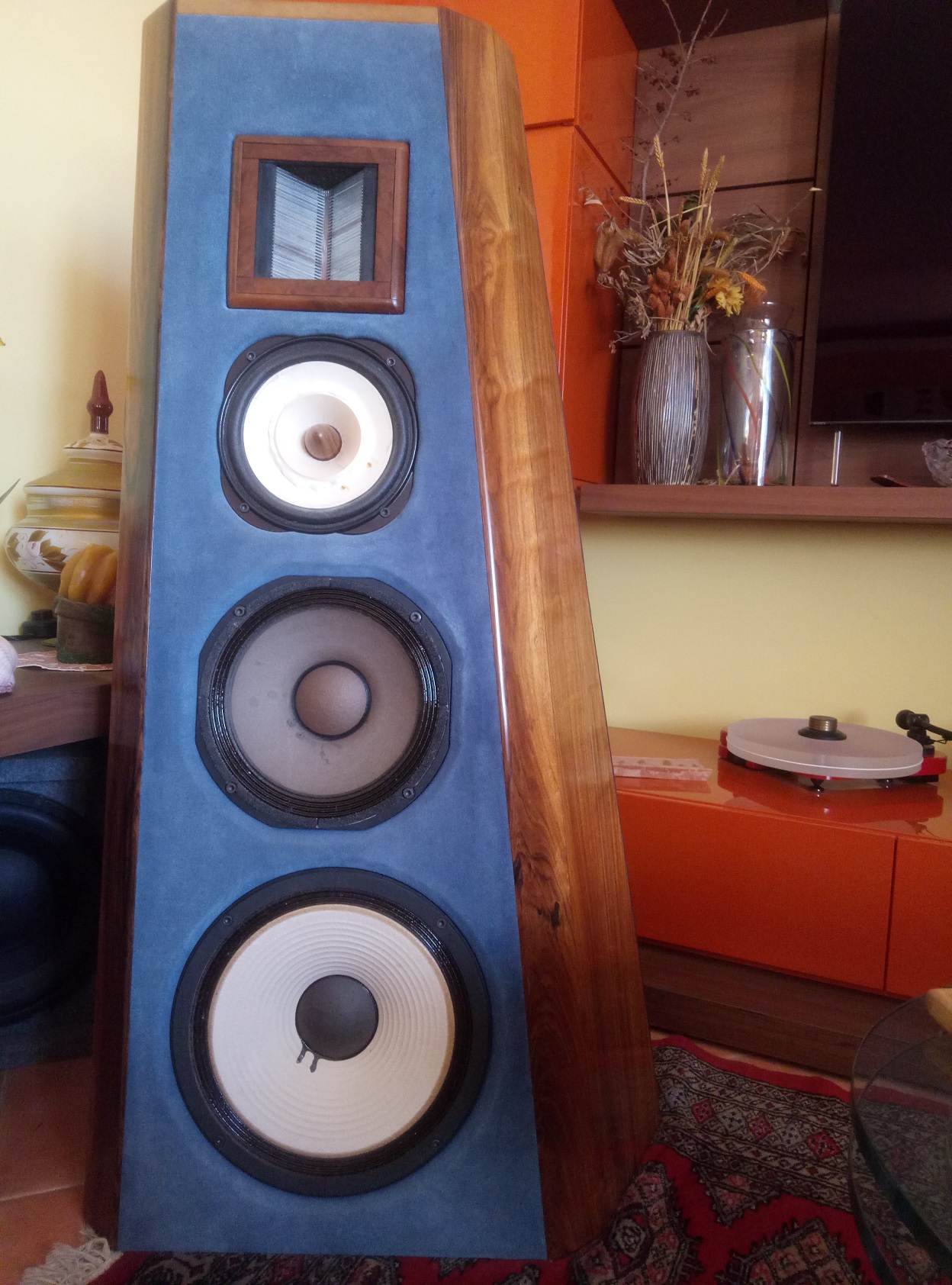

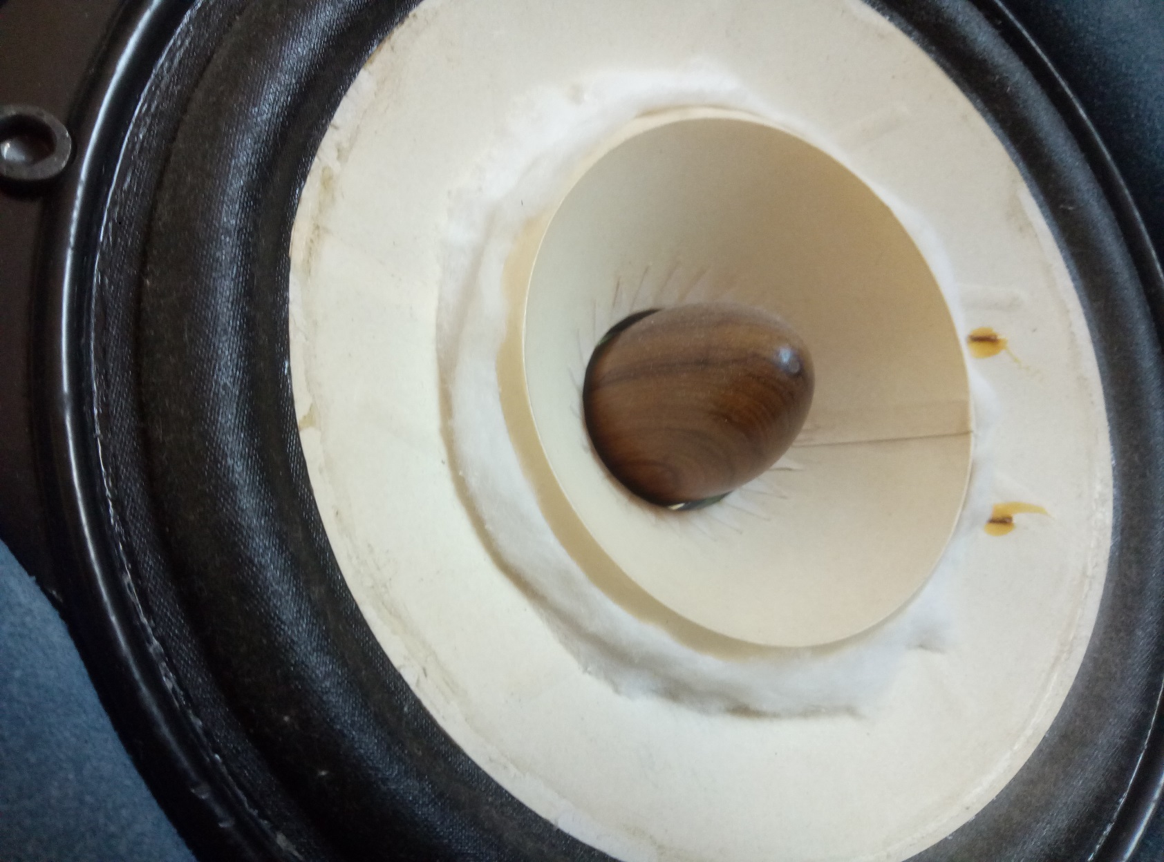

Some photo of my main system, a quasi-fullrange based one, with AMT1 as energy filler and inductance compensation (it's a practically pure resistive load) in the last octave, and a couple formed by a JBL 123A and an Altec 408Y in series from 150Hz to down to the lower frequency of the dipole (about 65Hz).
From 65 to 16 works a couple of sub with Adire Shiva in transmission line with internal path non-squared section (IMF like). Some photos to have an idea of the work, especially of the compensation net I spoke about.
Surely I'll try other material for the cotton ring, not because it's ugly to see (who cares? I have to listen, not to view a picture) but because it slightly moves itself during reproduction, especially at higher pressure level. ...Maybe a light memory foam?
Massimo

For whizzer damping (the so-called 99-cent-Lowther-modification) I use stuff called Soudal Kompriband (Soudal Kompriband Soudaband Fugendichtband Quellband vorkomprimiert BG1 | eBay) to good efforts. Weight is small, I cut off the gluing portion and stuff slightly between cone and whizzer, it stays there. Effects are measurable and listenable, but are twofold, reduction of resonances by damping will reduce detail and percepted subjective speed as well.
These whizzer resonances may, as you´ve done it, also be reduced with a passive circuit or dsp, but even if successfully reduced in level, they´re still there. The obvious solution is to do away with the whizzer or to use a petal whizzer, in order to avoid the single whizzer reflection at it´s end and to distribute resonances over a larger area and thus reducing their level. The roll-back of some whizzers is also a form of damping, like a rubber suspension damps cone resonances, and can be overdone with the same likeliness...
