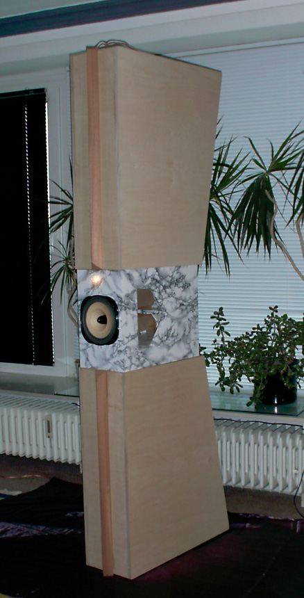

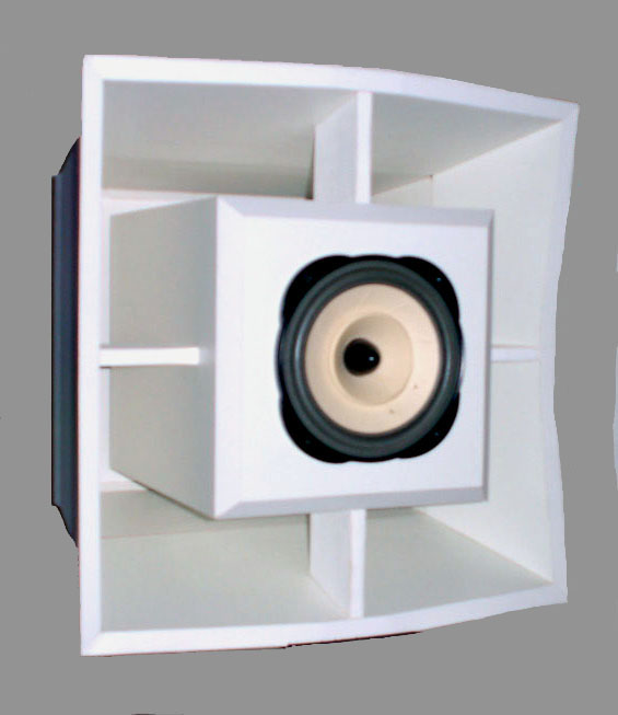

crazyfrog,
"another "hot" set of speakers with PM6A "
Yes, my experience show the lowther work "only" in a satellite horn down 100 Hz,
fill up to ~600 Hz and reduce the stroke, a good sub is needed.
look my sat-horns
crazyfrog,
look my sat-horns
crazyfrog,
look my sat-horns
Wow! Looks like marble in the second speaker.

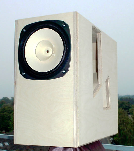

Papa, I'll throw in the KEF Q100 drivers in there for you to try as well. I recently built a pair and they throw an enormous soundstage and are extremely good sounding. You can buy a pair of the Q100 bookshelves and then extract the drivers.
Nice summary, btw 🙂 I'm glad I happened upon it.
