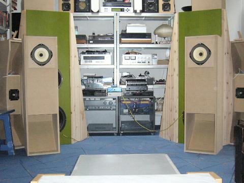

Now I have them, a couple of DX3's, for a decent price.
They are from 2005, so I think they have new whizzer cones.
I had never heard them before in my live so I was curious about their sound.
I quickly build some, oversised( see pic), Voight pipes, to get an idea of the sound ..... and they are AMAZING !!
Never thought a unit to be that good!!

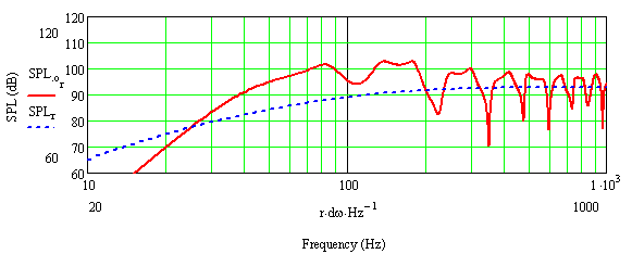

Digital Eq can do fine too, although the main issue with these boxes is LF transient handling due to their limited excursion, so it depends what's needed.
The DX3, looking at the measured T/S parameters Martin has on his site, and those Lowther recently sent me (for an unrelated purpose) should do fine in Sachiko, if you can cope with the size. There are a couple of build threads on this forum IIRC, & some recent remarks in the main Spawn thread here. Jeff Carder also builds & sells them commercially (renamed as Madison) using the FE206E -seems to get positive comments -FWIW, this is what one of his buyers left: http://forum.audiogon.com/cgi-bin/frr.pl?rspkr&1206563498&read&3&4&

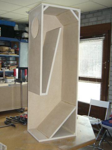

Hey Scott, you said nothing on the Frugal Horn site is designed for the Lowther, but isn't the Sachiko designed with the Lowther in mind?
I'm planning on that for my next build in a few weeks with DX4 drivers. Should I change anything to accomodate the Lowther?

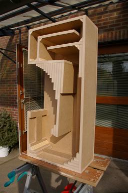

Leonidas, I have the DX3s in a BIB (Scott's dimensions not GMs) and they sound fantastic. I had the same reaction that you did and quickly started searching out more designs. I'm hoping the Sachiko will work well.

No. It was designed specifically for the FE206E. The fact that other drivers should work quite nicely is a case of circumstance rather than design. BLHs are generally more forgiving of driver alterations (within reason) than, say, a regular BR enclosure in this respect, so if the parameters are reasonably close then it should do OK. I tend to deliberately put a little lattitude in my cabinets anyway, because driver parameters change when in use, and are subject to sample variability.
Anyway, looking at both Martin's & Lowther's T/S parameters, the DX3/4 should do OK, at the price of a little less LF grunt than the 206 it was designed for. Sachiko isn't lacking for gain down to 40Hz, so I doubt this will be a real issue. For e.g. this is what the modelled FR looks like with the DX3. SPL at 40Hz still 90db 1w/1m. Excursion's well within limits too. As usual with the three boxes based on this folding scheme, ignore everything over about 250Hz -the software isn't accounting for the midrange / HF attenuation provided by the folding scheme & damping.
Assuming you mean is this the one the DX drivers are naturally suited to without requiring cabinet modifications, yep.

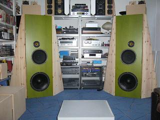

To Gnugear:
Saw your "building-drift" on this forum.
Your work looks fantastic!!
Corner loading is possible for me, after rearranging the room.
Should I wait, until you build the second design, and you can compare the two designs??
Can you please give me the "Scott-dimensions"for the DX3??

I don't mind the difficulty of building, did some horns with fostex before, see pic.

Nobody has DX3s in this cabinet at present AFAIK. Unfortunately, very few people (in relative terms) are in the happy position of being able to afford Lowthers, myself included. That said, see my above remarks about horns & drivers. The HF & midband will be no different, LF will have slight differences over the design driver, but not massive.
