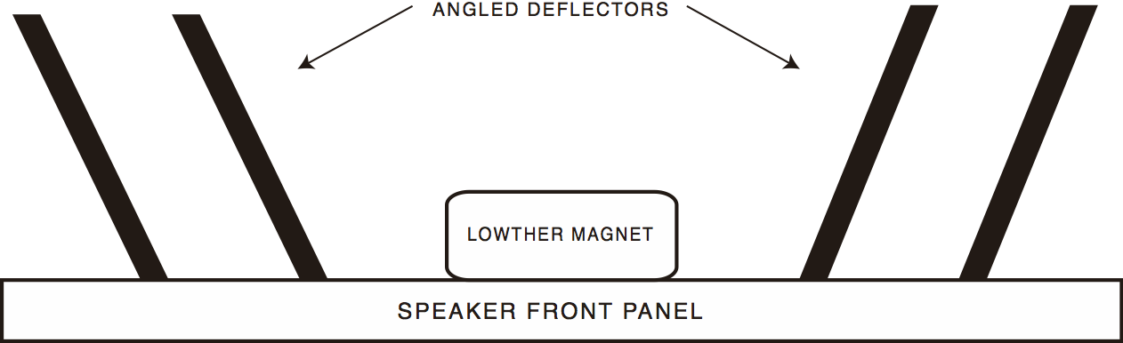

I’d still be concerned about reflections off the back wall of the A150 enclosures- the approx 8” of depth includes front and back panels, so net depth would be only 6.5”, or thereabouts. If you’re willing to seriously modify the enclosures, I’d consider opening up the top section of rear panel so that the Lowthers are running essentially open baffle. I think you’d get much more of the transparency for which the drivers are legend.
You could place some angled deflectors between the front and sides and line with felt . You’d likely still have enough volume in the lower section for a 10 - 12” woofer to provide the required support.
Thanks for this tip. Seriously considering this now and will read up on how to best approach an open baffle Lowther. Will horn loading it (even slightly) in an OB configuration (open back) lessen the effects of the edge and close to rear wall issues (again, a newbie question please bear with me).
When you say angle delfectors do you mean installing something like this in the back:
Again my main problem with being unable to follow the open baffle format would be the close proximity this will have on my rearwall. I can afford maybe around a foot of distance from that wall. If the tweaks above solve that I may go the open baffle route. In my limited understanding, bass attenuation and freq nulls will occur if I place the OB near the rearwall. If the minidsp eq combined with your suggested tweaks ameliorate those concerns….. I think I’ll be persuaded enough to go OPEN BAFFLE and sealed woofer combo!
