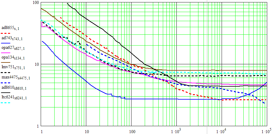

The lowest noise jfet input is the single AD743/5
if lowest possible 1/f corner frequency isn't important then some CMOS parts may be useful
plot from thread http://www.diyaudio.com/forums/solid-state/68793-new-interesting-cmos-op-amps.html

The AD743 has too high input C for my application, otherwise the 2.9 nV/root-Hz is attractive. The high C increases the noise gain of the first stage.
My application isn't audio, it's a transimpedance amplifier that's used to amplify a photo diode. I need ultra-low noise for this application. I attached a schematic to this reply. It has a unique topology in that I use two capacitors to multiply the photodiode AC current by a factor of 30, noise-free. I get a total effective transimpedance of 41 MOhm, but only get noise that's equivalent to a 1.34 MOhm resistor.
Gain peaking occurs around 1 kHz and the Vn starts to become a problem because the noise gain of the op-amps starts to get large. Current noise needs to be low too, so a JFET (or CMOS) op-amp is the only choice.
