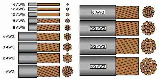

0000 welding cable (.000025 Ohms/ft), readily available in any length. Terminations, either screw on or hammer on are readily available. If you want the hammer on version I recommend going up to 350K circular mil lugs because the multi strand cable is hard to compress to fit into the connector. $16/ft for both conductors together no snake oil just the price of copper.
