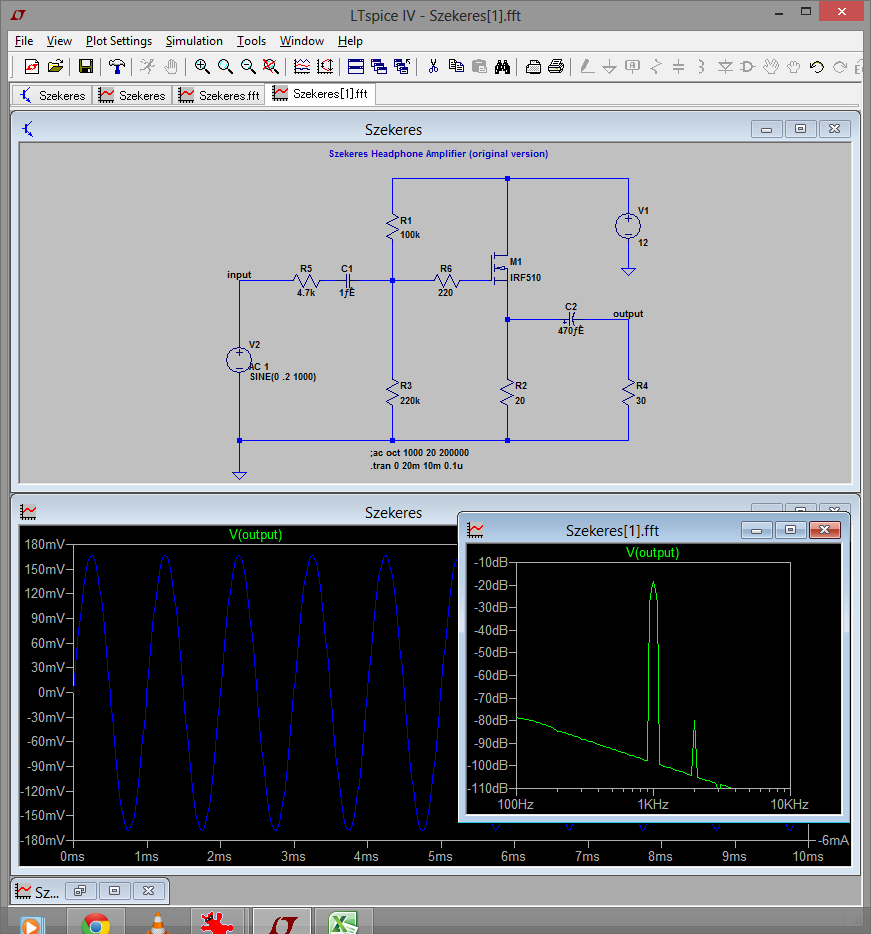

What is the simplest, as in lowest parts count, amplifier using only solid state, discrete amplifying devices that can comfortably power grado headphones? That you would want to listen to of course.
Im asking as a learning exercise.

I'd give the Szekeres a 1-transistor current source though, it tends to help linearity out a lot.
Adequate heatsinking for both the MOSFET and current source transistor is to be provided. (When using one heatsink for both, isolated mounting is required.) Standard bias for a Szekeres tends to be around 150 mA, for a relatively low-impedance headphone (Grados are 32 ohm jobs) I'd consider going higher than that... up to double.
Note that a follower like that should be run from a relatively low source impedance, so I suggest a 10k pot and no higher. The usual suggestions for input DC bias also tend to leave some room for improvement.

Yep, a good plan. A simple CCS using a DN2540 with no source resistor would give ~350mA bias.
Seven resistors, two caps, two transistors and you will have beautiful sounding amp. Not kidding.

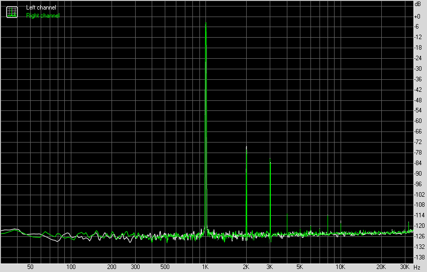

It's a source follower. Ultra low noise floor of -126dB, 94dB dynamic range, flat frequency response from 15Hz to 35kHz. Superb harmonic profile. THD of around 0.015% to 0.06% depending on bias setting.
The one as built with data below uses 2.2uF input cap and 390uF output cap.
Measured FFT at 1kHz for 700mV into 270ohm load:

But, his headphones are 32-ohm. How's the performance into that load?
A simulation with 270R load vs 29R load shows that the THD goes up a bit but with slight change of one resistor (R4) to next value higher gives excellent performance yet still. THD approximately doubled but with same profile of dominant H2 and H3 about -12dB less with not too much else. Some might argue it will sound even better. So the amp design is still within its range of operability with 30ohm cans by adjustment of one resistor.

The simplest single fet version of the Szekeres is very tempting to use as a comparison truth box for anything else I build. Is C1 just to block input DC?

In both the Szekeres and xrk amps, the input capacitor is there since the gate of the input device sits at a positive voltage with respect to ground. So, yes, but probably for the opposite reason you had in mind (i.e. keeping DC from getting to the gate of the input device).
