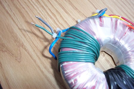

If you wish to lower voltage of your secondaries, here's an easy tip.
Add a winding connected in serie with your secondary.
This way, you can increase or decrease voltage simply by changing the number of winding around your toroid.
Do this twice... once for each of your secondaries
If you want to increase voltage, connect your winding on one the the secondary wire and vice-versa if you wish to lower voltage.
Hope this helps !
Hope this helps !

I tried my gainclone with 2 identical transformers (Plitron 400VA,) the only difference was secondary voltage. First one had 24-0-24V, the other was 18-0-18V, which I acheved by removing secondary windings. The amp connected to lower voltage supply, was clearly producing more bass into same load.
What might be the best way to achieve this be? Wind a wire in the opposite direction of the secondary winding, or actually take wire out? It seems that I get about .5V per turn that I add when adding a loose wire.
I guess it depends if you care or not to permanently lower your voltage by removing some winding on your transformer.
In my case, I prefer to keep the original 30-0-30V secondaries just in case 😱)
It is normal to get around 0.3-0.5V per turn depending on the transformer.
