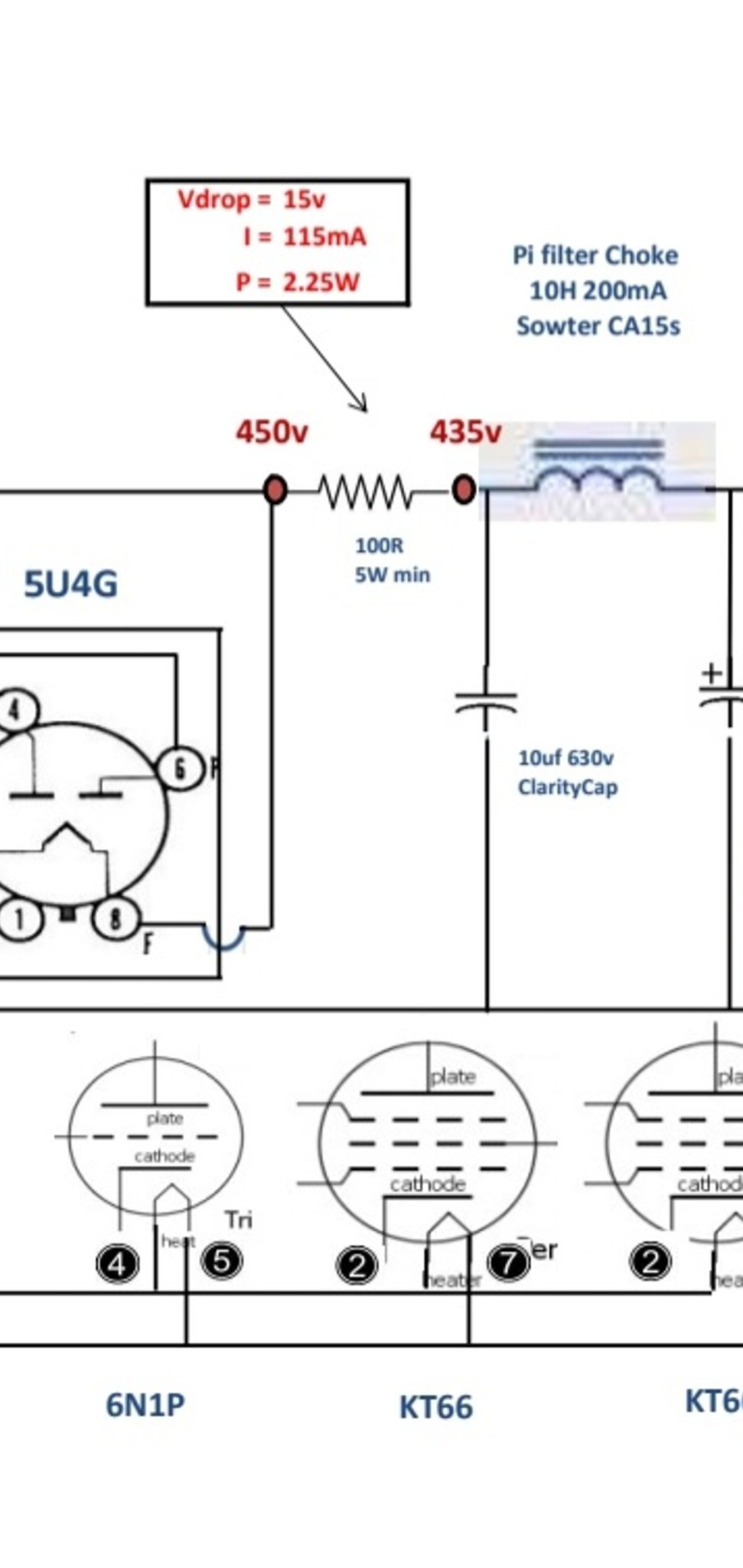

Here's my series dropper resistor circuit when I changed my KT88SE to KT66SE, with a lot of help here at DiyAudio.
The clippet from my schematic shows the impact of the resistor. Although indicated as 5w min, I only had a 100w metal encased resistor, so mounted thst to the chassis. No chance of getting hot like that. The current should read 150mA, not 115mA.
Everything with my amp is over rated/engineered. My unloaded B+ is around 530v so all caps are rated at 600v and 630v in the PS.
