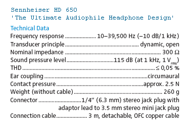

fotenote:
There is new standard for sensitivity, used by e.g. Sennheiser.
SPL at 1 Volt RMS.
See my attachment:
Specifications for Sennheiser HD 650 ( Top of the line expensive HeadPhones)
Nominal impedance ................................................................. 300 Ω
Sound pressure level................................115 dB (at 1 kHz, 1 Vrms)
i didn't even think of noise on a usb power supply!! i will have to check that out.
as for the headphones - well - i want it to be able to run with any type as i may be building a couple for other guys. i seriosly doubt any of them will have top of the range type headphones. for example, the headphones i am building this circuit for are (almost) bottom of the range - the type that has vibration bass (little motors that shake with the bass) and although quality is ok, its not anywhere near the quality of expensive headphones.
