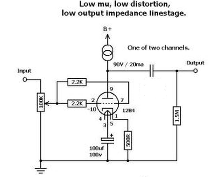

10 Kohms is difficult, but it happens to be the IHF "standard". Fortunately, the plate resistance (RP) of the 12B4 is low enough to deal with that 10 K.
The provided design, with minimal tweaking, should do what the OP wants. Well filtered "150" VDC for the B+ is good enough. Bridge rectifying (perhaps hybrid) the O/P of a Triad N-68X will get that, world wide.
The OP wants some 2nd order HD, for "warmth". So, bypass the 500 Ω cathode bias resistor with a 150 μF. 'lytic. The 100 μF. part shown grounds the heater's CT and is associated with biasing the heater off B+, for noise control. Use a 10M45S as the constant current source (CCS) plate load. In this particular application, a CCS whose performance is not "super/duper" is advantageous.

thanks, 6j1 tube is fine but i am looking for proven design rather than commercial product.
Well, considering that they've sold huge numbers of these I would consider it to be a proven, if not optimal, design.
