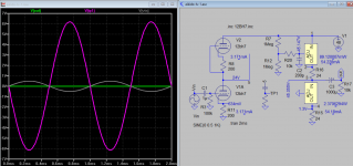

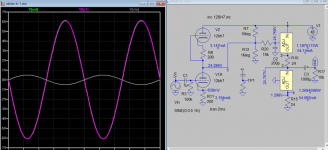

After an 8+ years pause, I've decided to resume my low voltage aikido hpa project based on Mr. Broskie Aikido 24Volts pcb. (I chose 48V B+, 12BH7 route)
However, I have two questions for you guys:
First one: In the manual it is stated
Internal Shields If the triode’s pin 9 attaches to an internal shield, as it does with the 6CG7, 6DJ8, 6GM8/ECC86, and 6H30, then capacitors, C5 and C6 can be replaced with a jumper wire, which will directly ground the shield. However, using capacitors will also ground the shield (in AC terms) and allow using triodes whose pin-9 attaches to the center tap of its heater, such as the 12BH7
Since I'm using 12BH7 valves, I'm guessing I should use capacitor in C5&C6 position right ? However, can someone could explain me why those capacitors have been removed from the part list for the 12BH7 build ? A mistake ? Should I use them or not ?
My other question is about the headphone output. Mr. Broskie is suggesting LM317/LM350/LT1085. Will I run into problems using those parts since they're limited to 30-35V differential ? (I'm using 48v B+) Would LM317HV be more suitable ?
Here's the shematic on which my pcb is based on:
24V Aikido Line Stage and Headphone Amplifier
Thanks a lot for your help

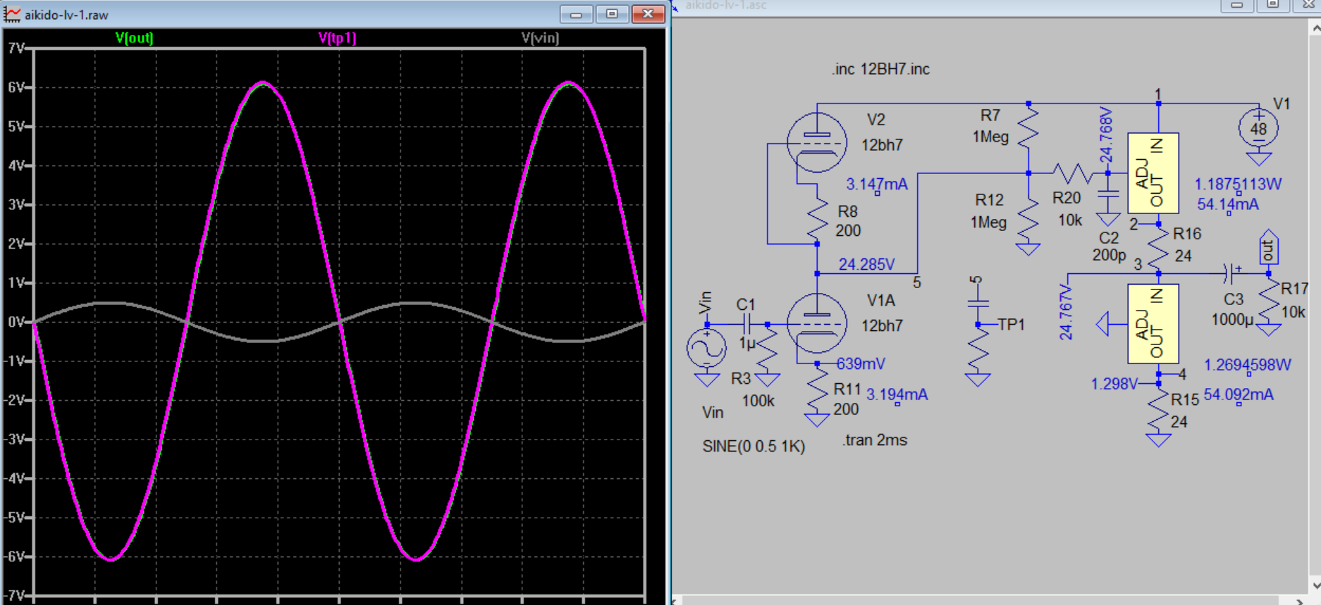

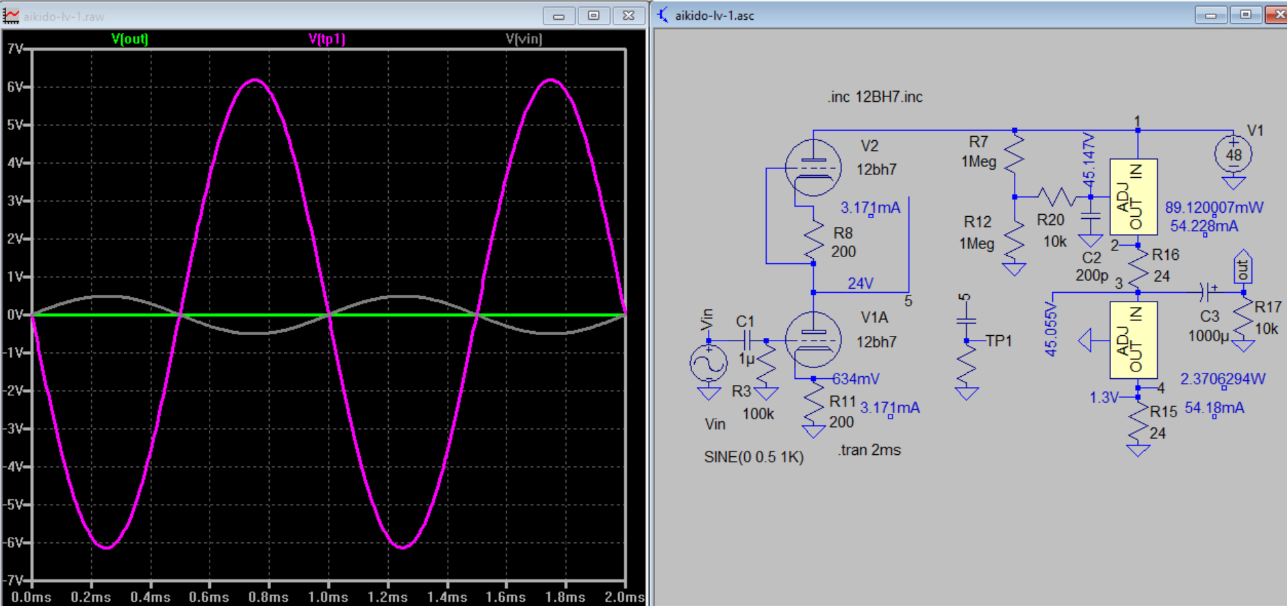

Hi.
I think it's ok to ground pin 9 of 12bh7 if you're using 12.6V (series 2*6.3V) heater, as grounding the CT would reduce hum, however there shouldn't have another ground for heater as this would create a ground loop causing hum.
For the other question, my sim analysis (not full sch) shows that the bias for upper regulator R12 has too low current to make U1 to regulate properly so during cold start, almost entire 48V is applied on top of U2 causing it to exceed the specifications, see attached. After the tubes has warmed up and running it's ok. So you may need to reduce 48V somewhat to 40V or find another way for this problem.
