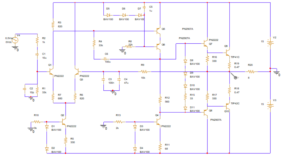

If want to build something discrete from scratch that’s good enough to amplify computer audio, just build one of the countless blameless-style designs. I have one that’s powering my office speakers if you’re interested. Nothing fancy, but more than good enough for computer audio.
